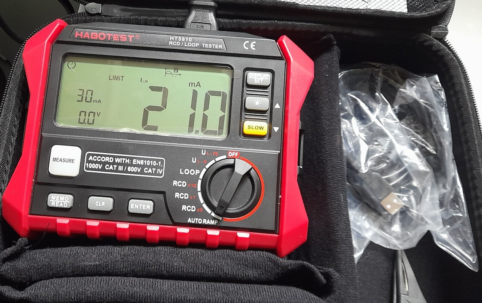

The meters cost around £70 a week to hire, since they need recalibrating after each hire, can't normally hire for less than a week, and the longer hired for, the lower the cost per week. To learn how to inspect and test, I did a course 3 hours per week, for 12 weeks, in fact did 3 courses one after the other, 16th edition as it was then, PAT testing (really called the inspection and testing of in-service electrical equipment) and the C&G 2391 which is inspection and testing of the installation. Back then it was cheap, around £100, now far more expensive, and collages don't want fails, as it affects their rating, so some will only allow electricians on the course.

I got my meters, VC60B.jpgRCD tester ramp.jpgDiffrence line neutral 8 Feb 24 reduced.jpg but the loop impedance tester seems to give wrong results, but the main point is you don't want to finish a circuit, to later find there is something wrong. So you need to test circuit by circuit. Without your own test gear, this is not easy.
