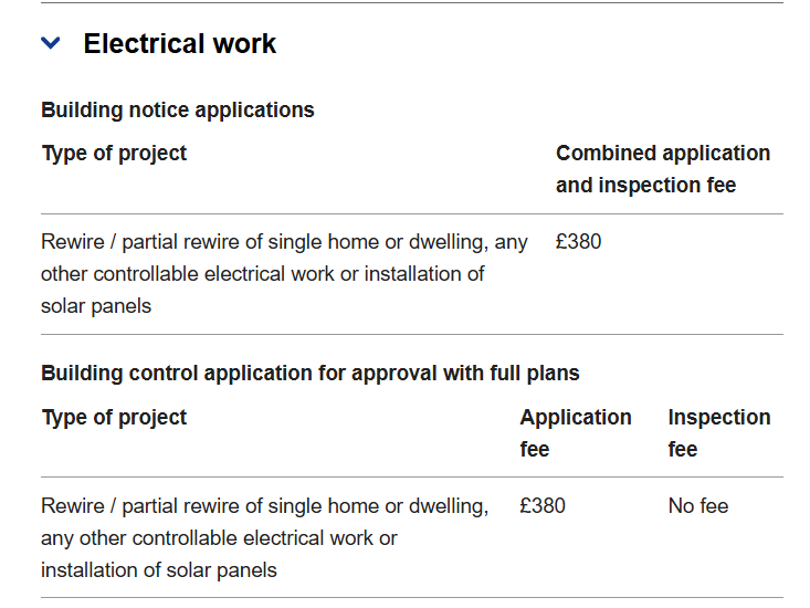

The point to find out is how many times would they want the spark to visit and at what costs
With my LA (Buckinghamshire CC), there seems to be a fixed fee (payable up-front') for Building Notice applications which includes payment for inspection(s) (presumably however many they see fit). However, there is a note somewhere (which I don't think unreasonable) indicating that that there may be an additional charge for any additional inspections required because their 'routine' inspections have revealed something unsatisfactory which has to be remedied and then re-inspected.
