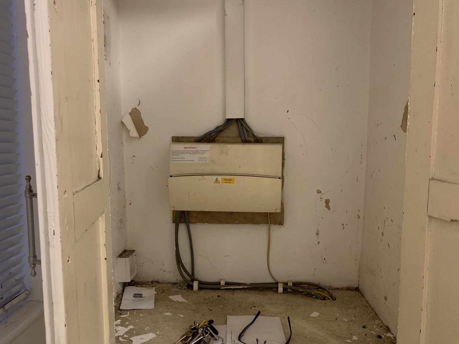

Do I need to cover these cables before the EICR
30 Apr 2008
334
17
Manchester
I’m having an EICR in one of the rentals.
Do I need to cover these cables that are coming out of the CU? It has passed its previous EICR.
I would say do nothing until the EICR is delivered to you
Why do you think they need covering?
I’m having an EICR in one of the rentals. Do I need to cover these cables that are coming out of the CU? It has passed its previous EICR.
Lack of covering, per se, is not an issue. However, there could be something said about the 'vulnerability to mechanical damage# (e..g. people kicking them etc.!) of those cables down on the floor. 'Covering' them would be one solution to that, but merely 're-routing (away from the floor) would probably be adequate.
Kind Regards, John
The CU is inside a cabinet that is not very much used. I think what the previous electrician did was to fill the space with silicone of the cables entering the plastic CU compartment.
Yes - cables should have protection from mechanical damage risk - virtually nobody seems to bother about meter tails though!
The sheath is the mechanical protection.
Even a cable with a sheath (which all touchable cables are required to have) is still required to be installed in such a manner as to minimise the risk of mechanical damage (despite the sheath). Otherwise, a plastic-sheathed cable (without any other protection) lying on the surface of a flower bed would be acceptable.
The cables do not look well supported, so may not conform to reg 522.8.5.
There's even a Note attached to the reg saying it includes meter tails
I`m not sure I totally agree there.
Indeed the sheath is part of the cable giving mechanical protection therefore inherent.
However the cable itself (including its sheath) should also be protected where appropriate.
Therefore two items of mechanical protection are usually required, one inherent and one external.

I suspect that the person doing an EICR will find more so probably best to leave it to see what is found before trying to fix (hide) it.
I would think that ,in this case, 'hiding ' would really amount to 'fixing', since, as far as I can see/think, the only thing really wrong with those tails is their potential susceptibility to 'mechanical damage' (which risk would probably be dramatically reduced by whatever was 'hiding' them).
