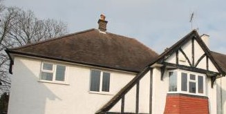

Not sure if this was a roofing or general building question but here goes. I need to redo my old timber fascia boards and want to know if they can be removed and replaced with UPVC or if they add structural strength then should they just be over clad. I want a maintenance free option so just making good a decorating the existing is not an issue even though they are in reasonable condition.

Its not structural, the fascia is to close off the rafter tails and hold the gutter brackets if required.

Not especially, but it does hold up the bottom course of tiles.
I am after the best possible job so will go with a rip off and replace,
You will need to remove the bottom course of tiles. It may be wise to remove more, whilst you are at it and renew the felt if rotten and deal with the eaves drip.
Ideally the right way would be the last three 3 course of tile then you know exactly what your dealing with to complete a proper job.

Not the best photo but all i have on me
