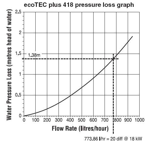

Looking through the Vaillant manual, the ecoTEC 418 requires a min flow rate of 12.9 litres per minute (or 0.77 m3/h). The water pressure loss (metres head of water) is 1.38m at 773.86 litres per hour (0.77 m3/h) (see pic).

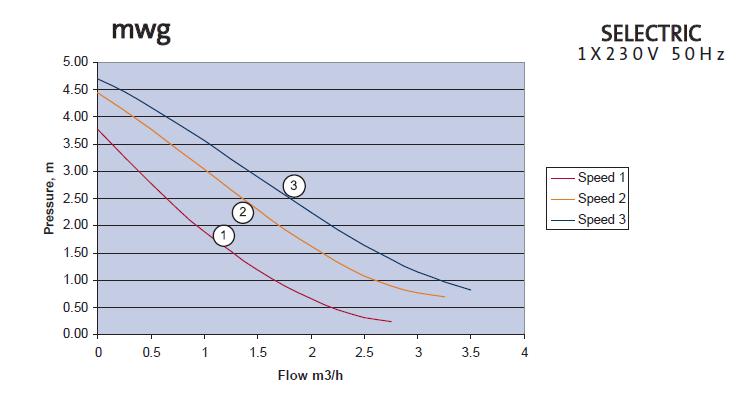

I have around 4m head between the F&E and boiler, the pump sits roughly in the middle @ 2m. Looking at the Grundfos specs (see pic), if I use the lowest figure (2m), the pump delivers the following flow rates:
Speed I = 0.9 m3/h
Speed II = 1.6 m3/h
Speed III = 2.1 m3/h
As the boiler requires 0.77 m3/h, Speed I looks to be a bit of a push but II & III both look to give acceptable flow!?

The Grundfos Installation Instructions can be found here as quoted from above to give flow rates. In there it says
"The best speed setting is the lowest setting which gives adequate circulation around the system with the correct flow/return differential temperatures, as specified by the boiler manufacturer. Uneven heat distribution may indicate that balancing of the flow is required to each radiator."

Given that the 415 has a lower design flow than the 418, if the 418 requires 12.9 l/min at 18 kW, can it be throttled back to 8.6 l/min at d.0 setting of 12 kW? Otherwise the temperature rise won't exceed 13 °C.

Looking at the 415 figures, it's max output is 15.3 kW and a min flow rate of 10.8 L/min. The designed 20C drop at 12kW is with a flow rate of 646 L/hr. As the 415 and 418 are so similar, I agree that if the 418 is rated (via d.0) to 12kW I would need a flow rate of 646L/h or 0.65 m3/h.
I've now measured the vertical drop between boiler and pump which is 2.4m. If I look at the Grundfos specs, a 2.4m head gives the following flow rates to the boiler:
Speed I = 0.75 m3/h
Speed II = 1.5 m3/h
Speed III = 2 m3/h
Does this mean the best setting to acheive the biggest drop at the boiler would be Speed I, giving 0.75m3/h or 12.5 L/min flow @ 12kW?
12.5 is slightly lower than the 12.9 minimum flow of water listed in the Vaillant manual, however, would that 12.9L/min be for it's 18.9kW output?
@ajrobb - How do I calculate the maximum tempature rise from those figures? I'm not sure how you calculated the 8.6 l/min or the 13C rise?
