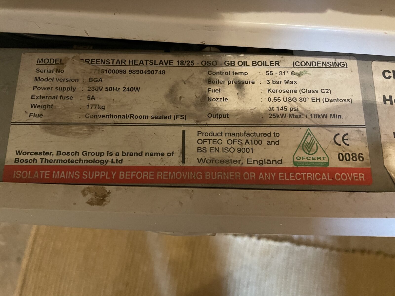

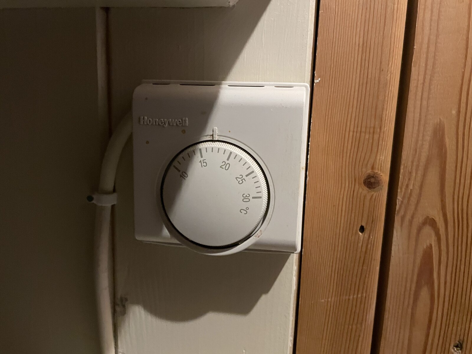

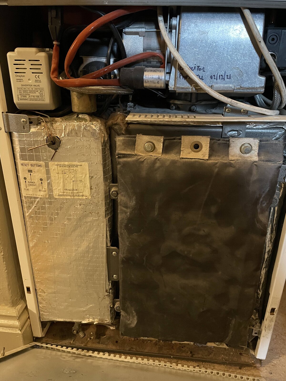

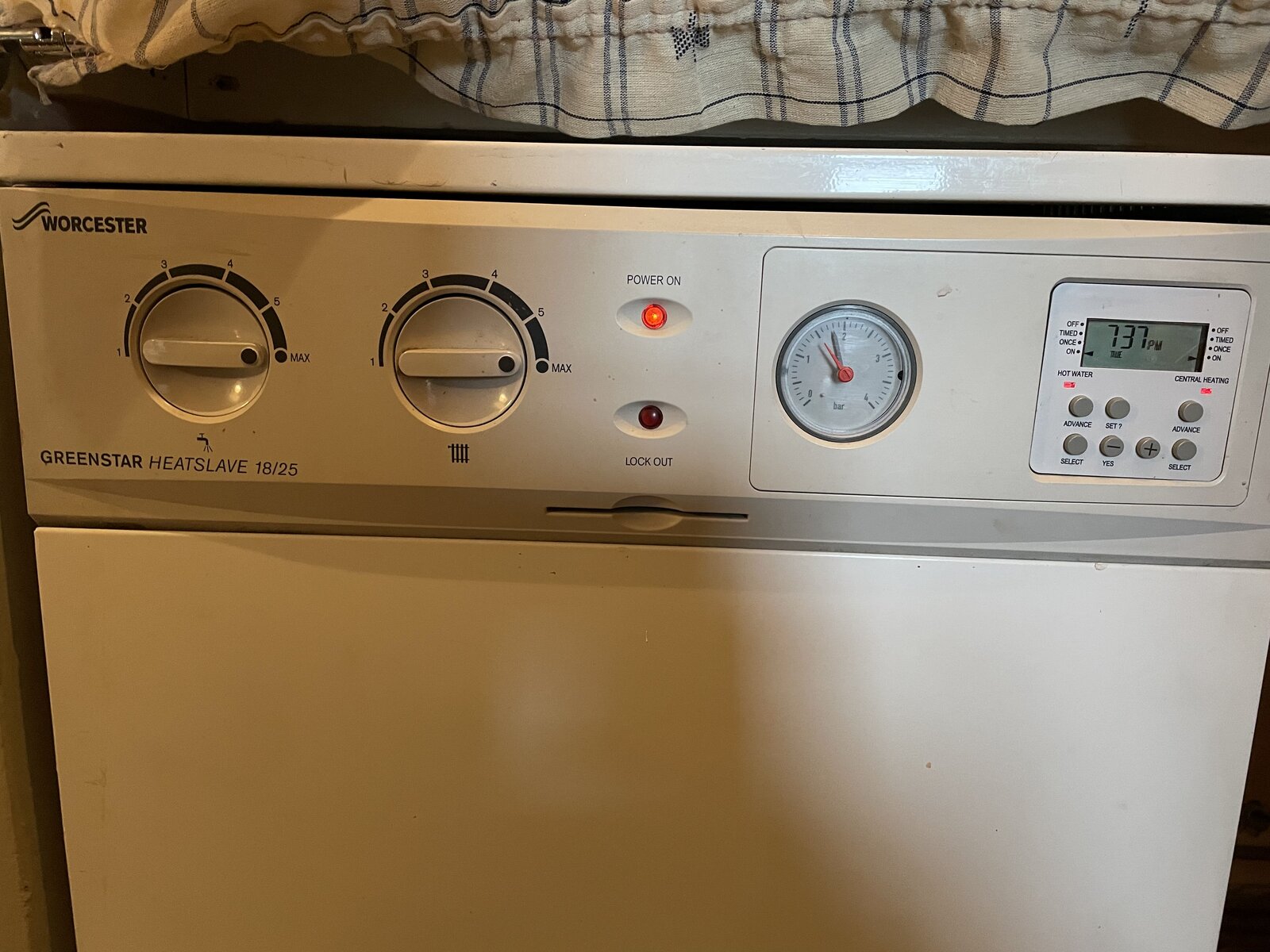

Hi all,
I am looking to get a Hive thermostat installed but wasn't sure if it was compatible with our oil boiler as I recently found out the Google nest wasn't.
Any help and advice would be massively appreciated!

Hive, Nest and others are just an on/off switch, or two switches for those that do HW and CH.
Compatible with almost all boilers.
Hive is really designed for gas boilers, even though it can be a installed on oil boilers the TPI functionality isn’t configurable for oil boilers. Best to check with Hive.
