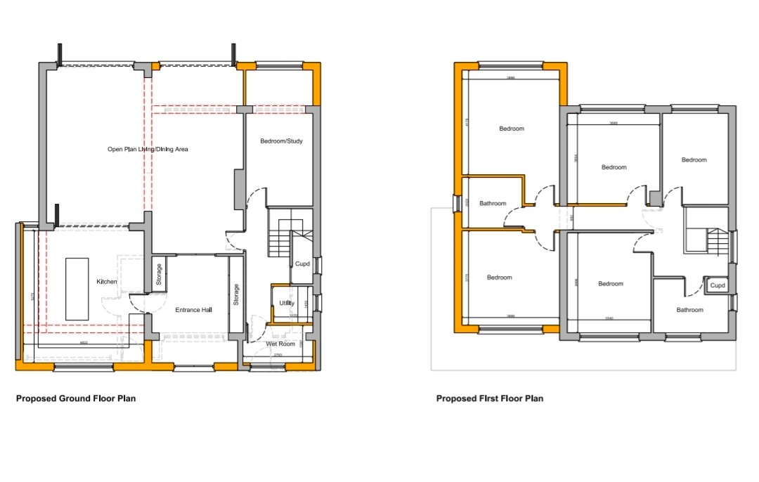

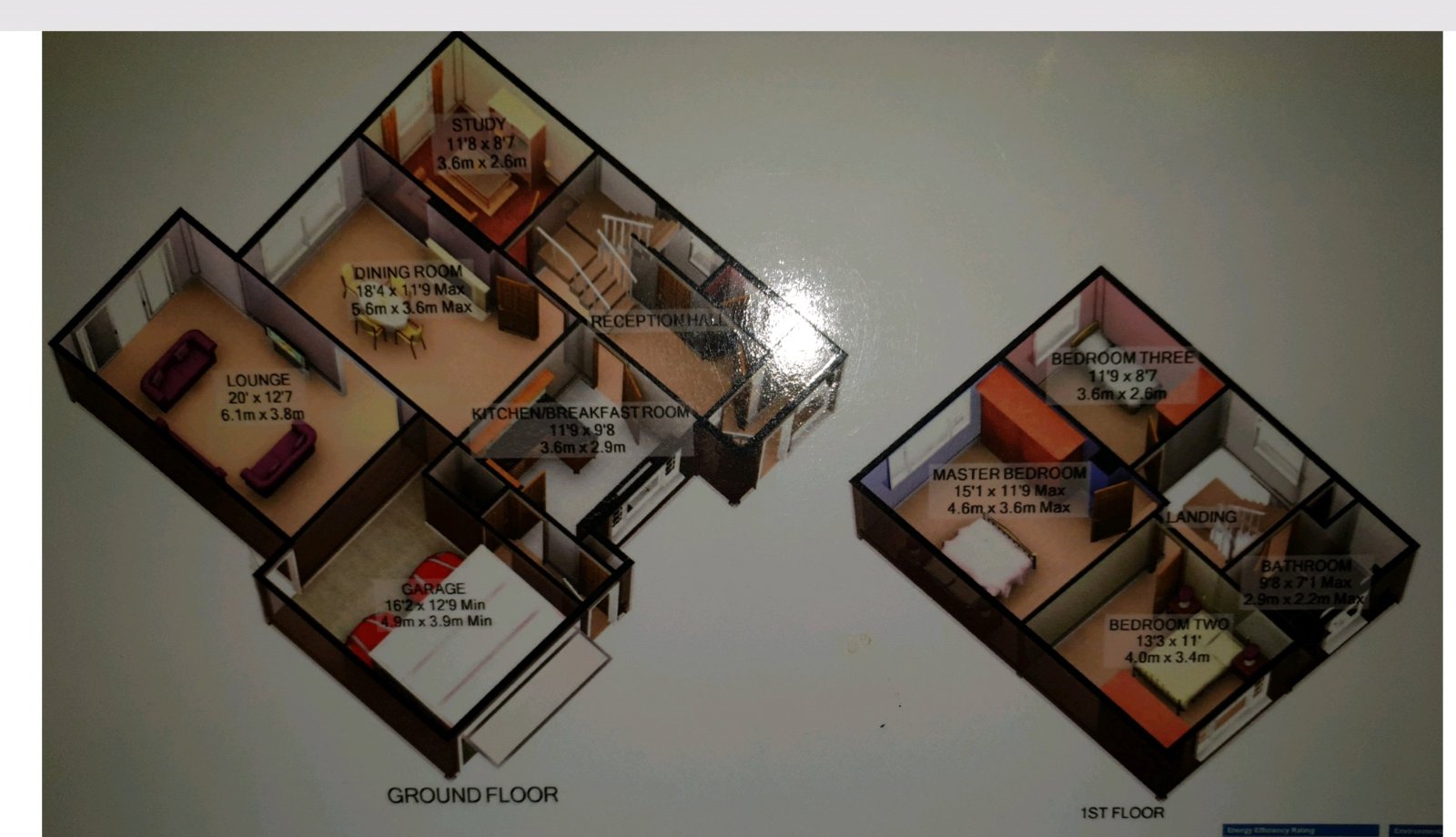

Hi all,
I am West Midlands based. Builder recommended by 2 work colleagues. Mortgage free house.
Project - 50m2 extension. Kitchen fitting extra £2k and bathroom fitting included. I need to supply kitchen and bathroom suites.
