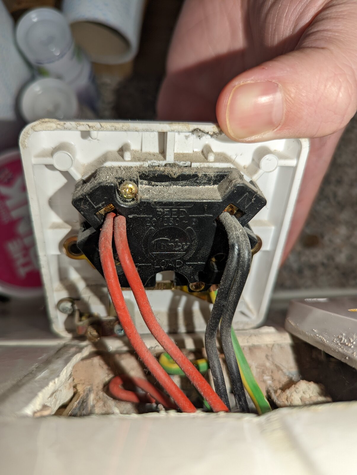

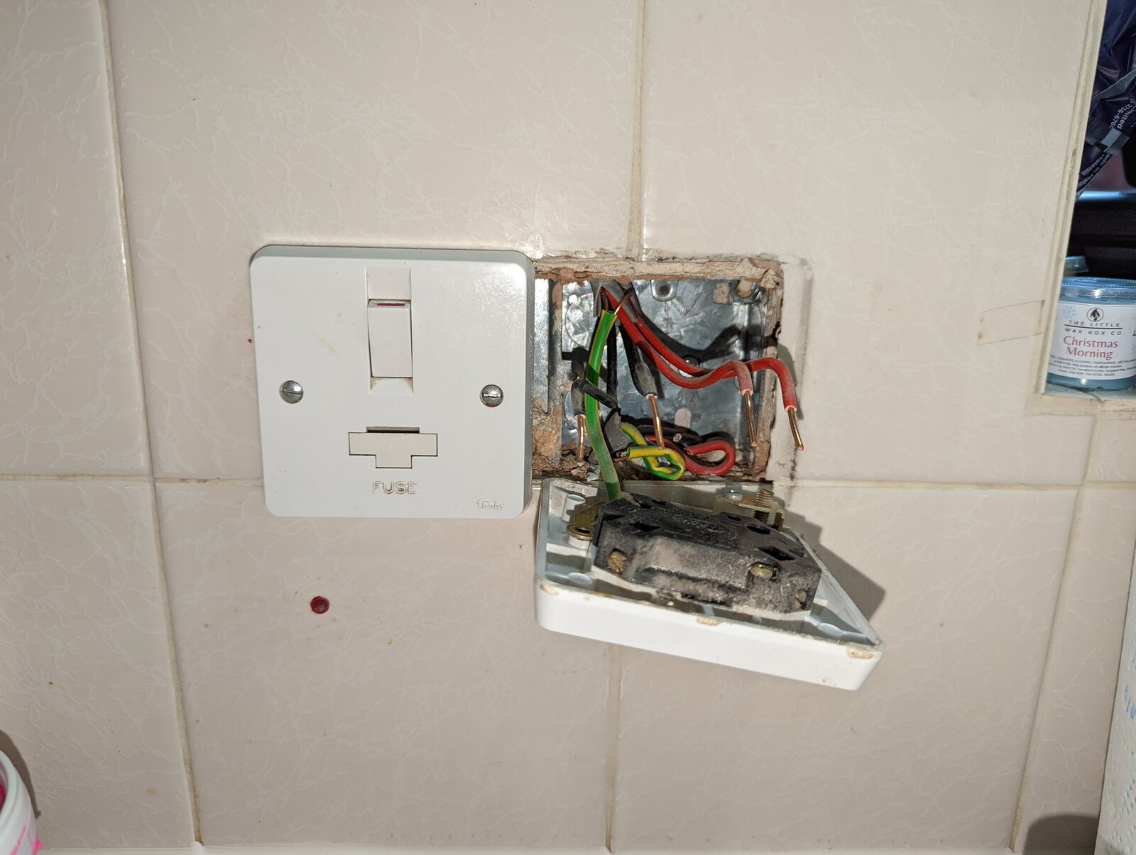

Afternoon all,
Hopefully a relatively easy one for those in the know.
Recently moved into a new house and have set about installing the dishwasher and washing machine. So the washing machine and (new) dishwasher have never been properly plugged in. No idea why or what they did, but I can only assume that they ran an extension lead every time needed to use the washing machine...
There was a blanking plate behind the washing machine so took it off and there's a power lead behind it.
I bought a double plug and fitted it (had to extend it from a single to double) and... No power.
I'm assuming that it comes from one of the switches about the counter. Just a single switch. No label. The switch next to it, is fused and turns off the boiler.
I took it off and tested it with my multimeter and it has power.
However, it has two 'feeds' which I have no idea why. There is a group of cables underneath which weren't connected to the 'load'. I'm assuming that these disconnected wires go down to the plug I've fitted underneath.
I can't really figure out why there would be two lines going into the feed. Is this safe? Should I just keep one set in or both?
Any advice would be appreciated!
Cheers,
Matt

is it part of the ring main circuit - that would have 2 cables into Mains IN / Supply , I have seen a fused switch on rings in a few houses
I believe it is yes. Only been in the house a few days so not 100% with it all.
Just measured both with my multimeter and they're both powered so I'm assuming it's part of the ring.

Also, might be an idea to replace the switched fused connection unit for a 20amp double pole switch.
And, may be worth checking the cable that was disconnected isn't damaged first - as seems a bit odd it was disconnected.

It was just a standard own-brand Wickes one I picked up yesterday but you are completely right, I will grab a better quality one if only for piece of mind and I'll replace the fused connection unit as well to be sure.
As far as I could tell the cable was fine. I'd hazard a guess that it hadn't been used previously. The previous owners had been here since it was new ('98 build.) I've just finished removing a picture rail in the living room stuck on with copious amounts of double sided tape among other things... So they don't strike me as the type to go to the effort of taking off a socket and blanking it. But who knows?
