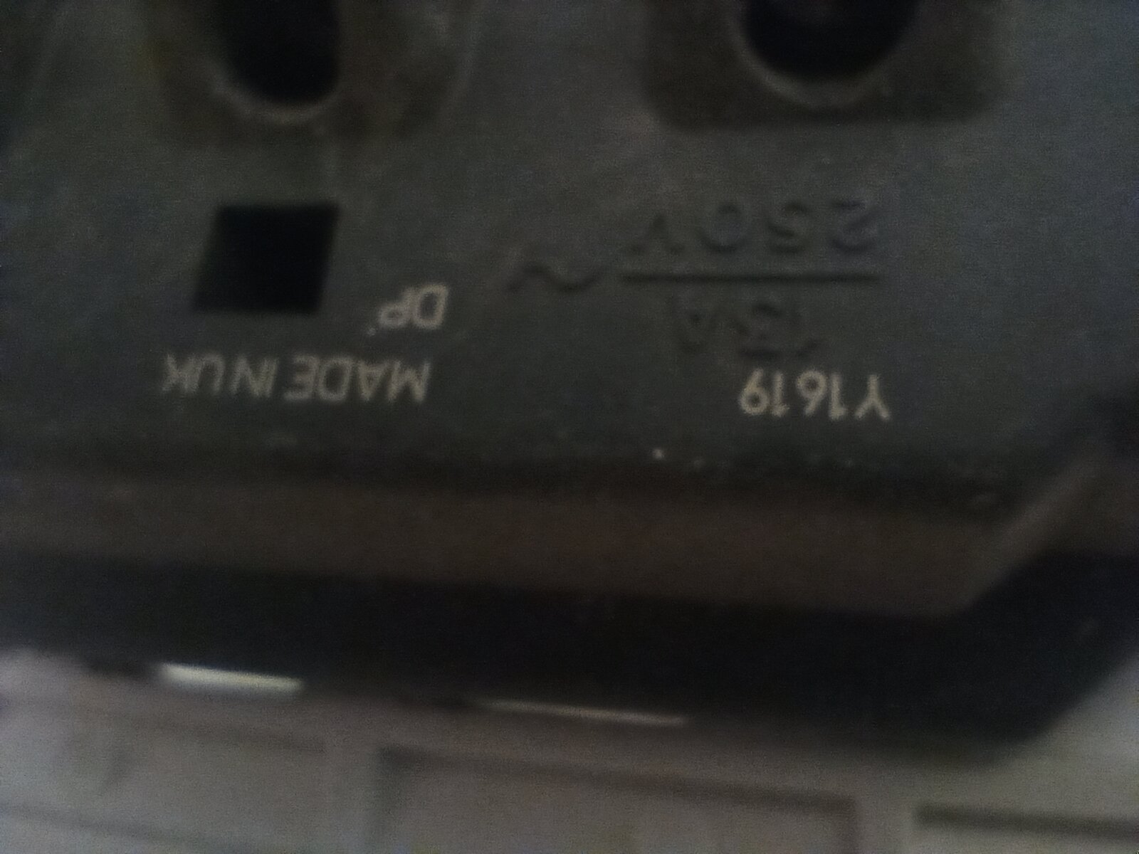

I'm sure there will be someone here who uses MK regularly and can tell us what's written on the back.
Just googled one. 13amp.
Thanks. I can't find any MK ones here, but have a selection of other makes, and absolutely every one I've got has got "13A" embossed on the back.
Since I doubt that any of us believe that the 'total rated load' of a double socket is only 13A, one can but presume that all the manufacturers mean "13A per outlet" (i.e. 2 x 13A per double socket), don't you think?

Apologies for the awful macro settings, but I just went upstairs and whipped one off, as the actress said to the bishop...
is that an issue? - I read that in a similar manner to a capacitor, as it being its max tested value of: 13A @ 250V
Would be less suitable if said 13A @ 220V and you used it on Isel of Man with its often 245V
But this gives rise to another issue. 250V?
is that an issue? - I read that in a similar manner to a capacitor, as it being its max tested value of: 13A @ 250V ... Would be less suitable if said 13A @ 220V and you used it on Isel of Man with its often 245V
Quite so.

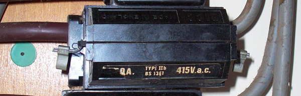

It's surely obvious that when something (e.g. plug, socket, switch, cable, enclosure etc.) other than 'current using equipment' has a 'voltage rating', this refers to the maximum safe voltage it can be used with, such that it can be used at any voltage less that that maximum? Only f it is 'current using equipment' is there any problem with using a voltage less than the 'voltage rating' - and, even then, it would virtually never be a safety issue (e.g. trying to use a 230V lamp/bulb at 12V !).
My installation's DNO ('cutout') fuseholders are marked "415V" - do you really think that makes them unsuitable/unsafe at 230V?
Kind Regards, John
