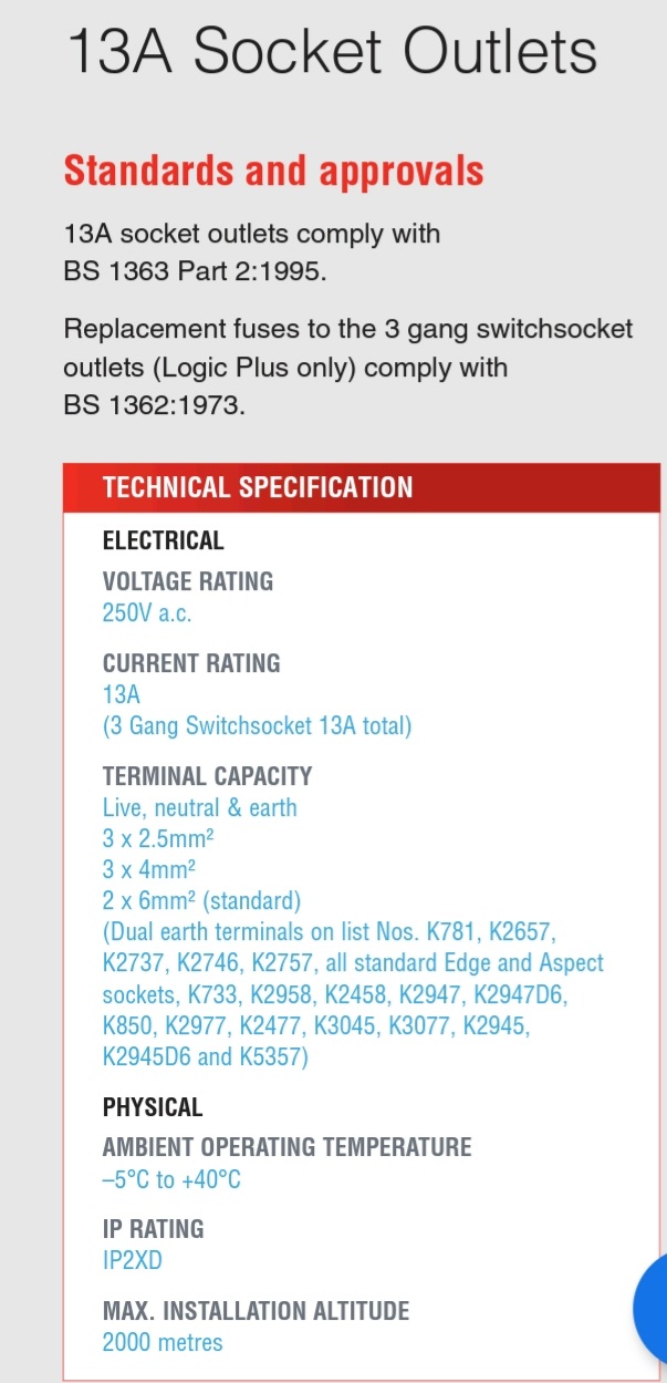

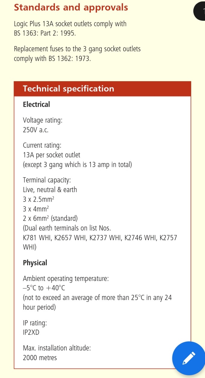

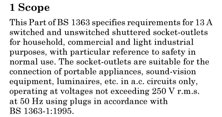

So the socket is no good at 253V?
Yes, it certainly would seem to imply that. However, see my post #11 above - it seems that even the MK Technical folk were not totally sure what "..per socket outlet" means, since that was apparently written by the Marketing Dept., not them!... '13A per socket outlet (except 3 gang which is 13 amp in total)". Certainly 'implies' 26A!![]()

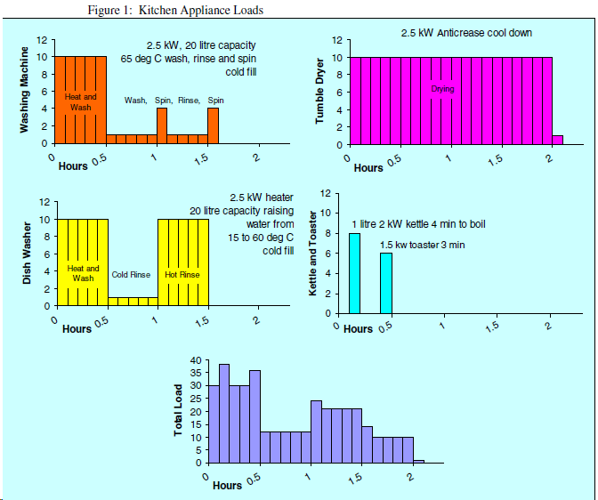

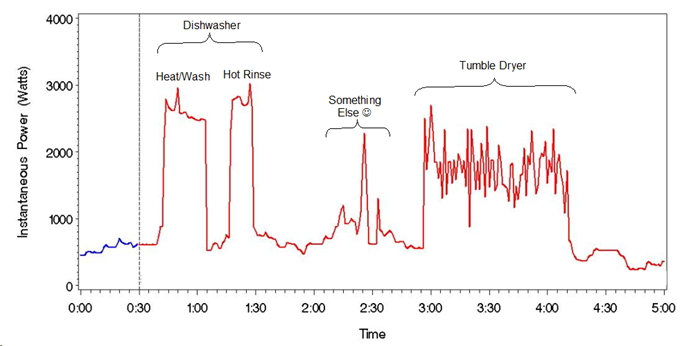

indeed once a washing machine is past the heating cycle it is sub 4amps and suspect a dish washer will be similar it seems like 2000w or less now seem to be what driers and washing machines are so a 13amp double [rated 20 amp] would be unlikely to give problems or concernNeither a washing machine nor a dishwasher draw high currents for appreciable periods of time. I think it's when one of the appliances is a dryer (which can draw high current more-or-less continuously) that some people experience (socket) over-heating problems.
Quite so.indeed once a washing machine is past the heating cycle it is sub 4amps and suspect a dish washer will be similar it seems like 2000w or less now seem to be what driers and washing machines are so a 13amp double [rated 20 amp] would be unlikely to give problems or concern
Quite so.
The below (from 'Wiring Matters' Spring 2002), which we have looked at before, gives a rough idea of the electricity demands within a kitchen, and shows that even if Washing Machine, Dishwasher and Tumble dryer are switched on simultaneously (and kettle and toaster also briefly), after the first 30- minutes the total current draw is never appreciably above 20A..

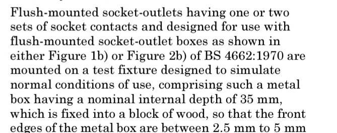

Yes, I can't criticise you from drawing that conclusion from what you have quoted, and ....Having just read through BS1363-2 (), I have come to the conclusion that a double socket is in fact a single flush socket outlet, with two sets of socket contacts:

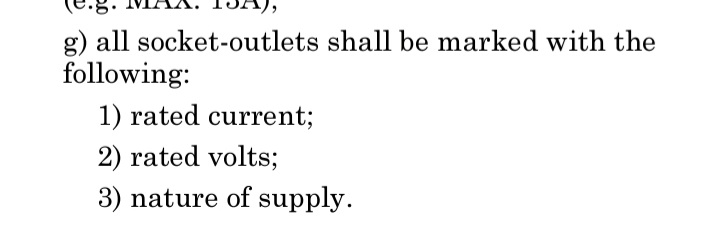

... and, again, I cannot argue with your logic of the conclusion you have drawn, BUT I don't think that any of us believe that such is what the "13A" marking on the back of double sockets is meant to mean...... And as 'ALL' socket-outlets should be marked with the rated current, .... Then a socket-outlet with two sets of socket contacts marked with a single 13A symbol can only be rated at a total load of 13A from both sockets!...

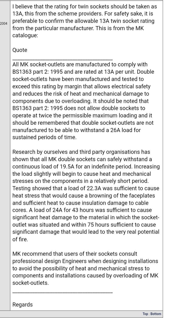

Interesting quote from a certain other forum here... for a start, it would make no sense for a manufacturer to 'rate' (and therefore 'mark') a double socket as having a current-carrying-limit of 13A total, when the Standard required that the product had, at a minimum, passed a test at 20A total.
I'm not sure what you think you might be wrong about. I certainly agree with your conclusion (agreement with me!) that a WM+Dryer would not usually result in >20A total for appreciable periods of time (more than, say,309 mins).ok maybe i am wrong ??
Are you talking about the 'Hot Rinse' of a dishwasher. If so, then, yes, it definitely happens, and it is primarily by getting the contents very hot that they are dried. Have you never opened a dishwasher just after a cycle has finished? If you have, you will have been confronted by great clouds of steam (which instantly fog up my glasses if I'm wearing them at the timeyou graph shows a warm rinse ?? ... does this happen ?? ... thought it was cold after the initial heat but off course i am -----still learning![]()
I'm sure they vary, but my tumble dryer seems to run at roughly full heating pelt almost continuously.... also it shows a constant 2kw plus that simply doesnt happen for 2 hours as the the heating cuts in and out more so as the washing dries indeed drying a load in my tumble cost about 1.8 units over a 2hr cycle as it cut in and out rather than the infered 5kw in your chart ...
That's the quote from the IET forum, around 12 years ago, which I presented in post #11 above.Interesting quote from a certain other forum here![]()
As it says, it apparently came from some MK catalogue, but no-one has been able to find the source, and the MK tchies I talked to about this had a few years back claimed to have no knowledge of it, or what it said!
