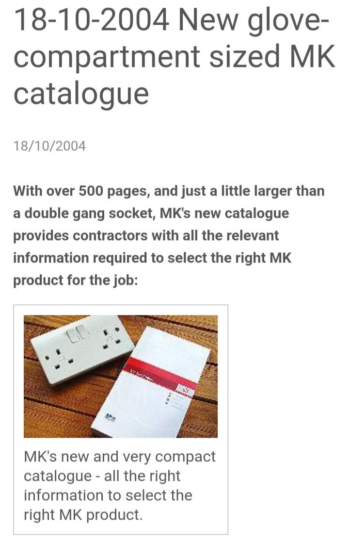

The earliest reference I can find for the MK information, actually comes from this forum in 2004!
It doesn't seem as if the original post is available here, but there was a contemporary link :)
https://community.screwfix.com/threads/new-supply-for-building-site.25376/

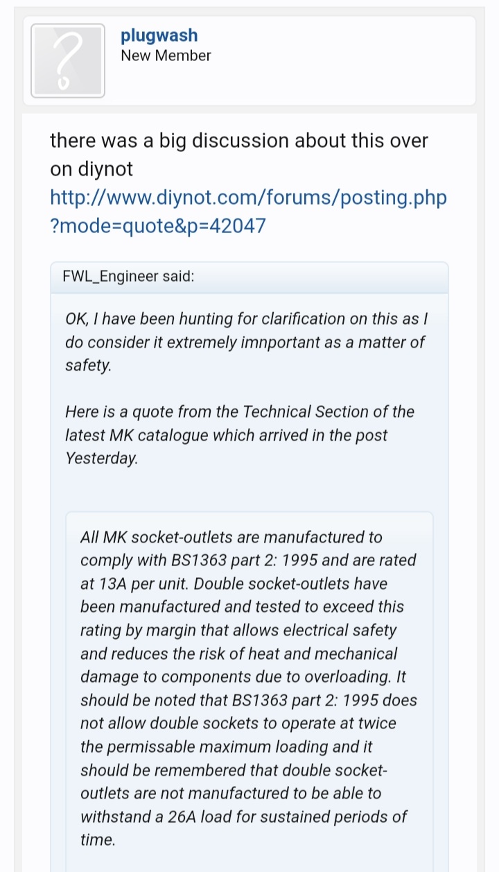

So all we are looking for is the 2004 MK catalogue! It looks something like:
Interesting! ... The earliest reference I can find for the MK information, actually comes from this forum in 2004! It doesn't seem as if the original post is available here, but there was a contemporary link :)
I think you'll find that the DIYnot discussioin referred to was probably this one...
https://www.diynot.com/diy/threads/absolute-amateur-wants-to-know-if-im-overloading.8520/#post-41948
So all we are looking for is the 2004 MK catalogue! It looks something like:...
I'll leave you to address that "all". However, I'm not sure that the effort would be justified, since I think there is probably enough circumstantial evidence to satisfy ourselves that what we are seeing almost certainly did originate from an MK catalogue.
Having said that, the text you quote here (from the Screwfix forum) differs from what we have previously been looking at (that which talked about 19.5A, 22.3A etc). In what you now quote, this bit ...
... again seems to perpetuate the apparently common misunderstanding about Standards to which I keep referring. What BS1363-2:1995 "does not allow" is a double socket which cannot pass a temperature rise test involving 20A (14A+6A) for one hour (the 'minimum required standard'). Nothing in the Standard says that one cannot manufacture (and appropriately 'spec'/'rate') a socket that can "withstand 26A load for sustained periods of time" - and, as I keep saying, it's far from impossible that at least some of the double sockets around do come into that category.
Kind Regards, John
