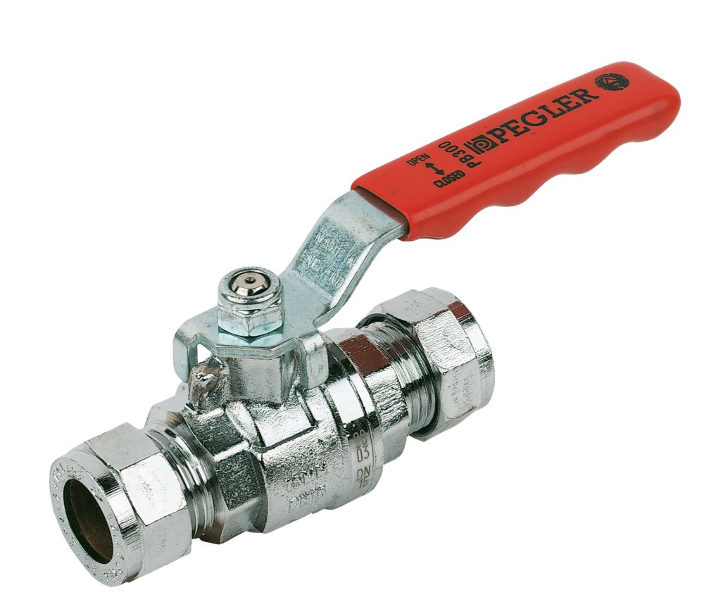

Just wondering: these will go on the lowest point of my central heating system next time I drain it.
Would you use full bore service valves (or other kind of valve?) instead with a short piece of copper pipe where to connect a hose when draining?
If not, why not?

As for full bore, you can buy a different type of valve, not a drain cock. Read the spec to ensure it will withstand high temperatures. I got a Pegler one with a hose nozzle on the outlet. Something like this apart from the nozzle.

Is a drain cock in some way "better" than other types of valve? They seem rather a nuisance to me.
1. They have the spigot for the hose pipe already built in.
2. They are tamper resistant in comparison with other types of valve.
Or fit a lever valve, remove the handle and cable tie it to the valve, also you can fit a compression cap on the end of the valve.
