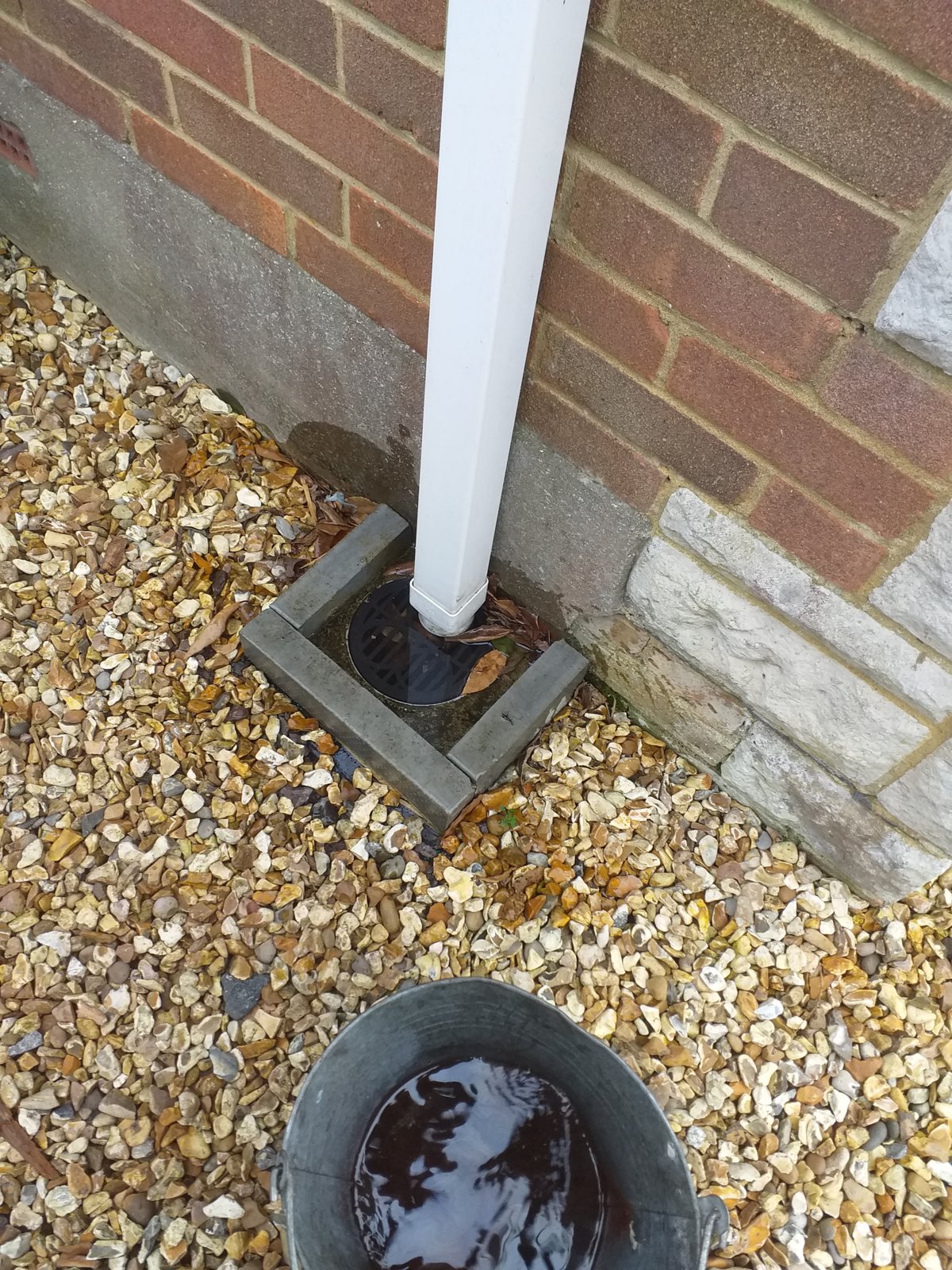

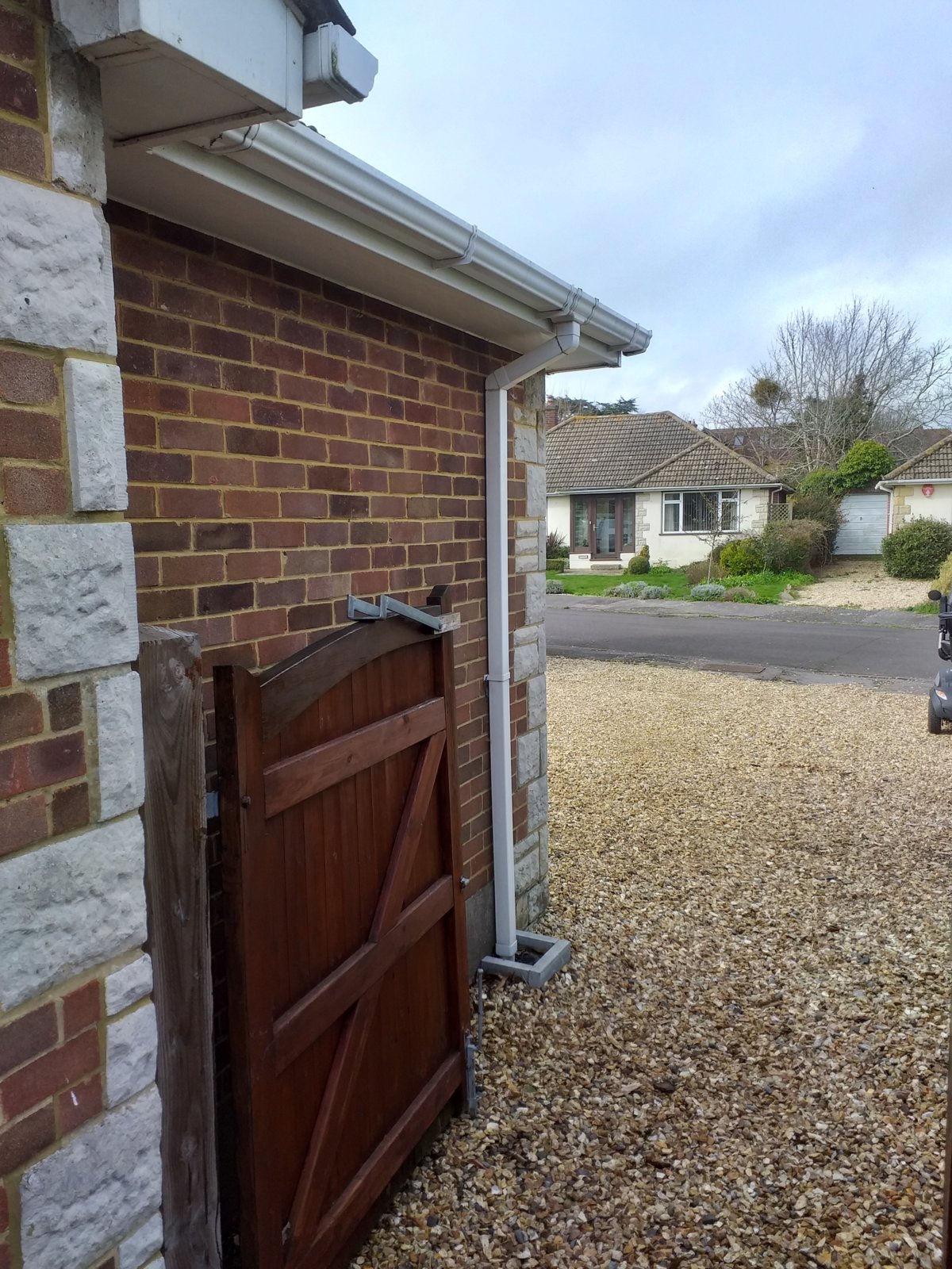

This drain is full of water. How do I unblock it? Wet/dry vac?

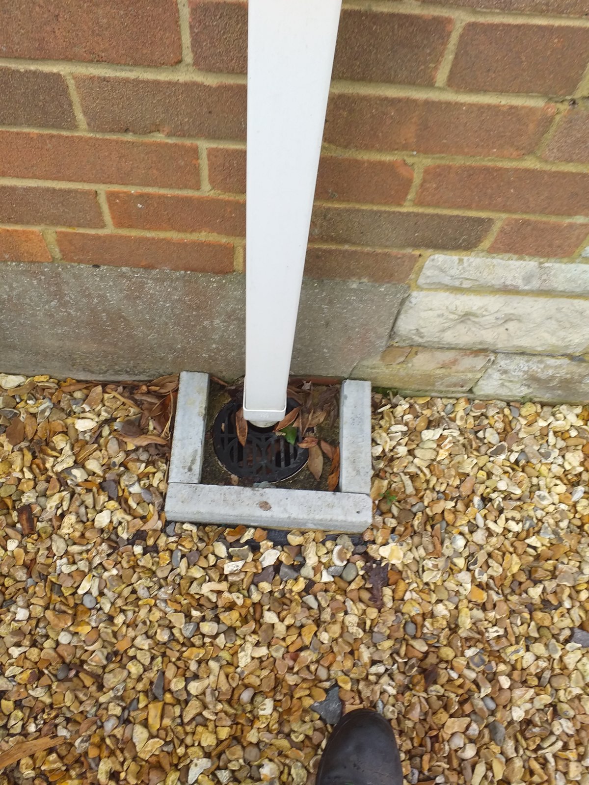

Do these photos make it any clearer if it goes to a soak away

The water from the bathroom and kitchen at my house go into the sewer, but the water from the gutters goes into the soakaway at the front of the house under the drive so it is a possibility.

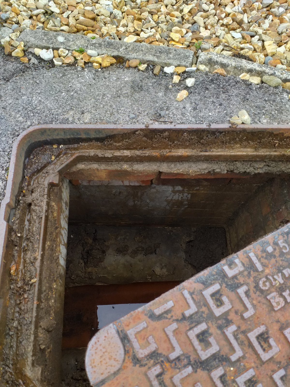

Or open a manhole down stream and chuck a bucket of water down the drain. You should see a surge a few seconds later. It looks like there may be a manhole at the end of the drive? If so it's a quick and easy test.

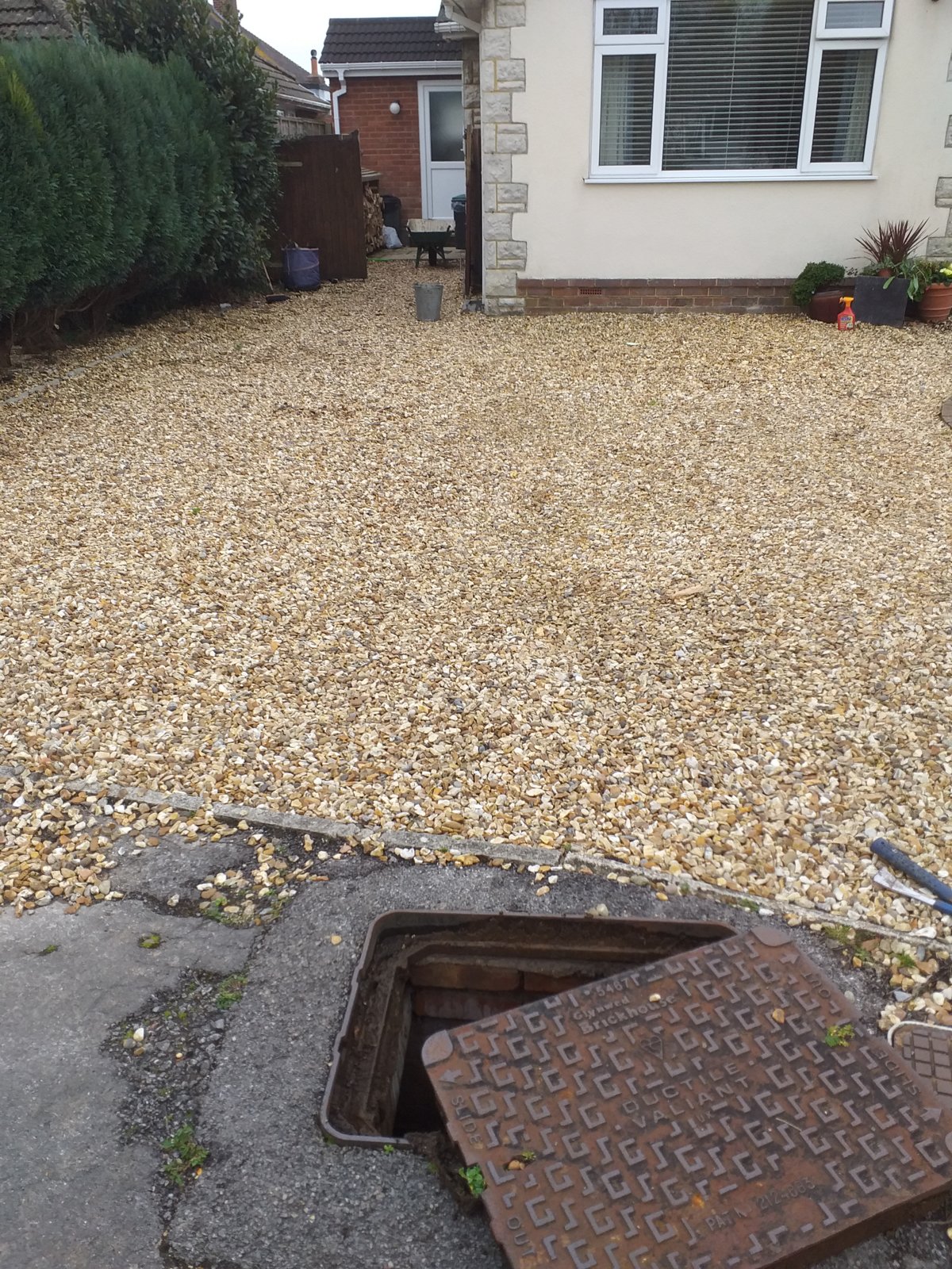

Opened manhole and poured water down drain below downpipe. The water level dropped incredibly slowly if at all. Saw no water go
into manhole. These no pipe either running into manhole from direction of drain either
its curious, your manhole shows the drainage running at right angles to the driveway - typically, the manhole benching drain would be accepting drainage directly or through an inlet on the m/h side wall - you dont have an inlet.
i'm wondering if your gullies are tied into the street gullies drainage?
walk down the street and look down any kerb gullies - look for blockages.
i cant see your soil pipe but is there another manhole accepting soil water from a soil pipe?

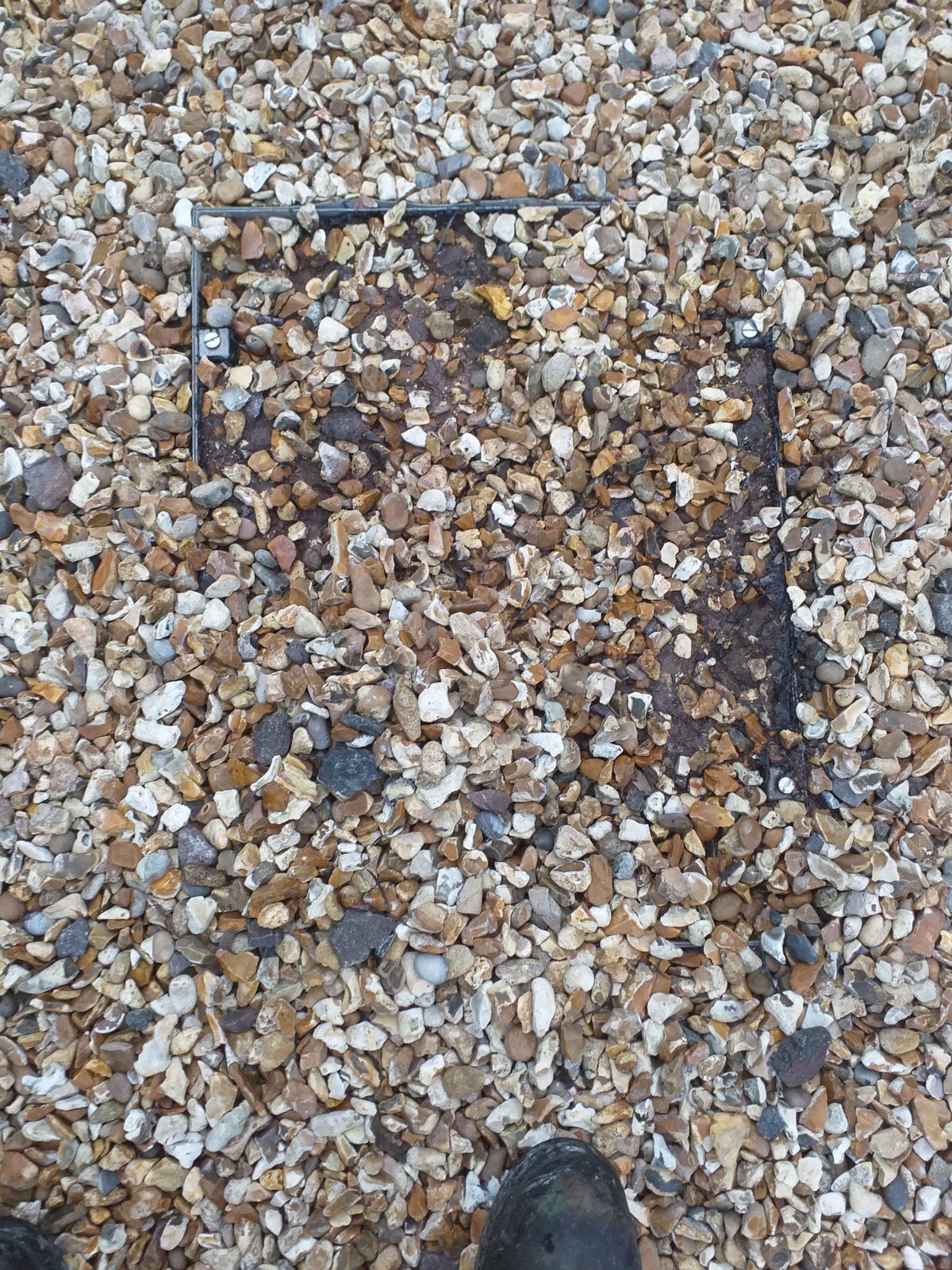

you could remove the gulley grids (the waste gulley grid needs replacing) and, using gloves or gauntlets, reach into the gullies and clear any debris from their traps.

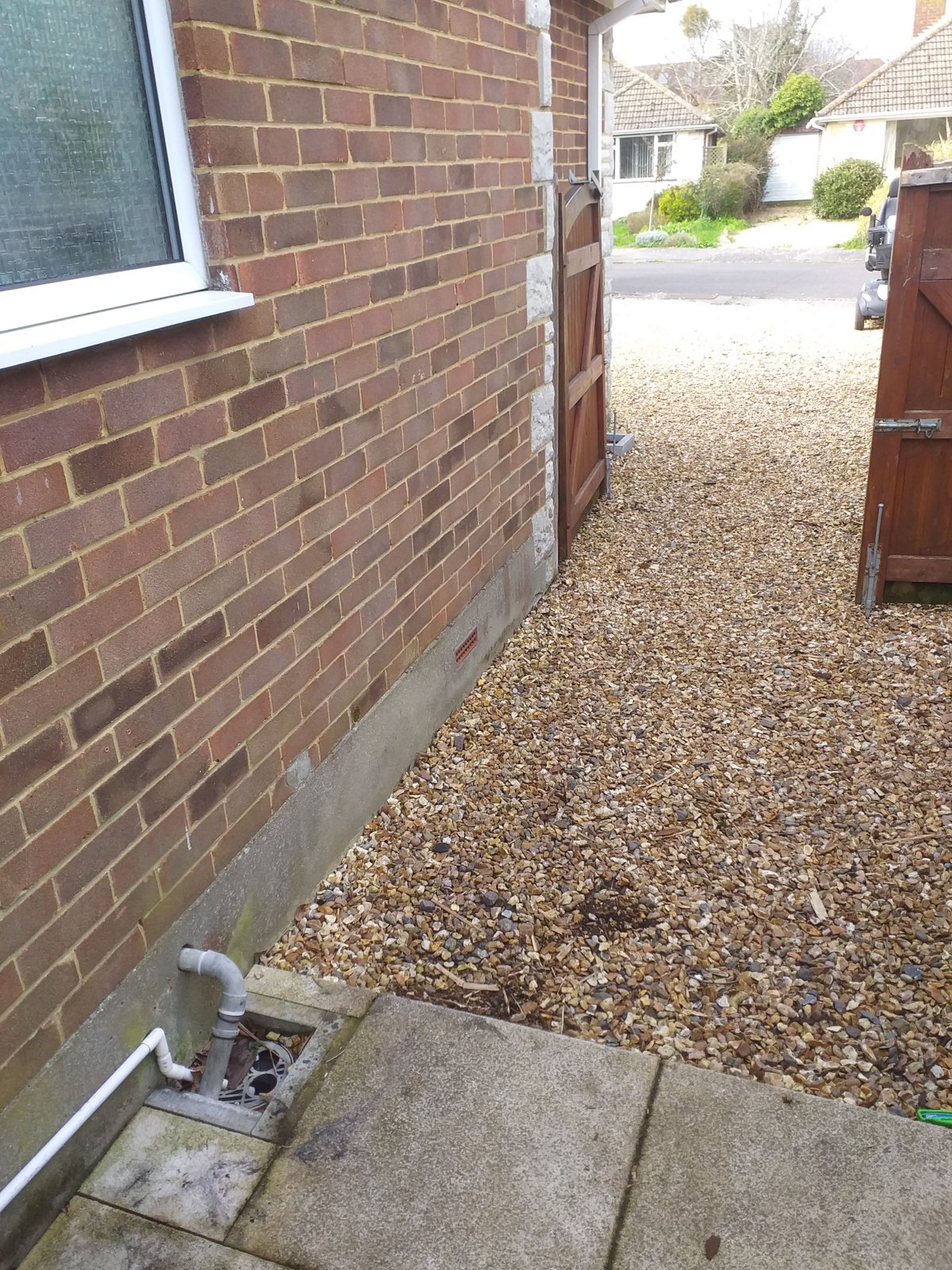

fwiw: no foxhole, water proof gloves are a necessity - acidic condensate can be seen going into the waste gulley.

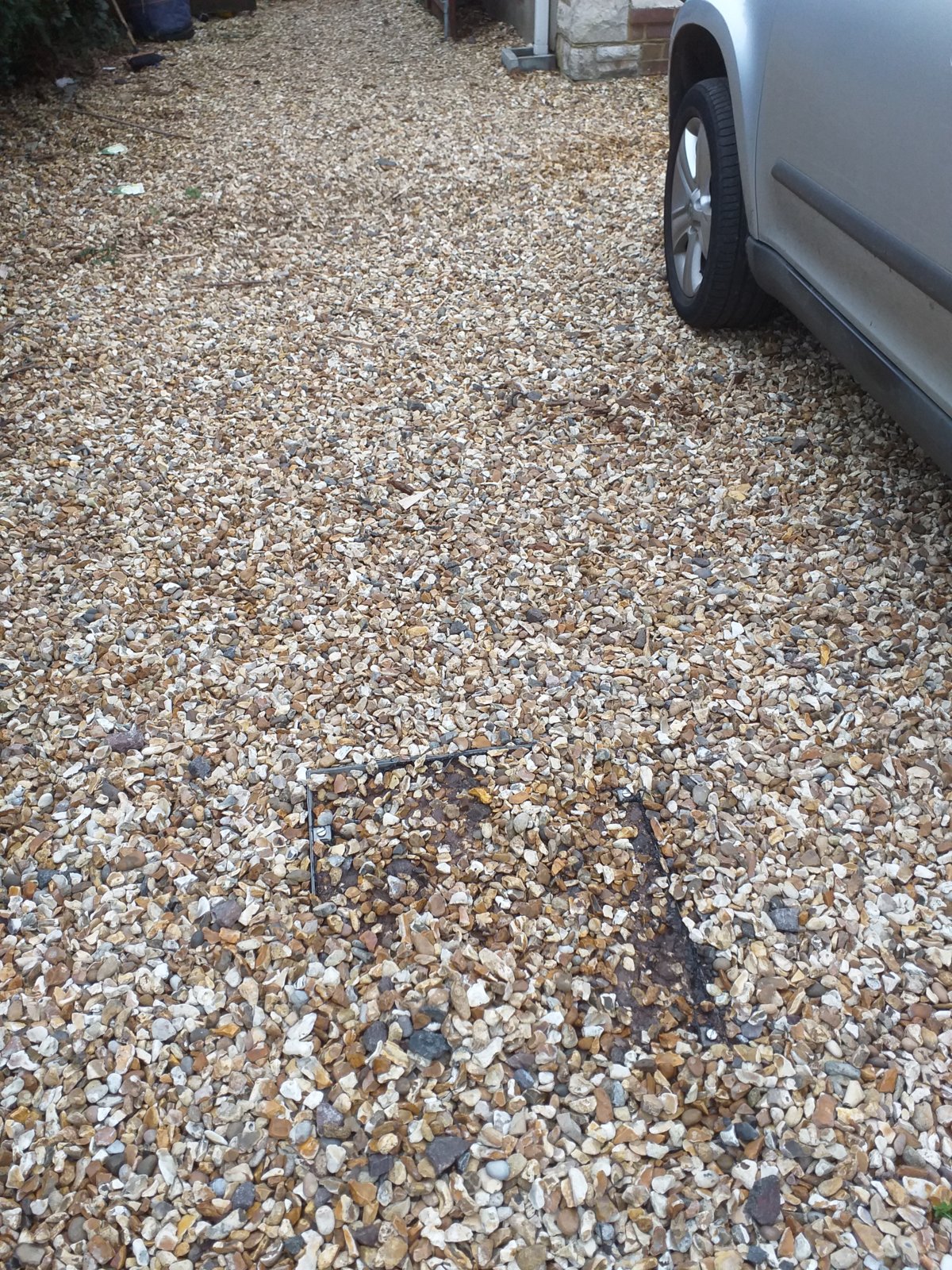

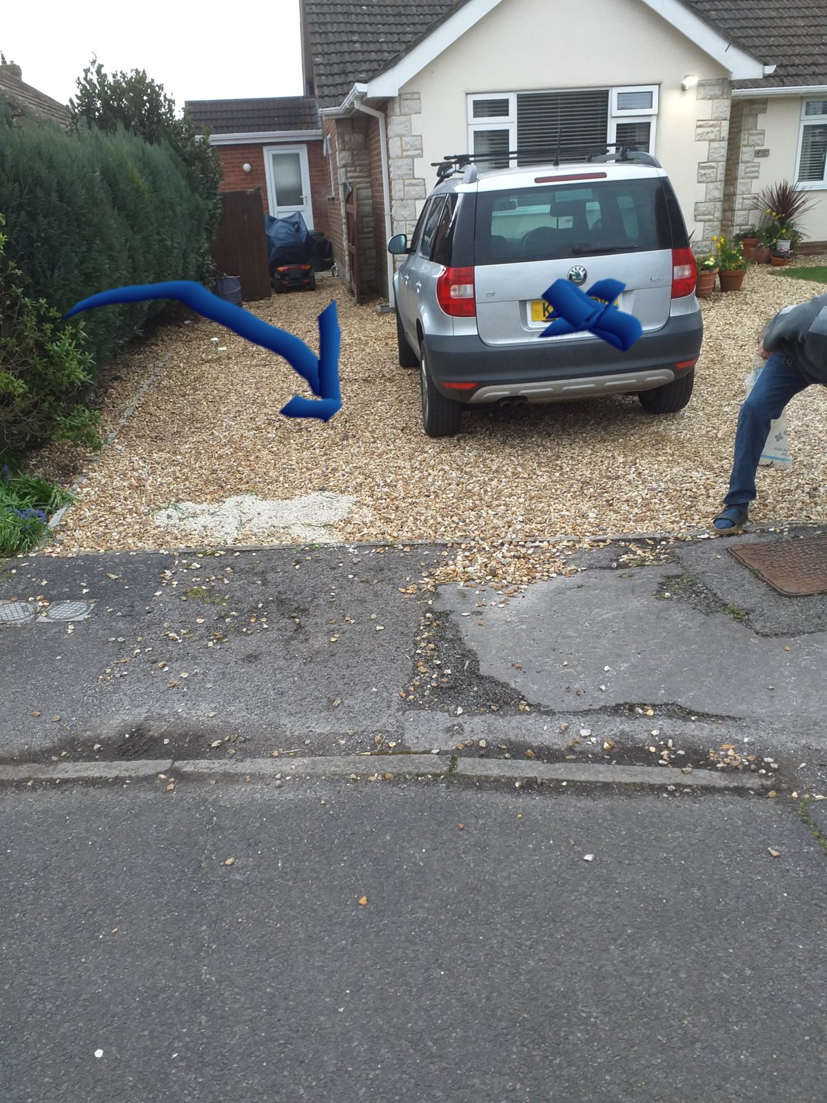

This is at my parent's house. My dad who had a stroke told me about a drain ( where arrow is in picture) . Is this where the water should flow? It's in middle of drive to left of car. Should I indo the screws and lift this up?
the condensate is in the kitchen drain, not the one that’s blocked .
