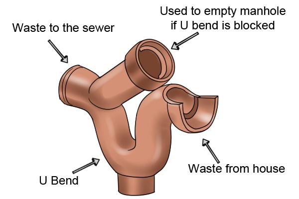

in that residential bungalow with mains drainage, where would an "interceptor" be positioned, and what for?

An 'Interceptor' or 'Buchan Trap' is usually positioned at the outlet of the last manhole before the boundary, where the house drain connects to the main sewer. The Victorians invented them, as a method of sealing off the house drains from the main sewer. Plenty still out there. most are a PITA as they block easily, making the effluent back up slightly, (but then it escapes put the rodding eye above the outlet), until eventually the whole system bungs up and its fun and games to clear... Although I have to say, it would be unusual I'd think to see an interceptor in a property of that era, looks too new.

as i had previously said, and as you agree, why would an Interceptor trap be installed in that modern bungalow?

Your use of quotation marks indicates to me you were questioning the terminology, hence why I tried to explain in terms that anyone reading the post might understand. One thing I've learned with drainage over the last 30 years is never assume anything, so the question of whether an interceptor was present, although unlikely, remains valid.
