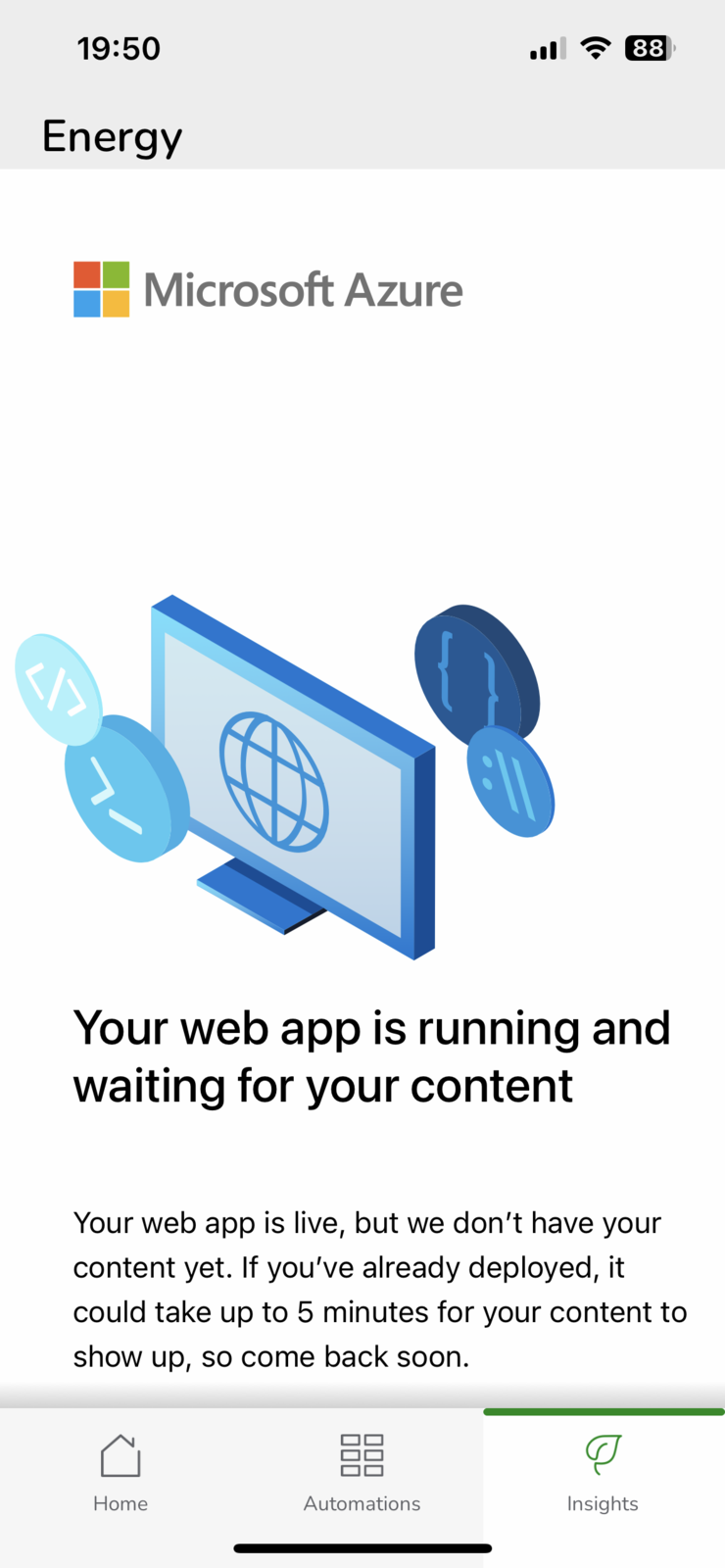

Insights stopped working and I have no weather information. When I click on Insights I get a Microsoft Azure web page. Anyone else getting this?
Thanks. Its a pity they didn't send an email to warn us or better still divert us to a web page explaining they are doing maintenance
Might not have been planned!
It's an assumption on my part (as a programmer) TBH.
I noticed there were a bunch of outages shortly before they rolled out the last firmware and app upgrade, too.
This morning the cloud service is back up and the firmwares for the room thermostats and TRV's have been updated.
