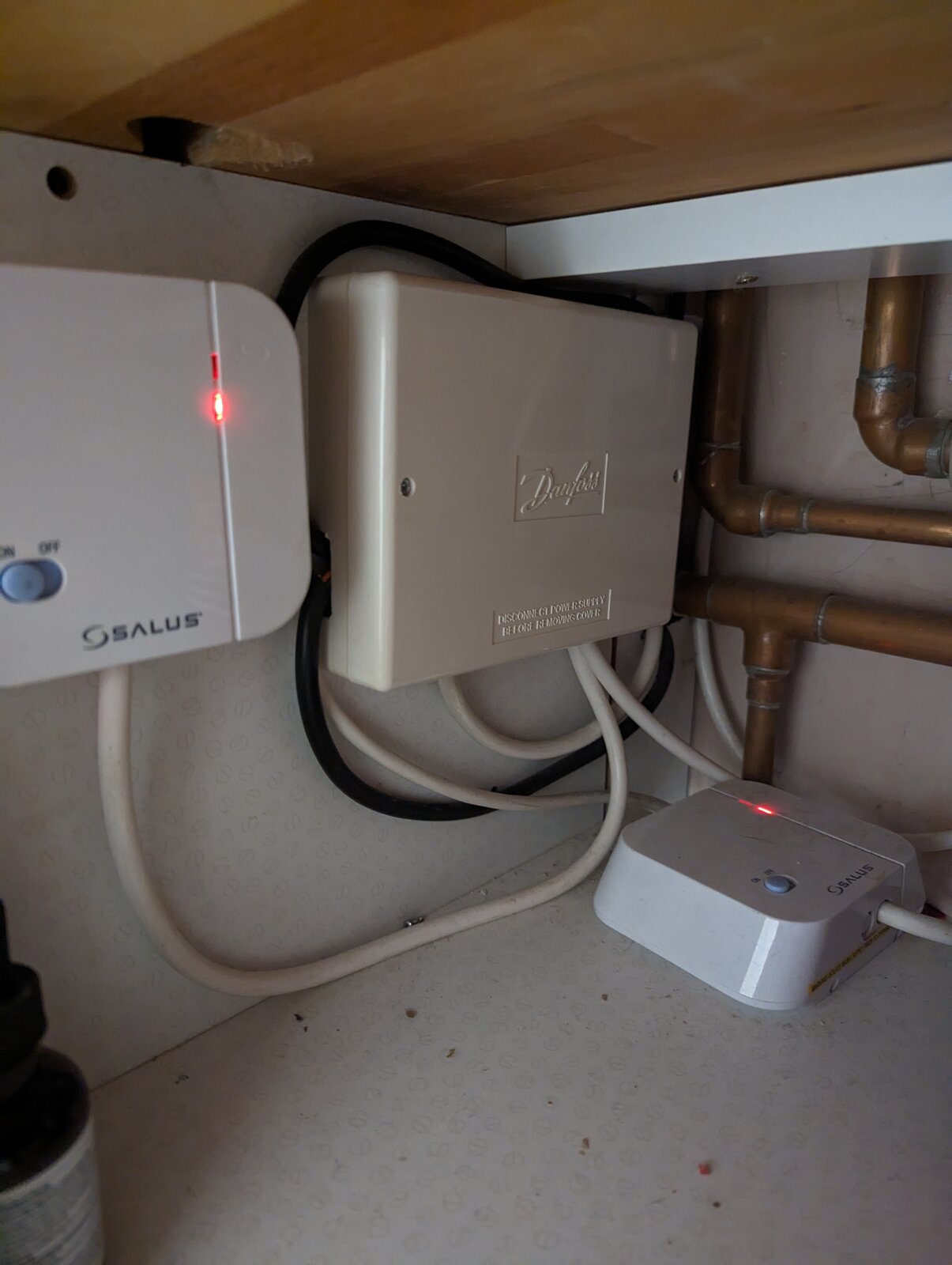

Just to be clear, currently I have two wireless thermostats - one for the radiators and one for the UFH (the level of configuration on them is awful).

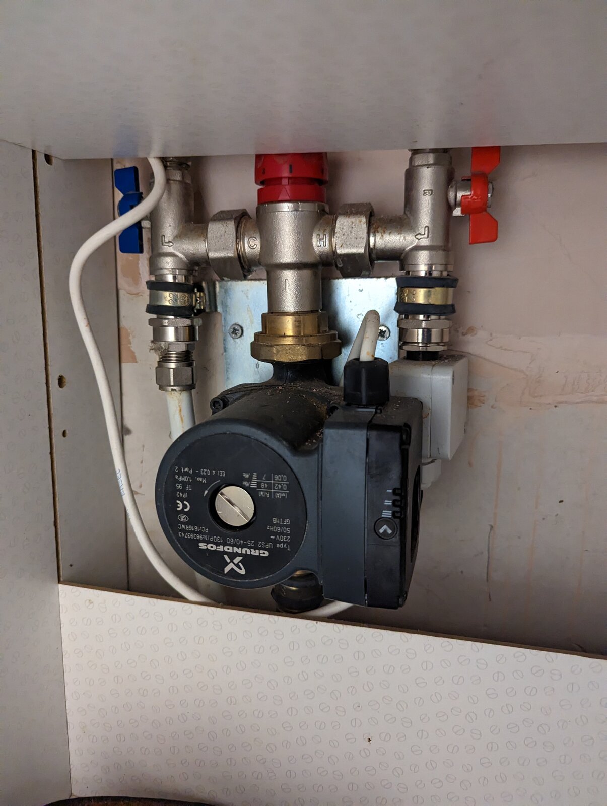

I've attached what I think is a photo of the UFH manifold - I don't know if that indicates if I have more than one UFH zone? As I said previously, I have no reason to think I have more than one zone but wasn't sure if if was normal for an UFH system to just be configured as a single zone even when it spans across multiple rooms.
I've also attached a photo of the two Salus wireless transmitters which actually look like they're all connected together inside that Danfoss connector box so it probably is just all running under one channel.
I wonder if this is getting more complicated though, because, without looking at it in too much detail at midnight on a Friday night, if I have my two thermostats connected to the DanFoss connector box and that being the single "thermostat" connection to the boiler, I can't just switch that out with my Drayton Wiser hub/open therm connection because then the UFH wouldn't be connected either (assuming I'm not moving that over to Drayton Wiser initially). Maybe I would have to do it all in one go.
On second thought... surely the UFH is on a separate channel, it's not like if the UFH comes on then the radiators comes on and vice versa so they must have different pipes going to and from the boiler? I clearly have no idea what I'm talking about but I'm trying

Definitely sounds like a two zone system, which is what I figured you'd have for UFH. You probably need advice from a professional installer - or maybe someone on here has more direct experience.
