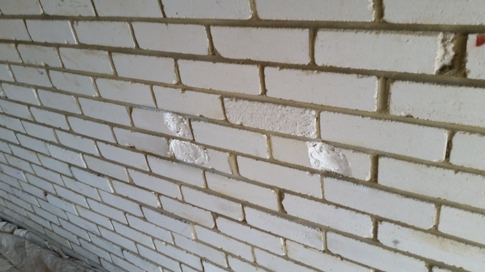

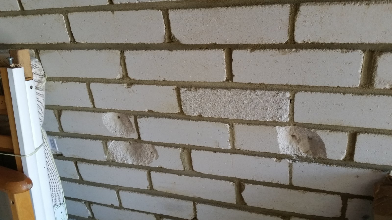

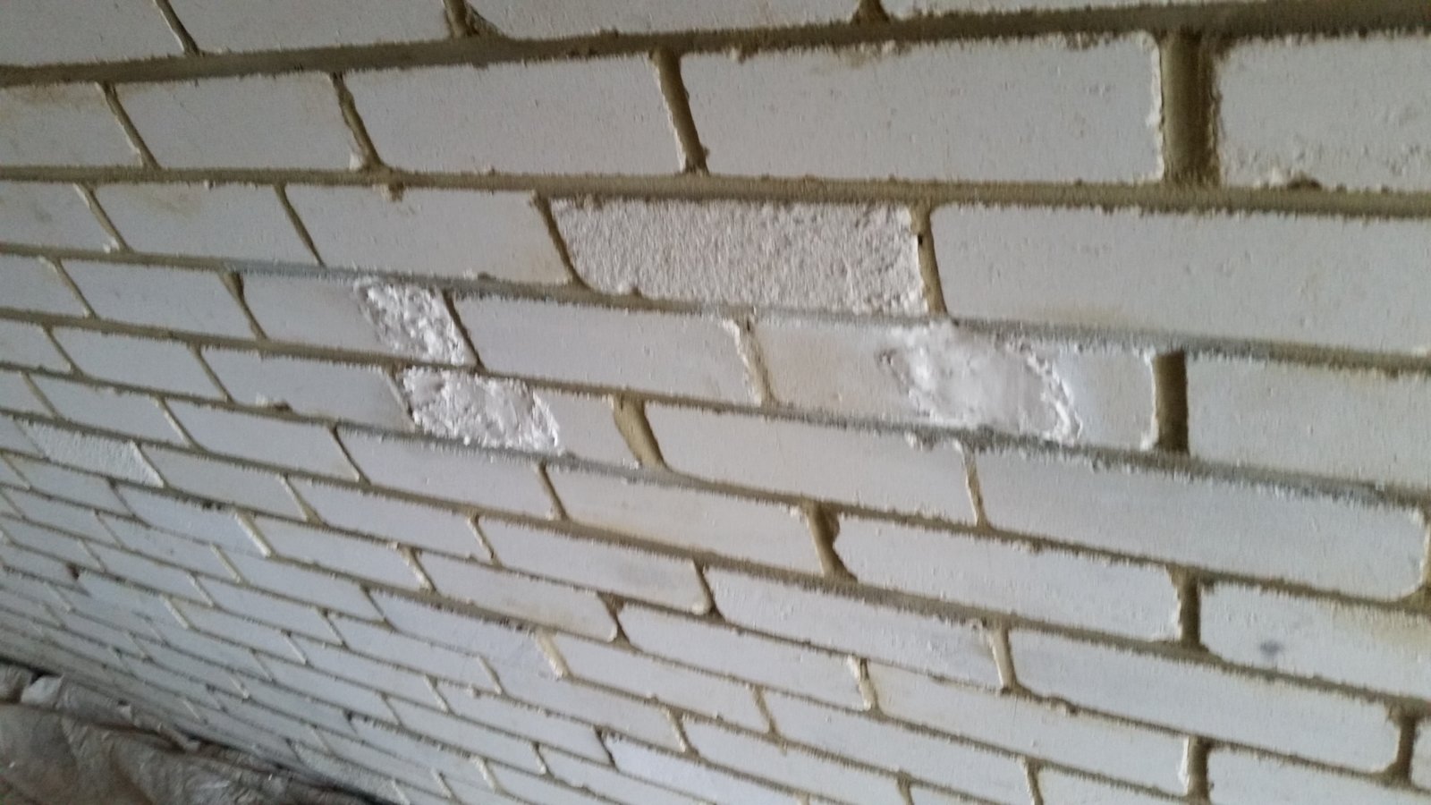

Put first layer of filler. Gonna wait 4 hrs before second layer goes on. Tried to get filler off motar and brickwork with damp cloth. View attachment 146328 View attachment 146329 b

As in photo above I put filler proud of brick mostly (like u would on a wall before painting ) but it's still a bit soft. Do I need to wait until it's rock hard before sanding? Electric or by hand?
Yes, otherwise your paper will just gum up.
I'd just get the random orbital on it with a bit of 60 grit or if you have an OMT, that and a delta pad.

Yes wait until its dry. Hold a vacume upto it
Yes. Rock hard or sanding will mess it up.
I personally would use a 1/3 sheet sander (if you have one) so it's nice and flat.
Have noticed with these fillers they can take an age to go off. I'd leave it a week then poke it and see.
