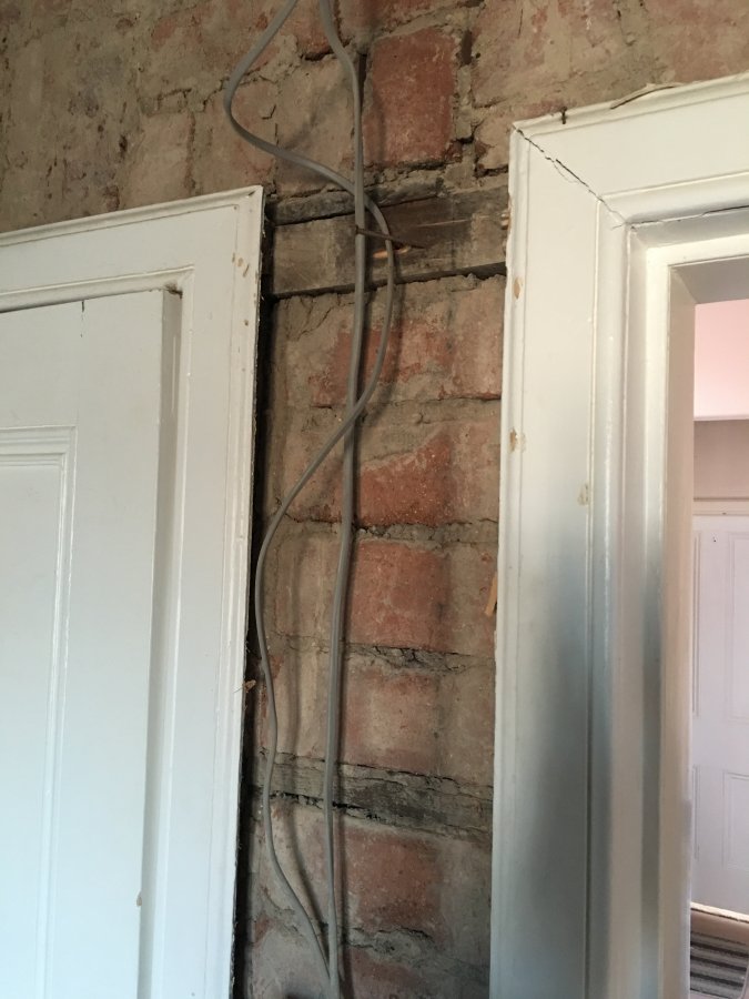

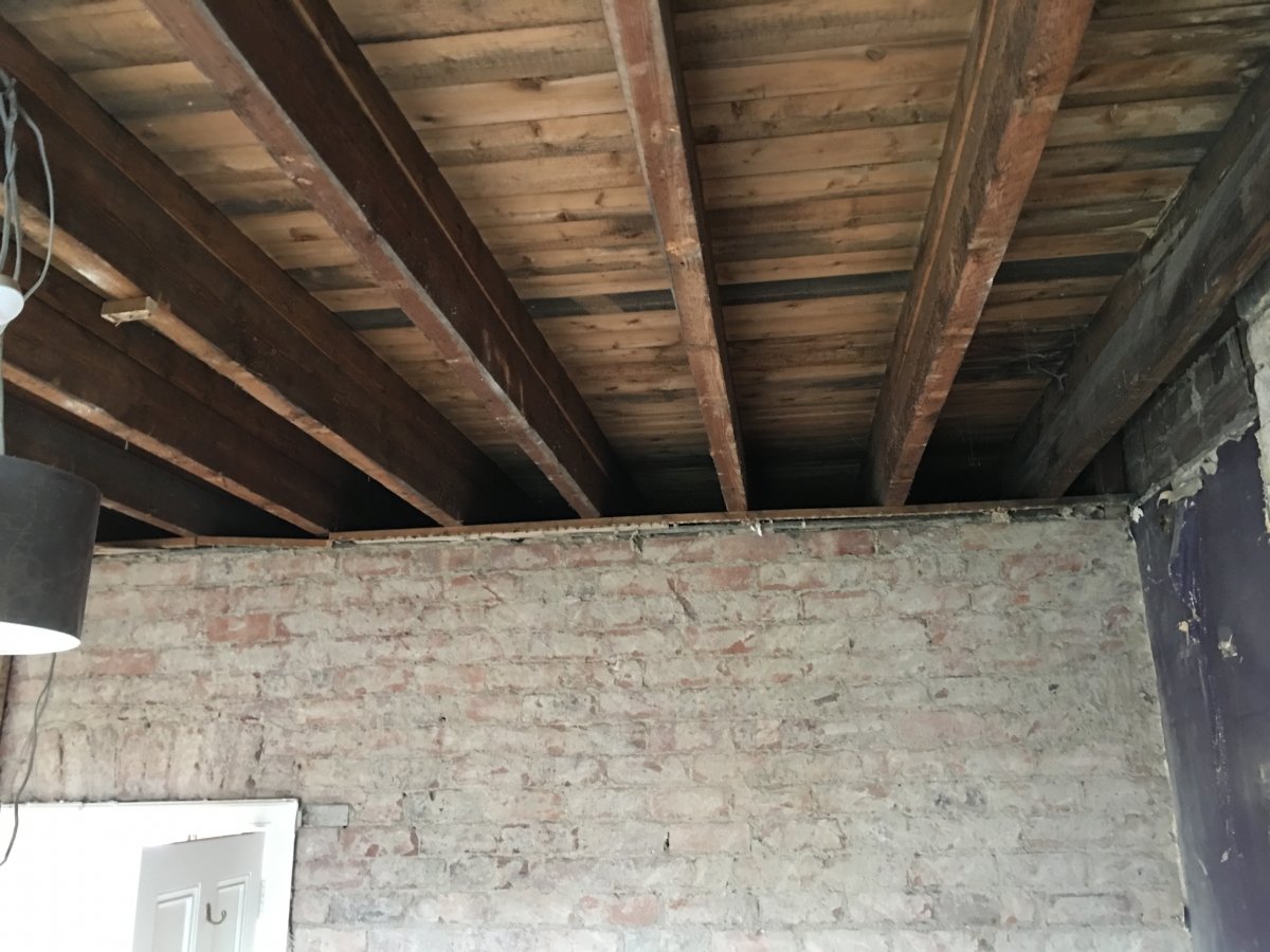

In my case I'm fixing battens to a 100 year old, lime mortar, single skin brick internal wall, with old horsehair plaster on the other side, so I want to use as little force as possible. I'm also battening around two side-by-side doorways, so I'm wary of dislodging the brick column between the doorways (though there are some timbers set into the lower part of the wall I can fix to).
The roof joists are resting on this wall.

It'll be the drilling of the hole which will most likely dislodge the bricks rather than anything else. Take it slow with the drill.
