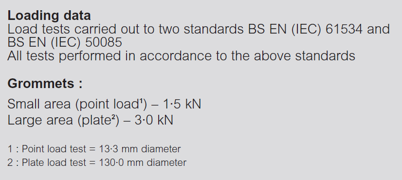

Some floor grommets(not the ones where the lid is just thin 2mm plastic) are rated for standing on, without a noggin underneath or set into the screed, etc. Just a nice neat 127mm holesaw hole...
https://www.powerdatamanagement.co/product/13a-unswitched-power-grommet-inc-carpet-recess/
A full on rectangular floor box is fully rated for heavy office furniture to be left on it permanently, but maybe overkill for home use, unless you're needing aerial/cat5e/HDMI in there also, OP?
