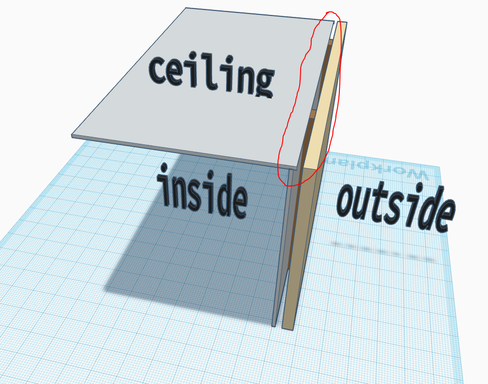

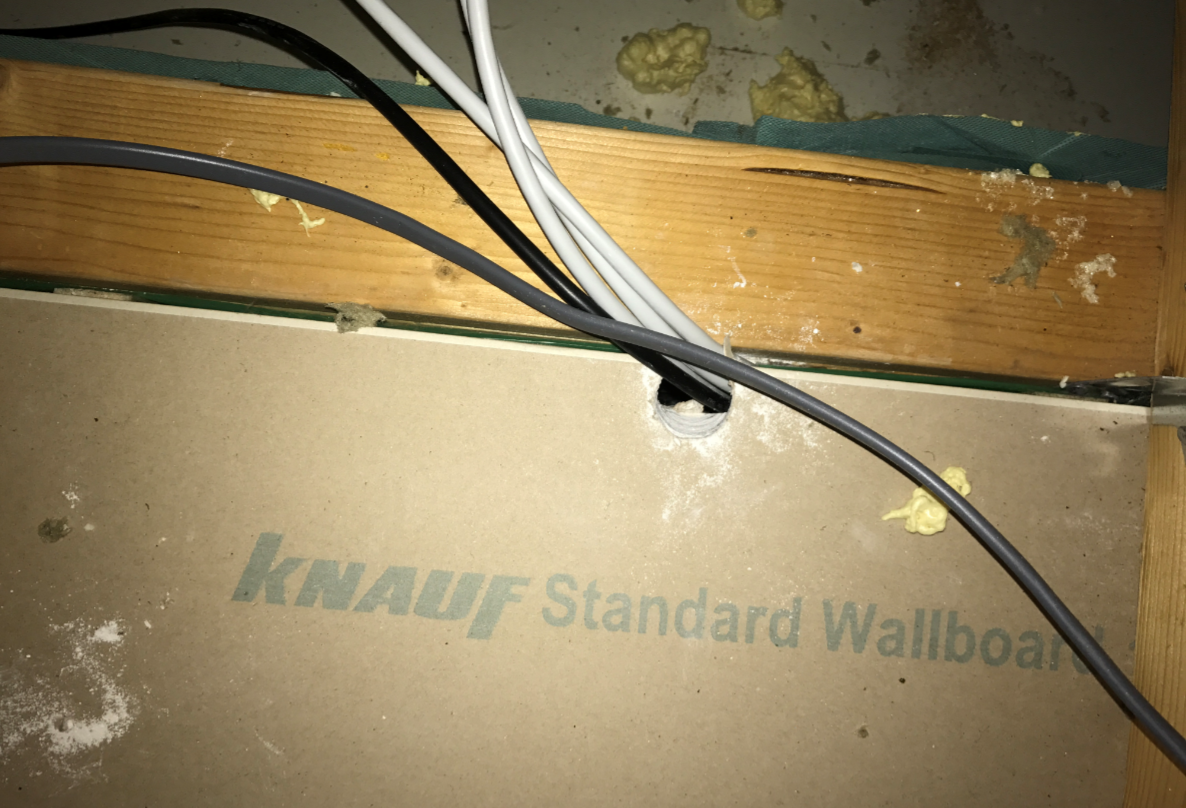

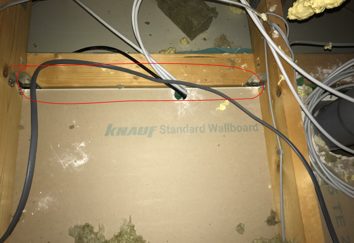

While working in my loft I have discovered something and I'd like to check it with the forum before I go ahead.
My house is a timber frame building. The loft is covered with glasswool but I can see a gap between the below ceiling and the main wall. This gap is covered by glasswool but it seems that it should be sealed as it takes straight to the gap between the plasterboard facing the rooms!!
Before I go ahead and seal it I just wanted to make sure it's not supposed to be there for <put a reason here>.
Attached a picture and also a little drawing to explain what I am talking about. The drawing is showing a massive gap, it's actually very small but I don't think it should be there anyway.
Thanks for your help!

Looks to me like the gap occurred because the truss clips were preventing the plasterboard from travelling all the way (10mm) to the wall plate.

If the dot'n'dab wall boards have been fitted correctly, there will be a continuous seal of adhesive along the top edge of the wall, somewhere about 50mm down it. This will seal it. Rockwool on top will keep it warm.
Nothing to worry about, most houses look like this, if you have blockwork walls they are never 100% straight, so gaps between them and the ceiling will be visible from the loft. But the plastering makes it sealed.
