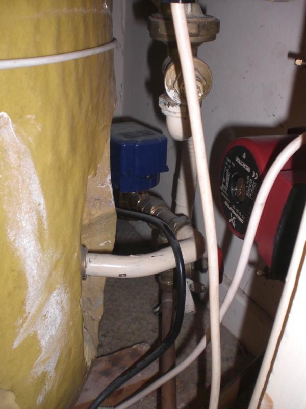

Correct me if i'm wrong but the replacement pump you had a year ago was the one on the left of the pic? If so this is the heating pump and won't have any baring on boiler/noise issues. The one on the right is the boiler pump (you may already know this)
Off the top of my head i'm not sure if your boiler has a pump overrun facility (this keeps the pump running for a little after demand or when the burner cuts out, this is to dissapate latent heat in the heat exchanger) if your boiler DID have one and it'd failed it could give you the problem you describe.
Cheers Andy, yes the pump on the bottom left is the one replaced. We also had the other red pump in the below picture replaced. The store thermostat was also replaced around the same time. Since then the store seems to have been ok.
The Boiler feed and return pipes are on the bottom left, the pump is the left one as it is always on when the boiler is lit.
The two pumps on the right Goldstar (Rads) and Grundfos (Conservatory Heater) operate when the heating is on. Flow and return on the for these on the right. Not sure on the blue thing, think this is an automatic valve for the heating.
Also there seems to be a valve above the boiler, does this look like a bleed valve or just a terminator?
I will try and find out about the boiler pump overrun facility. I do know this boiler on the Baxi site was discontinued in 1993. Now the house was built in 1990, so believe it will be the original boiler! :shock:

Hmm in that first pic you posted the pump on the left looks like it should be the heating pump, this is because the upper connection is only half way up the cylinder. If it was the boiler pump the flow/returns should be at the lowest and highest points on the cylinder to give a better spread of heat around it. Maybe it's been piped up wrong but not sure how relevant this would be to your fault.
Which pump is connected to the highest and lowest tappings on the cylinder?
So has your cylinder got 6 direct tappings? a pair for each pump?
I can't think why you'd have a zone valve fitted, where do it's connections go to/from?

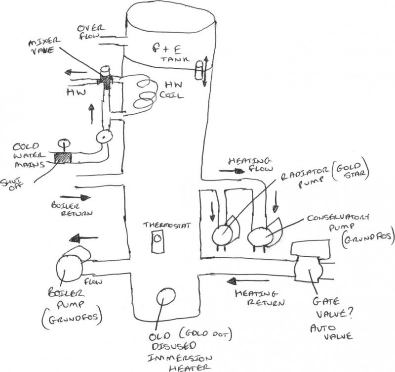

I have tried to draw a picture for you! Sorry i'm not an artist but will help understand connections / flow and returns. The two pumps (Rads&Conservatory) come off the same feed. Also the auto valve is on the return pipe back from the heating circuit?
Thanks for the diagram, what you have makes sense now! Slightly unconventional but so long as it's working fine... (apart from your noise of course)
Does that zone valve on the heating return open when you have a demand for either rads/conservatory?
The power to the valve is twinned into the rad pump, so when central heating comes on it must open. Would this be fitted to stop the water moving from the store around the rads?
