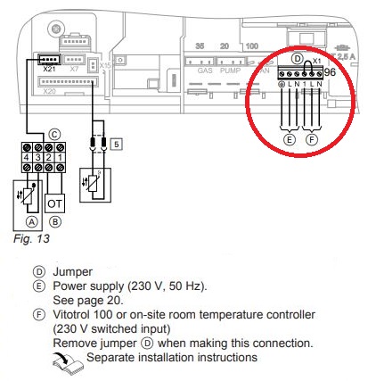

Dear muggles thank you for your quick reply your help will be much appreciated. But please let me know were I will find E and F wiring on Viessmann Vitodens 050
