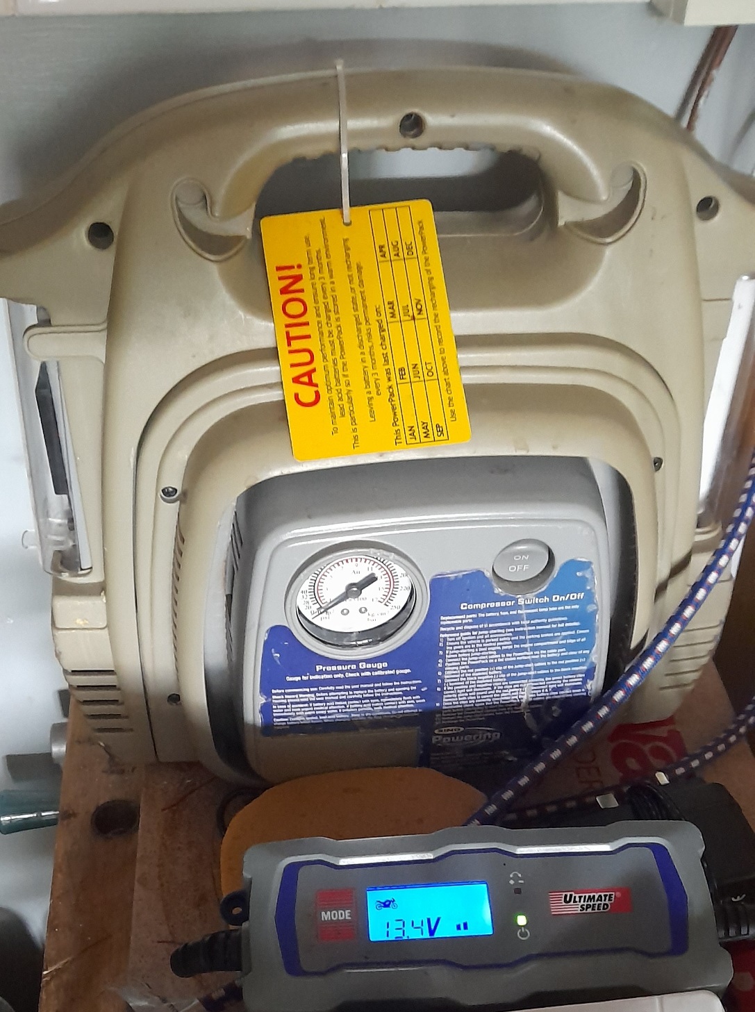

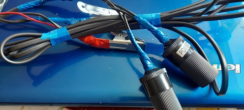

But as homeowners, how far should we go? Personally as it stands, I have a 300 watt power pack using a 20 AH lead acid battery, and 6.4 kWh of battery on my solar, which will run freezers and central heating, and a couple of old batteries kicking around.
I have looked at the modern version of this Battery pack and charger.jpg 1784543475290.png but I have been waiting to see the results of the plug and play solar, as it may all change. I made a lead in case Emergancy power kit.jpg it has vanished, my wife has a carrier bag fetish, where she hides the identity of things by hiding them in a carrier bag.
But be it an auto switch on with power failure torch, proper emergency lights, returning to smoking, so I carry a lighter everywhere, until the main government also changes, we have already done it in Wales, a bit late I know, stuck with 20 MPH, but we, it seems, have to plan for Winter of Discontent 2.

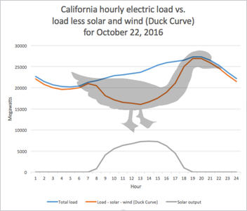

Report refer to a duck curve, 1784645405938.png when we superimpose use and generation it seems we get a curve.
But we have always had periods of peak demand, but the problem is steam or gas powered power-stations take time to come online.
So the main idea is to have a smooth curve, so we have time if required to bring power stations off/online as required.
The peak 4 pm to 7 pm, is a problem, and some tariffs offer us massive rates if we export during that time, the reverse is also true where more is charged if we use it.

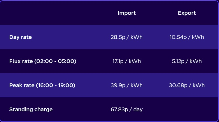

Not looked at late but when I was looking to see the best tariff, I looked at this 1784702014527.png the short night off-peak of 3 hours was OK, but only at 17.1p/kWh and the day rate was lower than the other one I was looking at, but the peak rate at 30.68p/kWh export was over double the rest, at that time others offering 15p/kWh but should I run out, then to pay 39.9p/kWh was clearly not what I wanted, so I went for the EV tariff, so I did not need to worry about running out before 7 pm.
My thoughts were at moving to today's rates, paying 8.625p/kWh overnight for 5 hours it did not matter if my batteries did not have enough capacity to use the days sun, as I am paid more for export at 12p/kWh.
If my inverter had been a latter version, I would have had other options, but it's down to what ones inverter can do.

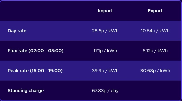

Not looked at late but when I was looking to see the best tariff, I looked at this View attachment 418902 the short night off-peak of 3 hours was OK, but only at 17.1p/kWh and the day rate was lower than the other one I was looking at, but the peak rate at 30.68p/kWh export was over double the rest, at that time others offering 15p/kWh but should I run out, then to pay 39.9p/kWh was clearly not what I wanted, so I went for the EV tariff, so I did not need to worry about running out before 7 pm.
