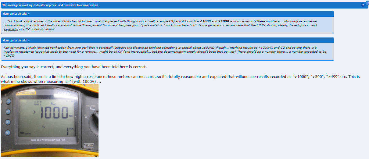

Everything you say is correct, and everything you have been told here is correct.

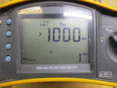

As has been said, there is a limit to how high a resistance these meters can measure, so it's totally reasonable and expected that willone see results recorded as ">1000", ">500", ">499" etc. This is what mine shows when measuring 'air' (with 1000V) ...

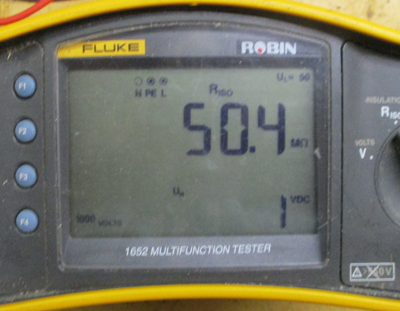

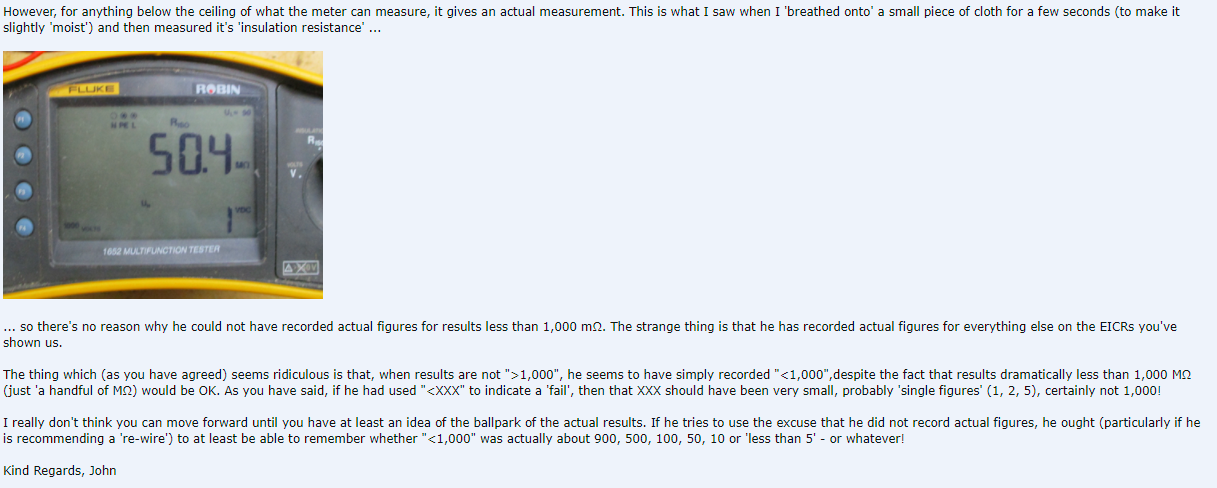

However, for anything below the ceiling of what the meter can measure, it gives an actual measurement. This is what I saw when I 'breathed onto' a small piece of cloth for a few seconds (to make it slightly 'moist') and then measured it's 'insulation resistance' ...
... so there's no reason why he could not have recorded actual figures for results less than 1,000 mΩ. The strange thing is that he has recorded actual figures for everything else on the EICRs you've shown us.
The thing which (as you have agreed) seems ridiculous is that, when results are not ">1,000", he seems to have simply recorded "<1,000",despite the fact that results dramatically less than 1,000 MΩ (just 'a handful of MΩ) would be OK. As you have said, if he had used "<XXX" to indicate a 'fail', then that XXX should have been very small, probably 'single figures' (1, 2, 5), certainly not 1,000!
I really don't think you can move forward until you have at least an idea of the ballpark of the actual results. If he tries to use the excuse that he did not record actual figures, he ought (particularly if he is recommending a 're-wire') to at least be able to remember whether "<1,000" was actually about 900, 500, 100, 50, 10 or 'less than 5' - or whatever!
