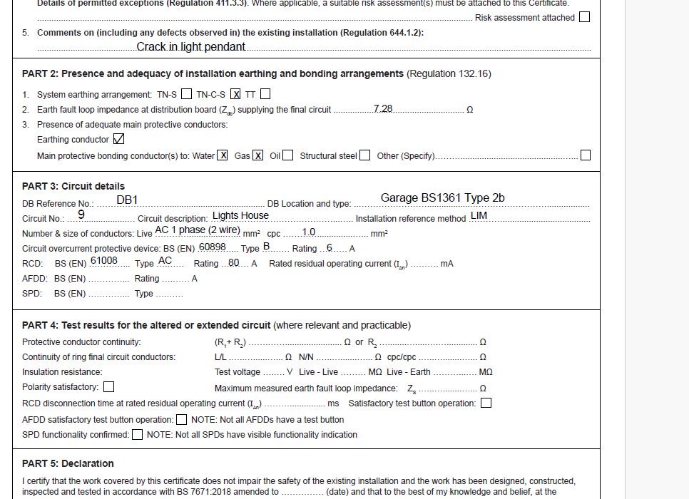

Could someone cast their eyes over it an confirm for me please?

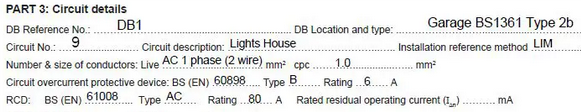

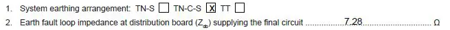

What? A TN-C-S is normally around the 0.35Ω at the distribution board, with TT that would be a good reading, but TN-C-S very poor, 7.28Ω is the limit for a 6 amp type B MCB, so it seems likely he was not looking at the question.
However, with the errors it may as well be filled in the bin, I know what I would do, I would fix the light, then confront the guy would make out the minor works and say errors have been pointed out, would he like to re-do the paperwork please.

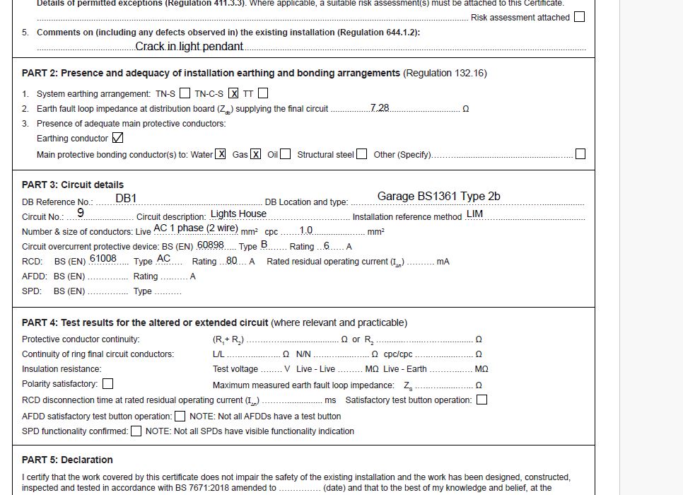

But you said EICR the paperwork you show is a minor works certificate. With an EICR we have codes, C1, C2, C3, LIM, FI etc, and would seem likely a crack in a fitting would get a C3 which tells you damage is found, but it still passes.
One minute talking about an EICR, next talking about a Minor Works certificate, there is nothing saying an Electrical installation certificate or Minor works certificate must be issued, although where these cover the work in question, it is permitted to not issue an EICR until the 5 years has elapsed.
But in the main, a Minor Works or Installation certificate will not show any EICR codes, or anything which shows a fail. There is a space to list anything which does not conform, but the main problem with a minor works certificate is it is limited to the work done. In this case, only the supply to the garage.
The reference is to any defects observed. 644.1.2 is a new regulation, so it would help to know what it says? Google says "Any other defects and non-compliances found in the existing installation during the pre-assessment or whilst undertaking the alterations or additions should be recorded on the certification covering the alteration or addition." so it would seem a method to comply with HSE rules which state defects must be reported in writing, it stops a worker saying after an event I told XXXX YYYYY, but he did nothing, if the report is not in writing the worker is in breach of the rules, and would have just dropped himself into a load of problems.
Confirm what?
Most of it is blank, and you won't be completing it without appropriate test equipment.
What is filled in is nonsense.
Just pay an electrician an hours labour to change the fitting and provide the certificate.
