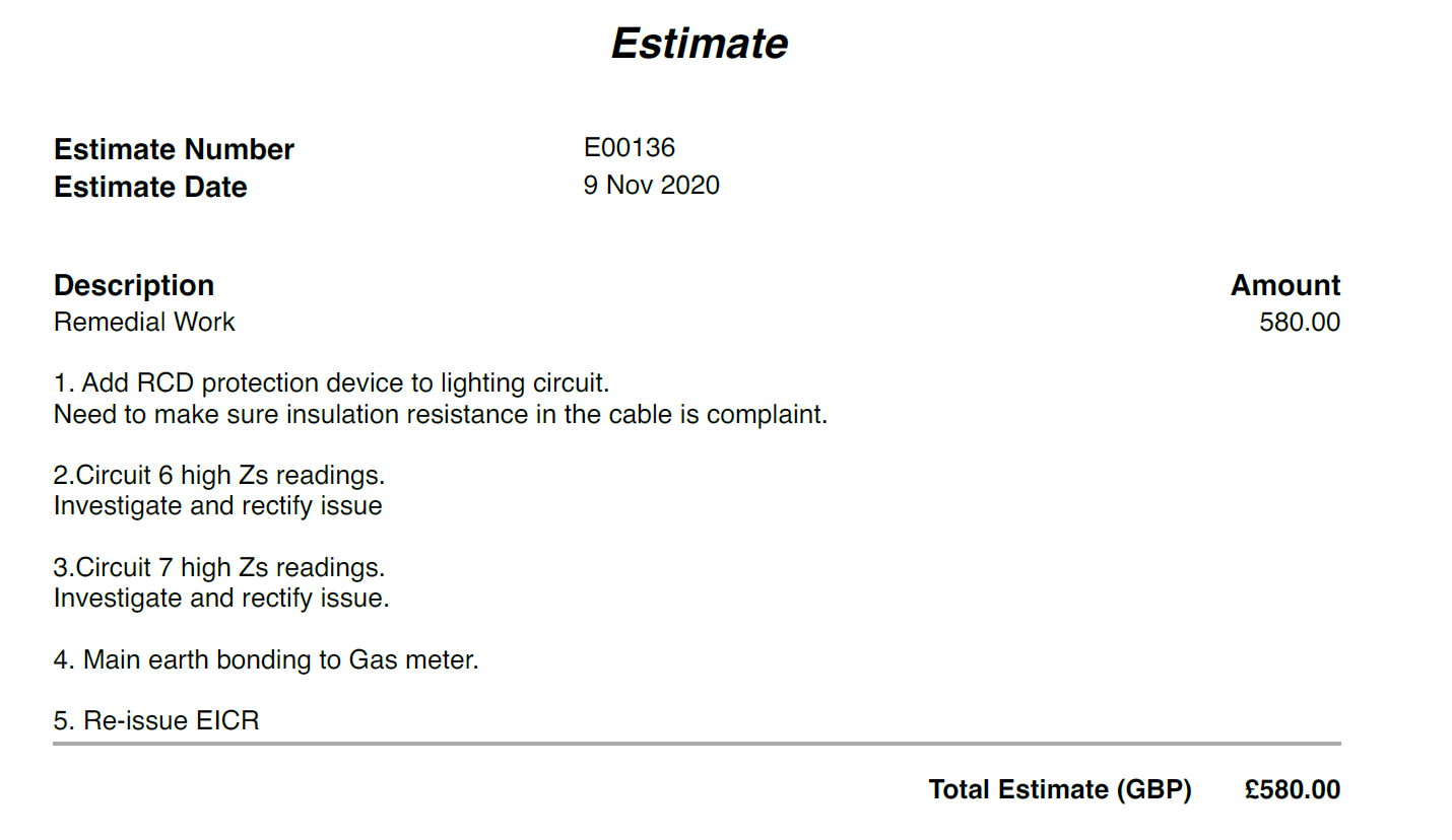

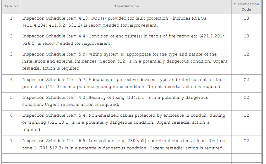

The property its self I rent out. I have a Unsatisfactory EICR and was after your expert feedback about how much it would cost me to get the work done and obtain a new satisfactory EICR. I have attached a screen shot of the failed EICR (c2s) and three quotes I have receieved. What is bizarre all the quote costs really do vary but I guess the big one on the quotes is considering replacing the fuse board. Just to reiterate all I want to do is recitfy what needs to be rectified to get a passable satisfactory EICR?
Am I getting ripped off am I getting my pants pulled down?

There is no reason for a new Electrical Installation Condition Report to be issued. You merely need to append the certificates for works carried out to the existing report.
It cannot be reissued without being reinspected. It doesn't need to state "satisfactory". It's perfectly OK if it states that the installation is "unsatisfactory", but has certified remedial works addressing the relevant issues appended to it.

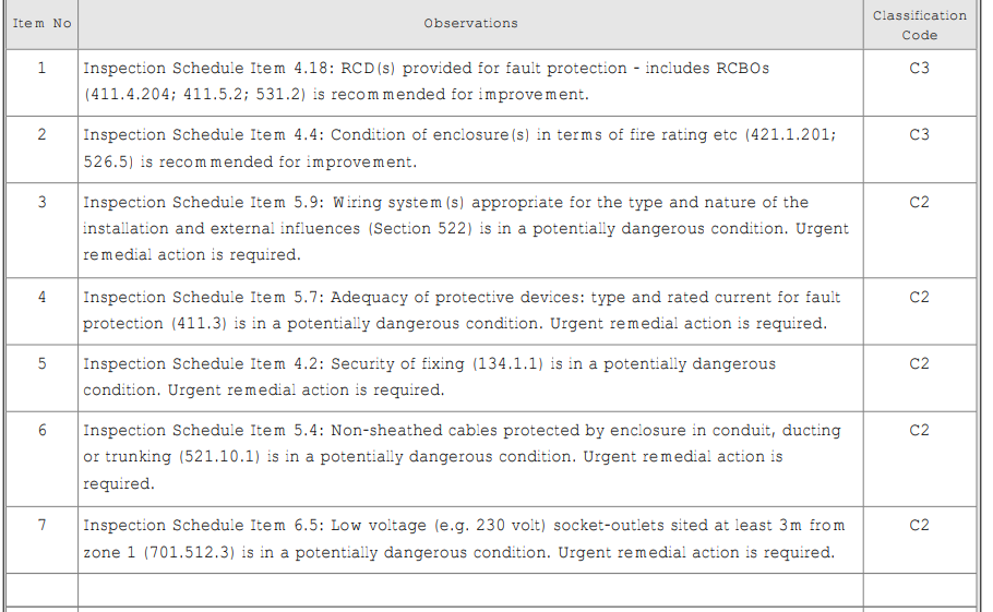

Item 3 makes no sense to me. Do they mean inappropriate?
None of the descriptions reveal what's actually wrong, AFAIC.

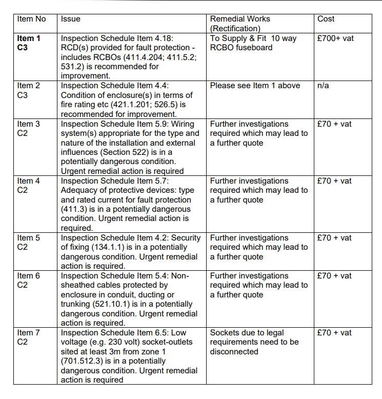

£700+vat isn't necessarily an excessive price for a new consumer unit - but it depends massively on what will actually be provided for that price, and whether a new consumer unit is actually needed at all.

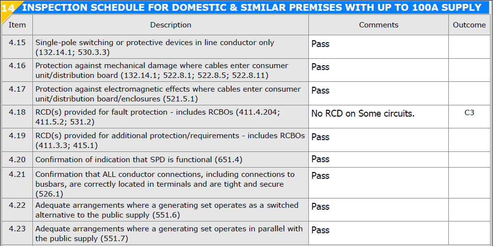

Item 1 is wrong, RCDs are only used for fault protection on TT supplies, and if you had one of those without RCDs, it would not be a C3.
2 presumably refers to a plastic consumer unit, however that's a C3 and therefore not dangerous.
3,4,5,6 say nothing other than generic statements, unclear why further investigation would be required or what the problems actually are.
7 is wrong, there is no legal requirement to disconnect sockets.

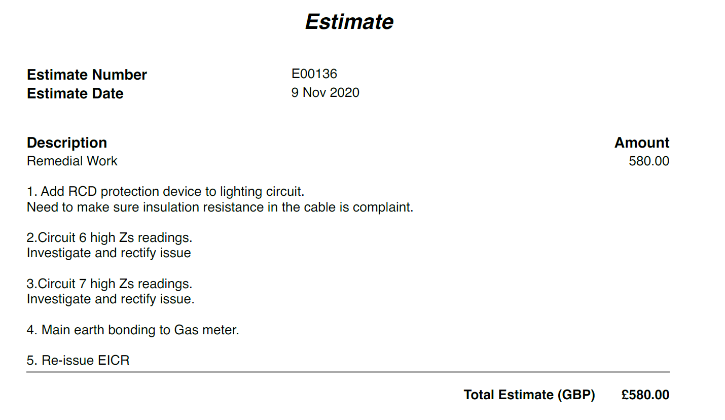

Estimate - 'need to make sure insulation resistance in the cable is complaint', what is that supposed to mean? Insulation resistance should have already been checked as part of the EICR. If it's too low, then repairs are required. It's not usually the cables at fault.
'main earth bonding' - it's either earthing or bonding, not both.
EICRs are not reissued, unless for some unlikely reason someone actually wanted to pay for another one.

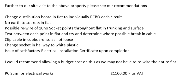

Quote - no earth to sockets is a C2, where is this on the EICR?
Possible rewire - either it's needed or not, the EICR should have revealed whether a rewire is necessary or not. If it's so bad as to need rewiring, it should have been obvious to the person doing the EICR.
Quotes should have a lot more detail, such as the brand of consumer unit to be used - there is a world of difference in price between decent equipment and cheapo tat.
The prices don’t sound outrageous as long as they aren’t lashing in the cheapest tat available.
Whether the work is required, it’s impossible to say from just reading a quotation for remedials and a very vague observation page.
Do you have a picture of the existing consumer unit / fuse box as this may give us a better idea of how old the installation is and whether it is likely that replacement of the unit is required.
One can ask for a quote to install a new consumer unit, or a quote to make the property compliant. They are not the same. As to if RCD protection is required, one can debate this for years with no firm answer. However I have fitted RCD protection to all circuits, so I find it hard to say any one else should consider not to fit them, even if not strictly required.
The inspector has to make a professionally considered option as to if required. As @flameport says in the main "RCDs are only used for fault protection on TT supplies." or other installations where the earth loop impedance is not low enough to ensure EEBADS (Earthed Equipotential Bonding and Automatic Disconnection of Supply) will work.

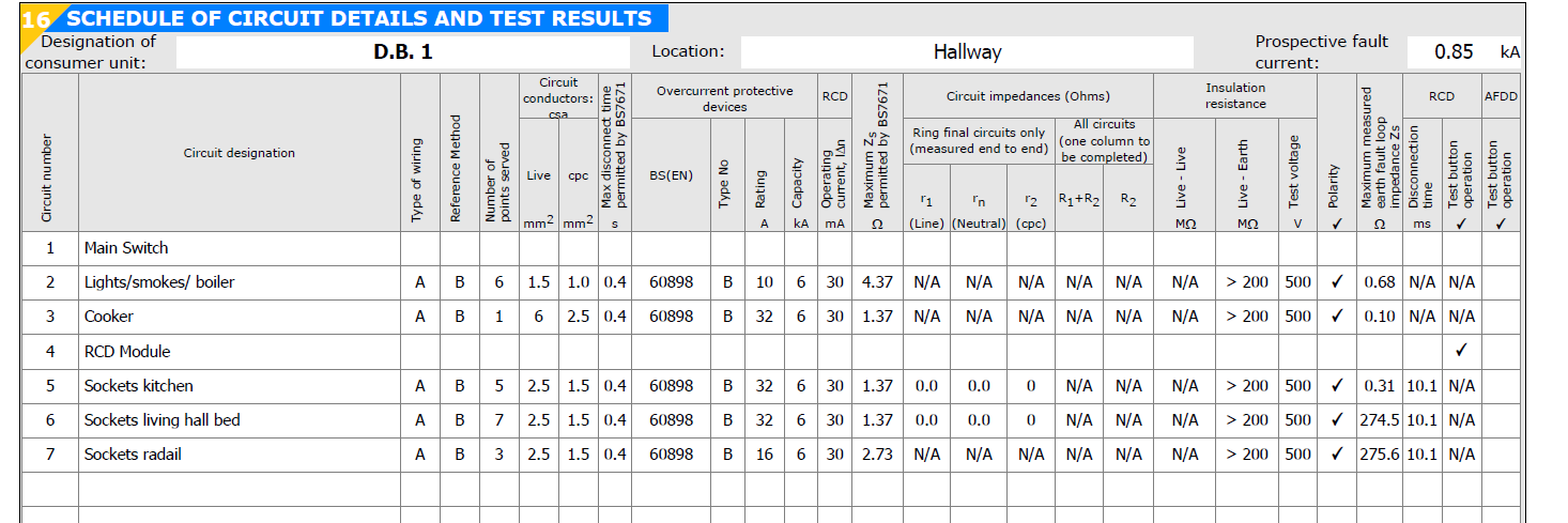

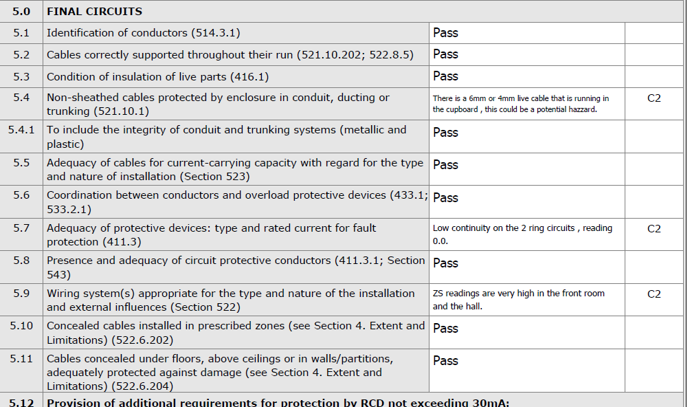

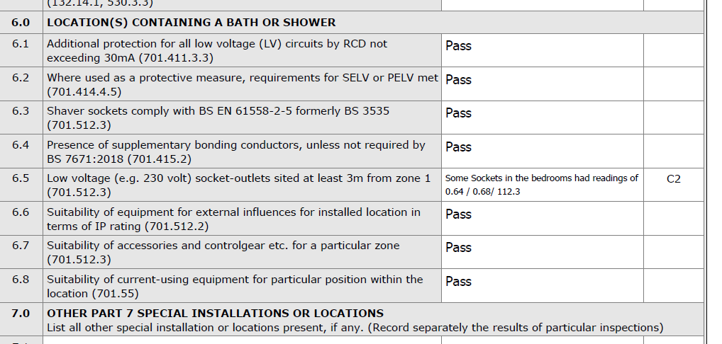

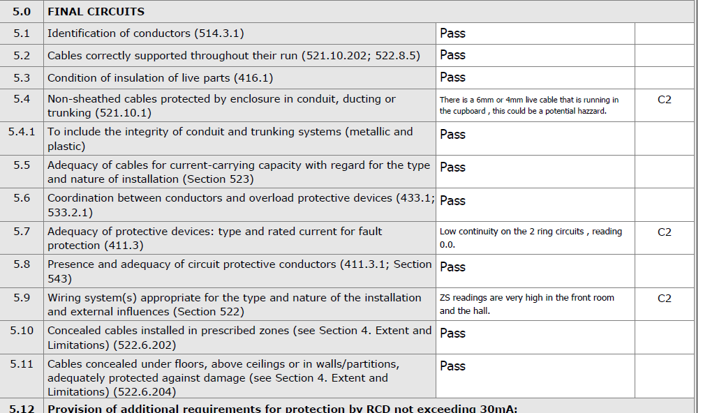

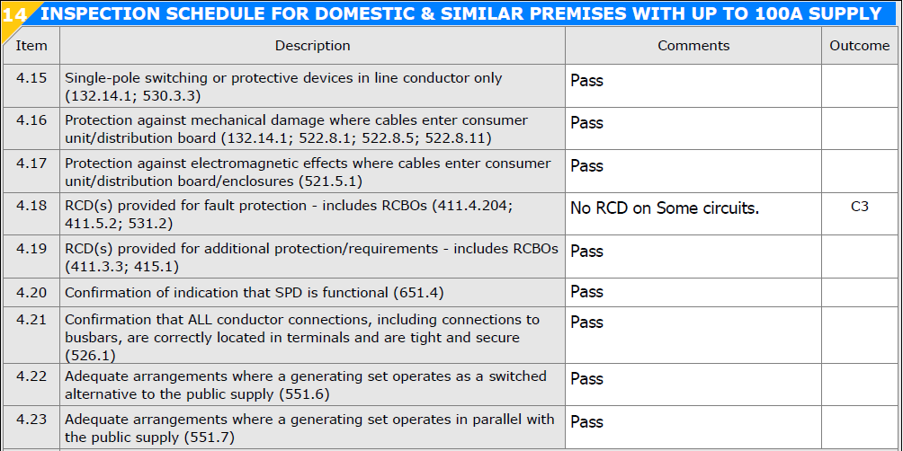

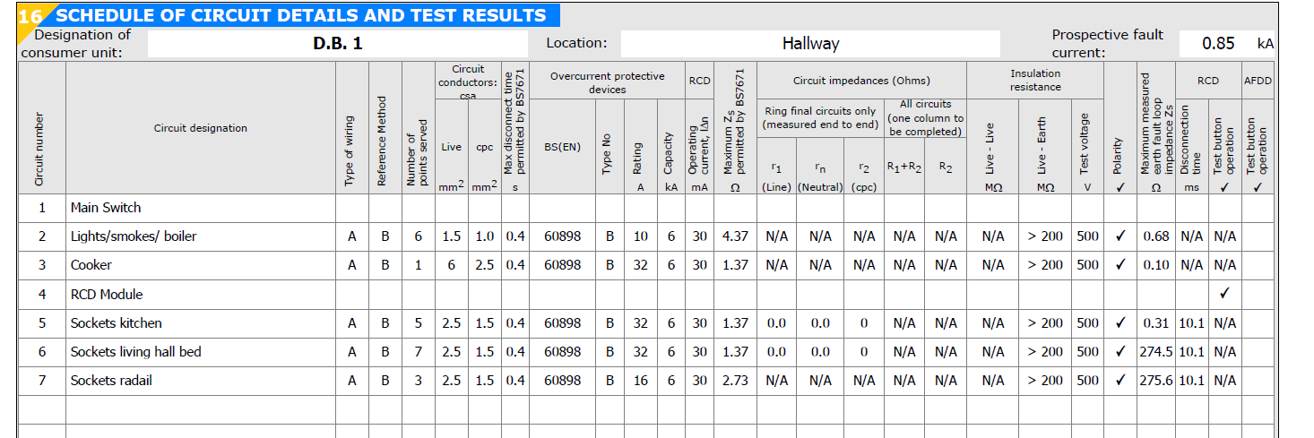

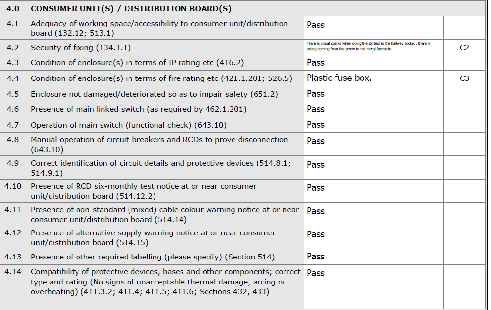

Please see further readings from the report.

There is nothing in that report which suggests you need a replacement consumer unit.
It sounds like there are a few minor issues which do actually need addressing fairly promptly, but other than that there’s nothing too concerning.
I’d say quote number 2 seems to have quoted for what is actually required rather than the other two which seem to have unnecessary work included.
The test results and inspection schedule are full of mistakes, suggesting a lack of competence and understanding.
As for the rest, assuming the descriptions are correct:
there are a few loose connections on the sockets
a cable needs to be put in some plastic trunking or similar
the lights and cooker don't have an RCD - not dangerous, could have RCDs fitted if you want
the consumer unit is plastic - just like millions of others, replacement not necessary.

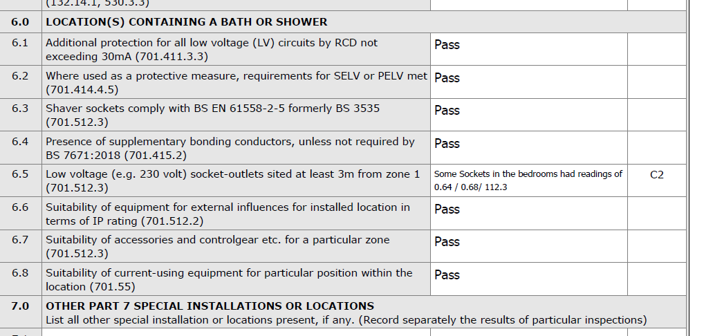

Unclear why the high reading bedroom sockets are listed under items in a bathroom. Is there a bath or shower in this bedroom?
Continuity on the ring circuits cannot be zero, as that would be a cable of zero length.
The readings don't seem to make sense, some thing wrong, the problem is as soon as one reading does not match then all the rest are brought into question, maximum measured earth fault loop impedance 0.10 Ω and the prospective fault current of 0.850 kA does not seem right, if Ze is 0.27 how can Zs be 0.10 it must be higher than Ze not lower. And if the RCD operating current is 30 mA how can you say it's not there?
The 274.5 Ω reading and 275.6 Ω reading are clearly too high, but are so close to each other it would seem something wrong in the consumer unit, I would guess both earth cables are connected together some where for reading to be so close, and it would point to some thing in the consumer unit for it to be common for both circuits.
As @flameport says "The test results and inspection schedule are full of mistakes, suggesting a lack of competence and understanding." so that means can't trust the rest of the report.

Thanks for the feedback especially flameport and ericmark. no bath or shower in the bedroom, haha. What would you anticipate it would cost as a quote to get the c2s fixed? Or would it be worth getting the whole lot investigate again? Anyone on here local to the Surrey area that can help?

So if it were me, then I would talk to an electrical firm and say I have an EICR which to be frank is really a load of rubbish, however it does seem I need a couple of RCBO's fitting and some repairs likely in CU to correct a high ELI and some trunking fitting over come cables, I realise you can't give me a quote as we don't know the fault, so could you quote for fitting the RCBO's and then when fitting them tell me what you consider will be required for rest of work. Just like on this forum you need to talk to the firm first and arrange for a visit. Work out if the guy sucks through his teeth and says jobs worth, or does a reasonable job.
