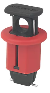

One of these 1658239377818.png costs £8.50, only needs a tie wrap so needs a tool to remove, but I don't have a large supply in my tool box. I was very nearly in a lot of trouble locking off, no on site transport, walked around the Sizewell 'B' building site, told to remove a motor on a crane, so used one of those to lock off, with a lock, and left the key in foreman's hut, if not me replacing the motor, electrician did not have to walk across the site and get the key.

The same goes for insulation tape where a CU blank is missing, we know most people would not remove it, same as insulation tape holding a MCB off, it is one would hope clear it should not be removed, however if some one does, the electrician is up the creak without a paddle. We know it should require a tool or key to remove it, we can't say not our fault.
Basic thing is when the owner gives you permission to work on the installation he knows you will turn it off, and can't turn it back on unless safe to do so. The one where it becomes a grey area, is the faulty consumer unit with no isolator, you can't win, phoning the DNO is no good, must be in writing, and you should not remove the DNO fuse, they should provide an isolator I know, but two wrongs don't make a right. As to if you can send the DNO a text message, fax, or email I don't know, but needs to be in writing, so only way is to lock the home.
So if you ensure everyone outside the house and lock the house, you have complied, even if there are other keys, you need a key or tool to gain access to live parts. Totally crazy I know, and can't see it ever being done, but when you read court cases, it seems they do expect one to go to silly lengths.
