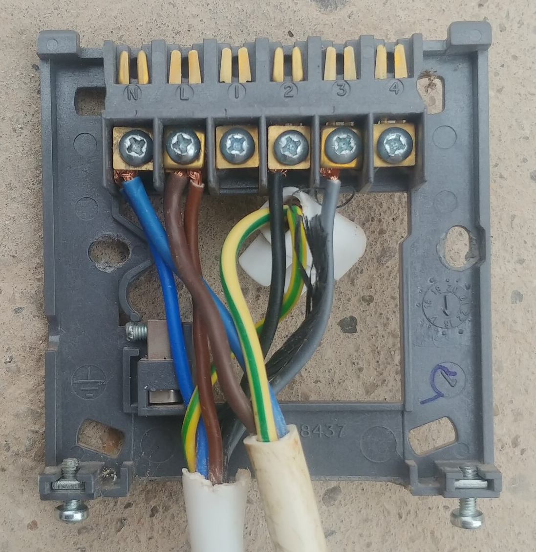

But there are no hard and fast rules as to when fixed equipment is tested, only it must be tested, this 1658394574844.png is from Plumbing and Central Heating section, lack of any cable retention clips or clamps, means it clearly does not comply, and could be classed as a code C2, it would be easy to pull cables out, in fact that was whole reason for post
the wire got tugged and pulled all the connectors out
no excuse not being gas safe, it was an oil combi boiler, and it seems not a DIY install "The fitter wired it all up with this Danfoss RX1 which we had already." so to do an EICR one would need to look at thermostats, programmers, and boilers.
