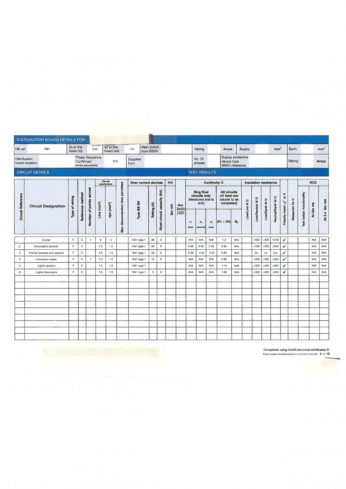

Picture one shows missing screws and the green at edge of switch likely copper oxide which may result in a shock if used with damp fingers. Although unless one can measure the leakage it would be hard to condemn although I would ear mark it for a change.

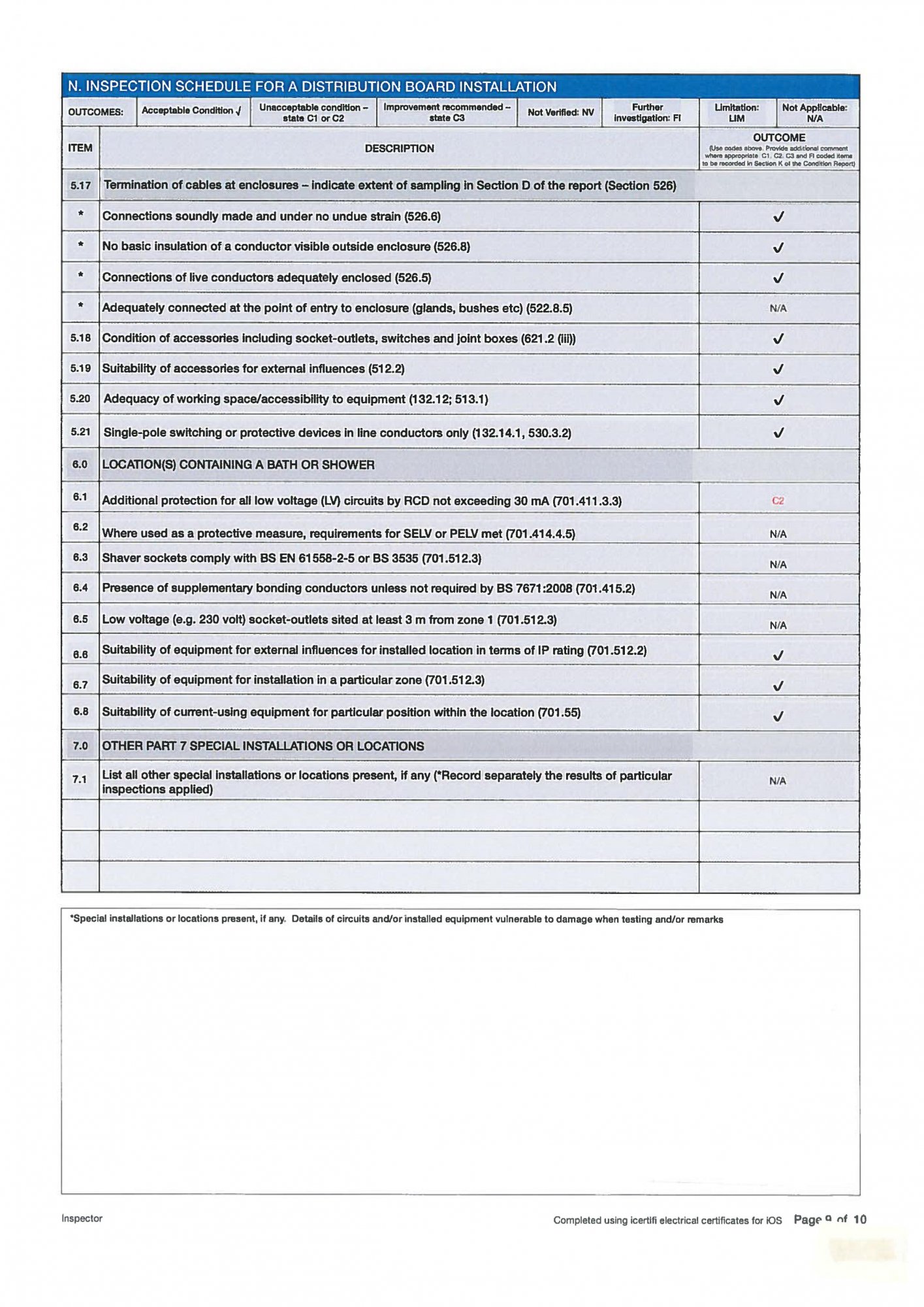

Picture two missing earth sleeve and butchered ceiling rose I would assume you have removed cover for picture, however no real problem.

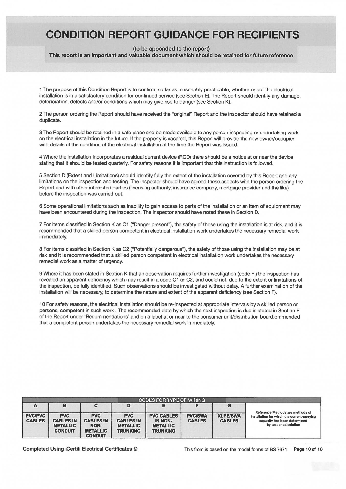

Picture three earth sleeve missing but no real problem.

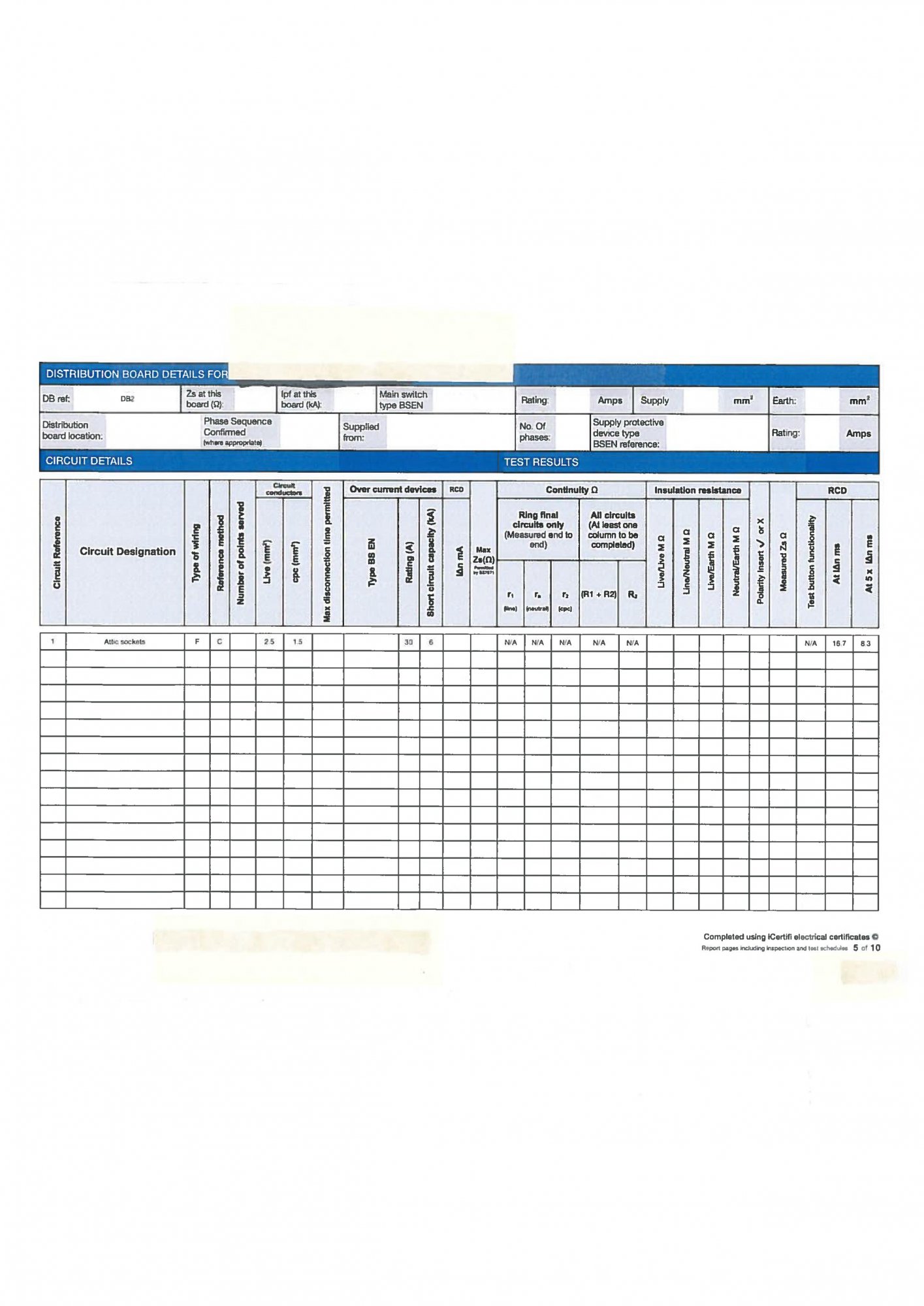

Picture four rings alarm bells seems like it is a ring with spur coming off it, earth sleeve missing and live wire showing where it is not been stripped to correct length or inserted fully in the terminal, what I can’t work out is if rubber or plastic cables.

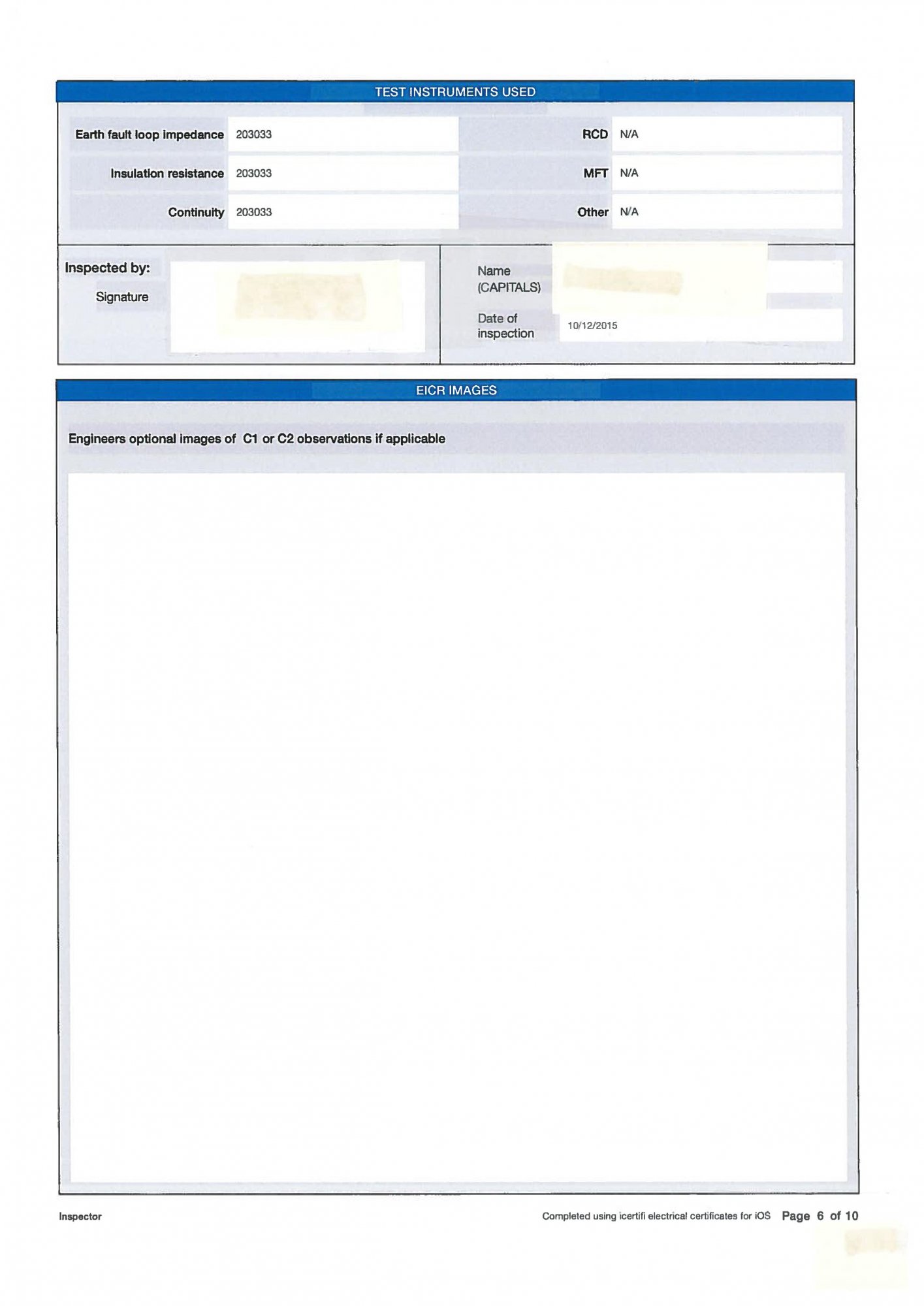

Picture five a bit untidy but can’t see any real problem.

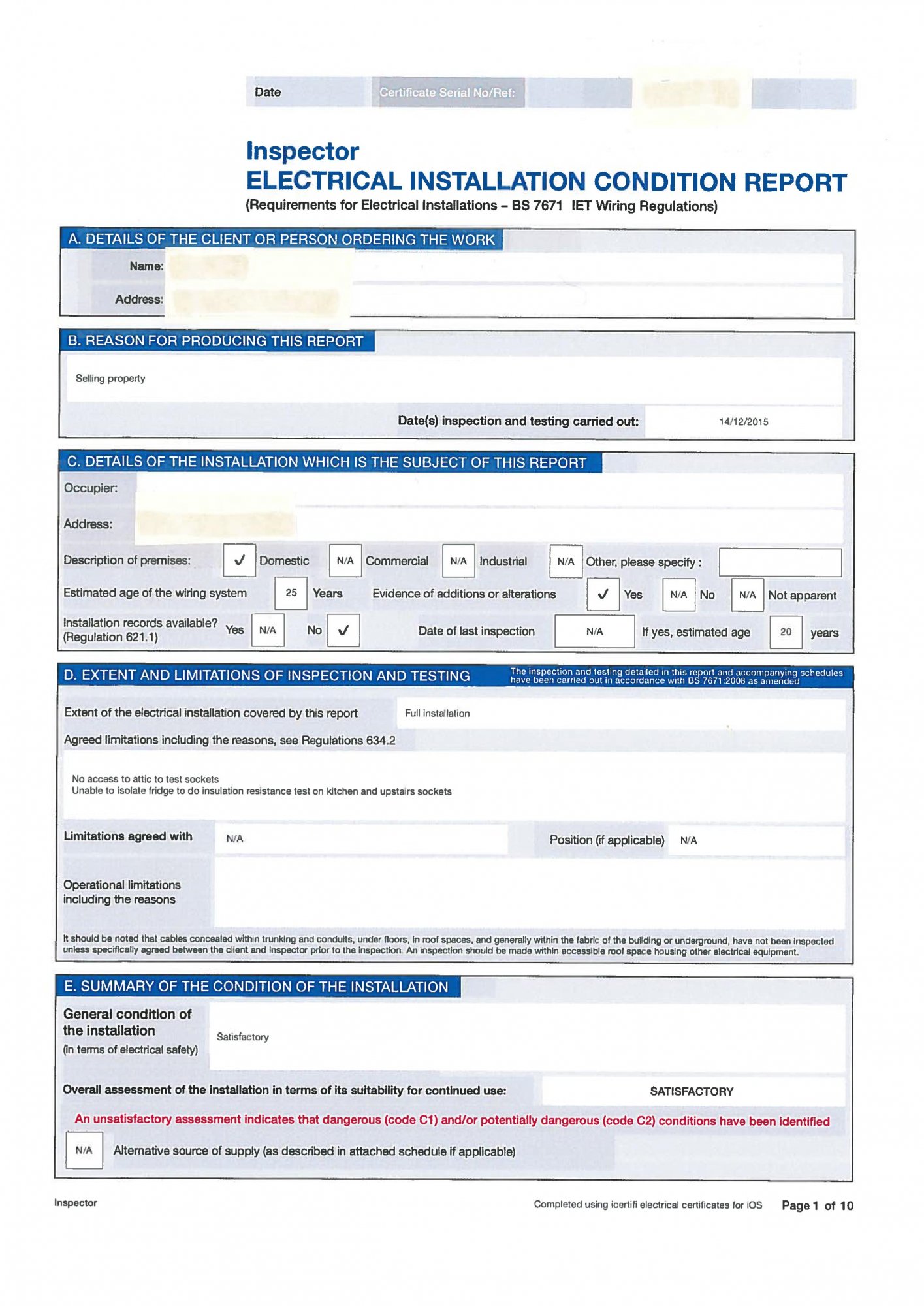

Picture six they look like re-wire-able fuses to me? Two problems, one they are only permitted where a instructed or skilled person is in control because wrong size fuse wire could be used, and two likely asbestos is used in the fuse holder. So needs replacing.
