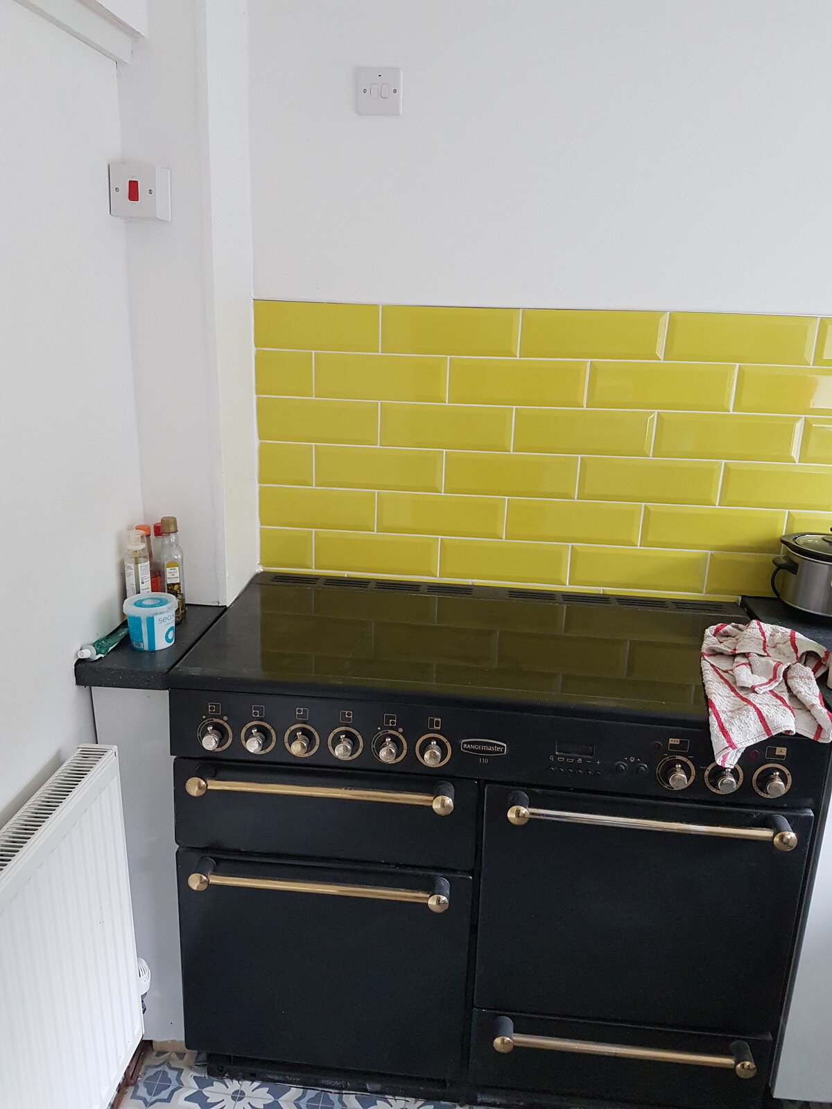

Hi
Need to get an EICR done, but first want to address any potential issues. One is the location of the cooker isolator switch. I'm assuming it'll flag up as C1 or C2, see photo below. It's 100mm to side of cooker top and 165cm up from floor. Am I right in thinking it should be 300mm/120cm up?
Cheers,
There are no regulations stating that a cooker switch is required therefore, for one's location there are only general regulations and recommendations, so down to common sense.
As for the EICR, Electrical Installation Condition Report, if there is not an electrical problem, it could be argued that no code should be given - just advice.
Others will disagree and you might get one of them.
Thanks. I think there's enough cable on both ends to shift it if need be, but hopefully he'll agree it's ok.

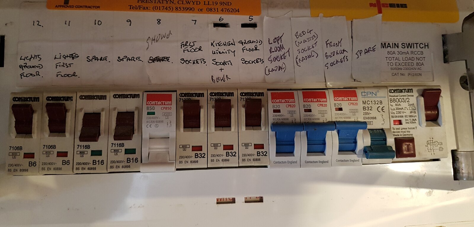

Other question.. I'm not convinced there's adequate RCD protection on the consumer unit. Is there any way if find out prior to the inspection?
Residential. Although possibly going on the market either to sell or to let.
Well -
if selling, don't bother with EICR - sell as is.
if residential, don't bother with EICR unless you think there is something wrong. If the single RCD has not tripped, it would suggest all is well.
if letting, you will have to have EICR (landlord test?) so it might be worth updating the CU.
No, not had any issues with RCD tripping. Was just concerned that one wasn't enough or didn't cover everything that needs covering.
It was last tested 2005, so would rather get it tested for peace of mind. We're leaning heavily toward letting, so will likely need it anyway.
Is an EICR an EICR? Meaning are there specific residential EICRs and different landlord EICRs, or are they all the same?
It's now considered better to have more than one as then you don't loose all circuits because of one tiny fault.
