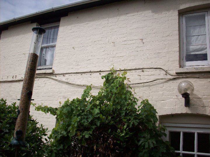

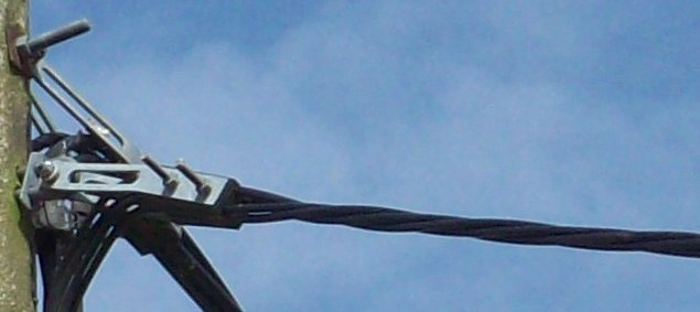

For a start, my supply comes 'overhead' from the pole to the wall of my neighbour's house in a 3P+N 'ABC cable' - which, although called 'a cable', is essentially three twisted singles .....
From there the supply travels about 25m to my house as 4 singles 'clipped' (sometimes more like 'draped!') to the neighbour's wall.....
Although it is not all that difficult to envisage situations in which just the neutral could be broken (as can be seen, it's well within 'snipping range' of someone pruning the neighbour's bay tree, and the vermin are not beyond walking along the ABC cable and having a nibble!), I have been offered (but have declined) PME.

3P+N 'ABC cable'
is considered "safe" from incidemt that would result in one conductor snapping.

[ABC cable] ... is considered "safe" from incidemt that would result in one conductor snapping.
Presumably it is, but I would not have thought that the same would be true of the lengthy and iffy run of ordinary singles along my neighbour's wall, would you?

Far less likely to snap due to being stretched tightly as an overhead between two anchoring points.
Yes, I'm not disagreeing with that, but the consequences of it breaking (e.g. in relation to the infamous 'outside tap'), if it does, would be exactly the same as if it were an underground cable. Since you raised the 'outside tap' (or 'gas meter box') issue, I thought you were implying that it was in some way specific to overhead cables.
