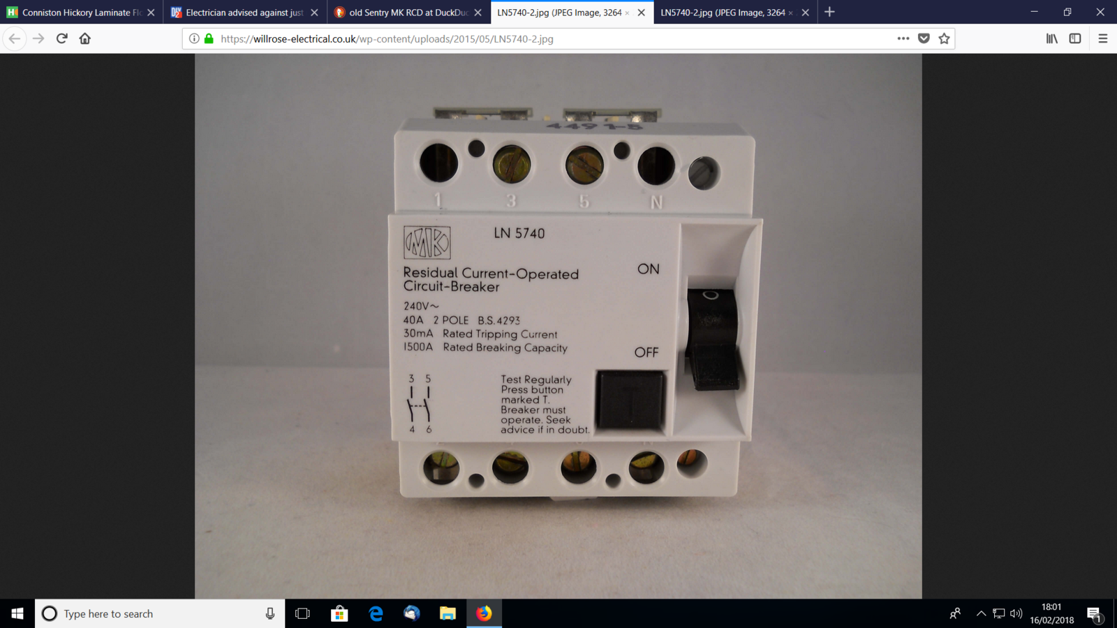

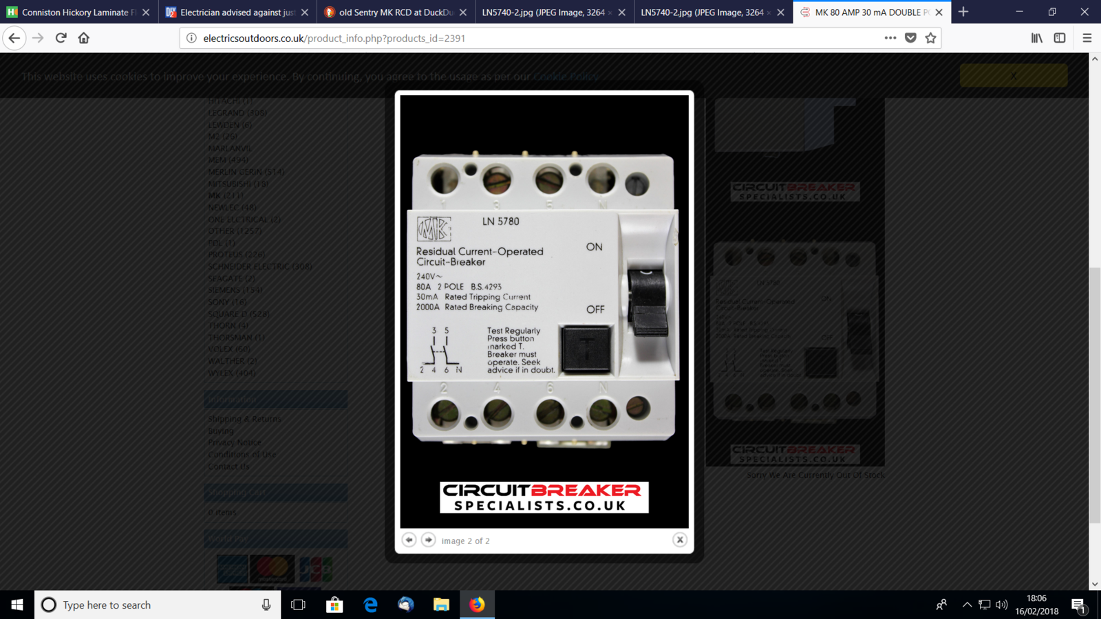

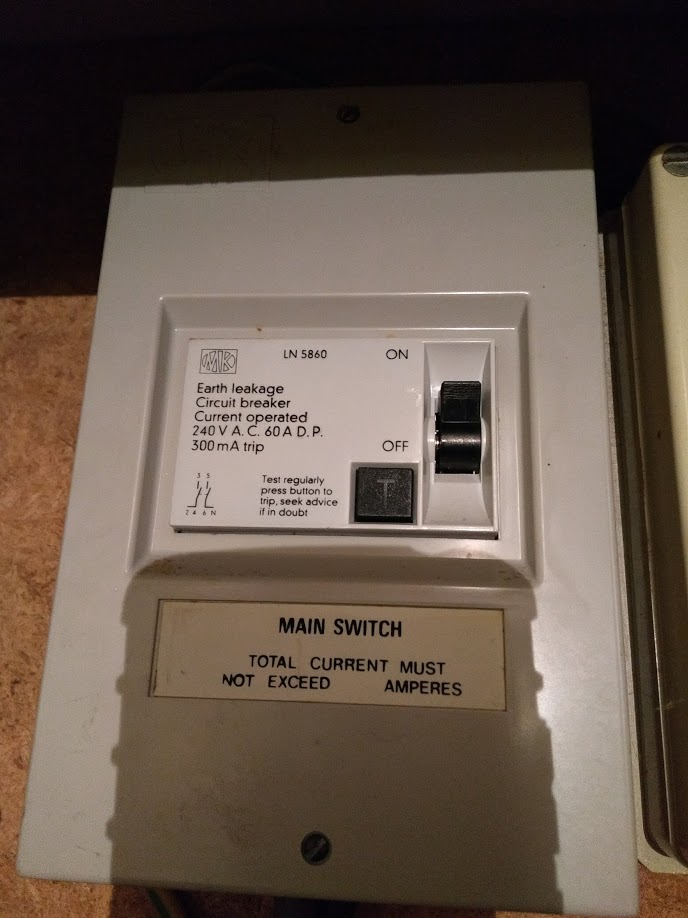

I still don't get how you are convinced it is a 300mA RCD...
This one is 30mA
Could be this one, though. 80A 30mA:
Could be a 6180, though. 80A, 100mA.

Well, so you can all sleep tonight without worrying about how many mA it is ...
here ... is .... a .....
photo!
