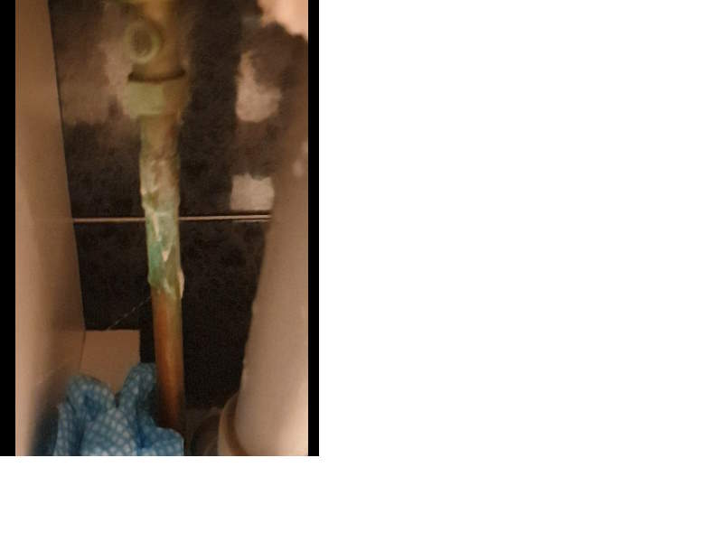

Just found the bathroom floor wet, and there seems to be a pinhole leak in one of the risers to the handbasin.

You can just see the little spray at the bottom of the corroded section of the pipe. Thing is, all the hot taps have run dry now, but it's still spraying out. But if I turn this hot tap on, nothign comes out... I'm lost
Turn the water mains off and open all the taps, up and downstairs.
Once drained down, go to bed and call a plumber out in the morning, do not mention on the phone that it is an emergency!

Yeah... thanks, I'd already turned them off, but the tiny spray just kept coming... soaking the place out of all proportion to its size. It has now finally stopped - I guess it must just have been the head above it, up to the tap.

Wonder what caused the little pinhole...
Perfect example of what can happen when it looks like a lazy worker hasn't clean the flux off the pipe after soldering.
Anyone seeing green residue on their pipes should get it scrubbed clean with a green scourer
Aye trouble is, people like me don't know that (I do now :rolleyes:) - I imagine those pipes have been like that since the house was built in 1994, so you kind of assume things are all OK :sleep:

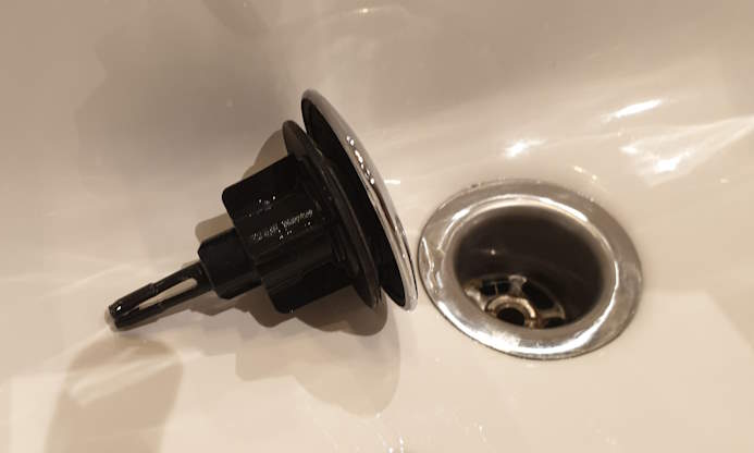

However, rubber seal is starting go around the drain "plug" (which requires two grown men to open and close), so I think it's time for a new drain unit. But what kind? When I replaced taps and drain in the en-suite, I went for a different kind:
This is a "McAlpine centre-pin basin waste".
But the trouble is, this one has started leaking - ie, when you push the plunger down, it clicks and seems to locate OK, but the water drains slowly out (down the drain this time, not between the drain and sink).
Everything has been examined with a magnifying glass - no cuts in the rubber etc - and cleaned thoroughly.
Is it me? If so, what the **** am I doing wrong all the time? As I say, I'm hardly a plumber, but can happily take cars and computers apart, so am careful and methodical - and this basic stuff isn't exactly rocket science :(
Any suggestions for a new drain? Standard sized wash hand basin...
Thanks :confused:
Get one of these.
You can remove the whole mechanism for cleaning.
And, when the spring in the brass actuator does eventually seize up, you can replace just that bit.
Oh, and use plumbers mait not the useless rubber washers that come with it... Maybe use the lower one but not the top one.

Thanks - I seem to remember you helping me with the old one, years ago :giggle: no matter what you suggested, I tried it (Plumber's Mait etc), but it still wouldn't seal, so I used silicon. So I'm interested to read on the Victorian Plumbing web link you sent me "When installing we recommend running a thin bead of silicone sealant around the recess of the sink waste hole"!
Maybe it wasn't just me after all :mrgreen:
