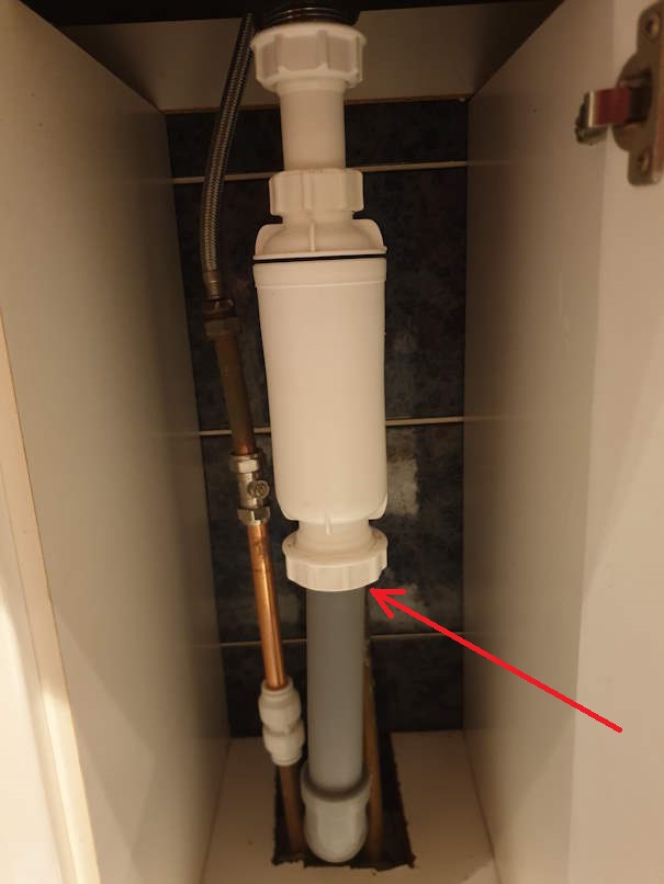

...and indeed I have slight seepage where indicated. I know it's not straight - never has been, since before my time (possibly since 1994, when the house was built), but the bottom grey pipe is fixed in place, as far as I can tell. I don't like to try and force anything, as I have a tendency to break things :notworthy:
The bottle trap clamps onto the grey outlet pipe via the nut which tightens a tapered rubber ring.
I don't know if you can buy the rings, or if I should maybe get a new trap, and hope it'll seal better... the seepage is very small, and only happens if I run the taps for a while, but still...
Your pipe is not straight so the seals wont ever sit properly.
You need to cut the down pipe and swan neck back in properly so that everything is aligned.
Don't, for the love of God, use any silicone.
Don't use anything.
It is self sealing.
(Push the swan necks to the back to keep your cupboard space).

Thing is, it was OK like that for 30 years till I disturbed it, so maybe it just needs a new rubber seal - I'll have a rummage in Pandora's Box later and see if I have one.
Don't know what a "swan neck" is, sorry :notworthy:
No, I wouldn't use silicone on this bit :mrgreen:
Swan neck just allows you to connect offset piping.
You could just use a flex i think.
