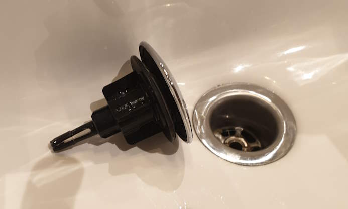

The mechanism which pops the plug up, is usually adjustable - perhaps that is resting too high, preventing the plug sealing.
Ah, sadly my McAlpine unit, from the cheap'n'nasty collection, doesn't have that facility. Unless you tell me different, but it just looks like a one-piece plastic moulding...

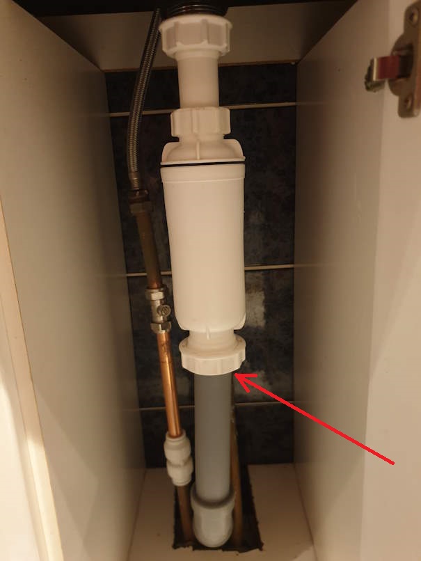

...and indeed I have slight seepage where indicated. I know it's not straight - never has been, since before my time (possibly since 1994, when the house was built), but the bottom grey pipe is fixed in place, as far as I can tell. I don't like to try and force anything, as I have a tendency to break things :notworthy:
The bottle trap clamps onto the grey outlet pipe via the nut which tightens a tapered rubber ring.
I don't know if you can buy the rings, or if I should maybe get a new trap, and hope it'll seal better... the seepage is very small, and only happens if I run the taps for a while, but still...
That's either a waterless trap (HEPVo clone) or a straight through trap, probably the former. Unfortunately it looks like a cheaper copy and it'll be the bottom seal that's leaking. Most times, stripping it down and cleaning the seals then a little silicone grease to refit usually sorts it. Either that or replace the trap with a good quality McAlpine or true HEPvO trap.
The grey pipe/fittings are push fit but try to to disturb it, in fact don't even look at it the wrong way, as that will undoubtedly leak too if you do.
OK Rab, will do. It's only a sight seep so hopefully that'll work :giggle:
I'm generally a pretty handy guy, but if there's one thing I've learned in all my years, it is that if I look sideways at ANYTHING concerning plumbing, there will be a flood. It's my Achilles' Heel.
