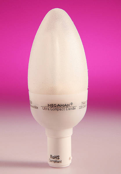

So can you tell me Steve where I can get 13w CLEAR low energy screw in candlebulbs ? In the Co-op ?? I live in a house, not a public building......

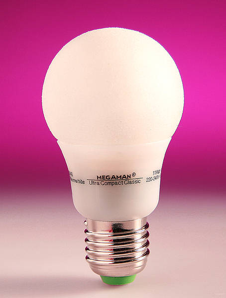

You cannot get clear CFLs, simply because the coating on the tube gives them the light emitting qualities. A clear fluoescent tube emits only UV light. The coating on the tube converts it to white light. There is no filament.
click the images for an online retailer.
