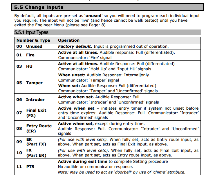

"I want to be able to arm all of downstairs, and use/sleep upstairs at night" they call this Night Set-
PIR 1 Entrance Hall - Zones AB input type - Entry Route ??????
PIR 2 Lounge - ZONES AB Input Type - Intruder
Door Contact (Front Door Entrance) Input Type - Final Exit - Zones AB

What am i doing wrong. what is the correct input type for PIR 1 ???
ive tried 09 & 10 but don't quite understand what they mean ? in the context of Night Set

It needs to be 09 ER Part entry exit , this will start your entry exit timer in part set

Am expecting to trigger a timer for 30 seconds once Ive activated the pir in the hall pir 1. Input type 09
Either you didn't program it correct or you didn't part set it , I've programmed loads of these and euro mini panels ( same programming ) does the lounge detector look into the hallway ?

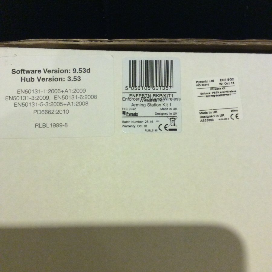

Marka here are the results
Still cannot disarm the alarm when coming down stairs during the grace period. Can only disarm from the keypad once the alarm is sounding. You will agree this is not a viable option.
Strangely
Programming a wireless keyfob allows me to arm and disarm during grace.
Programming a proxy tag again allows me to arm and disarm during grace.
I strongly think this is a software issue. I will get back onto the supplier and pyronix. The combination of enforcer and wireless keypad /arming station is new.
What do you think ?
