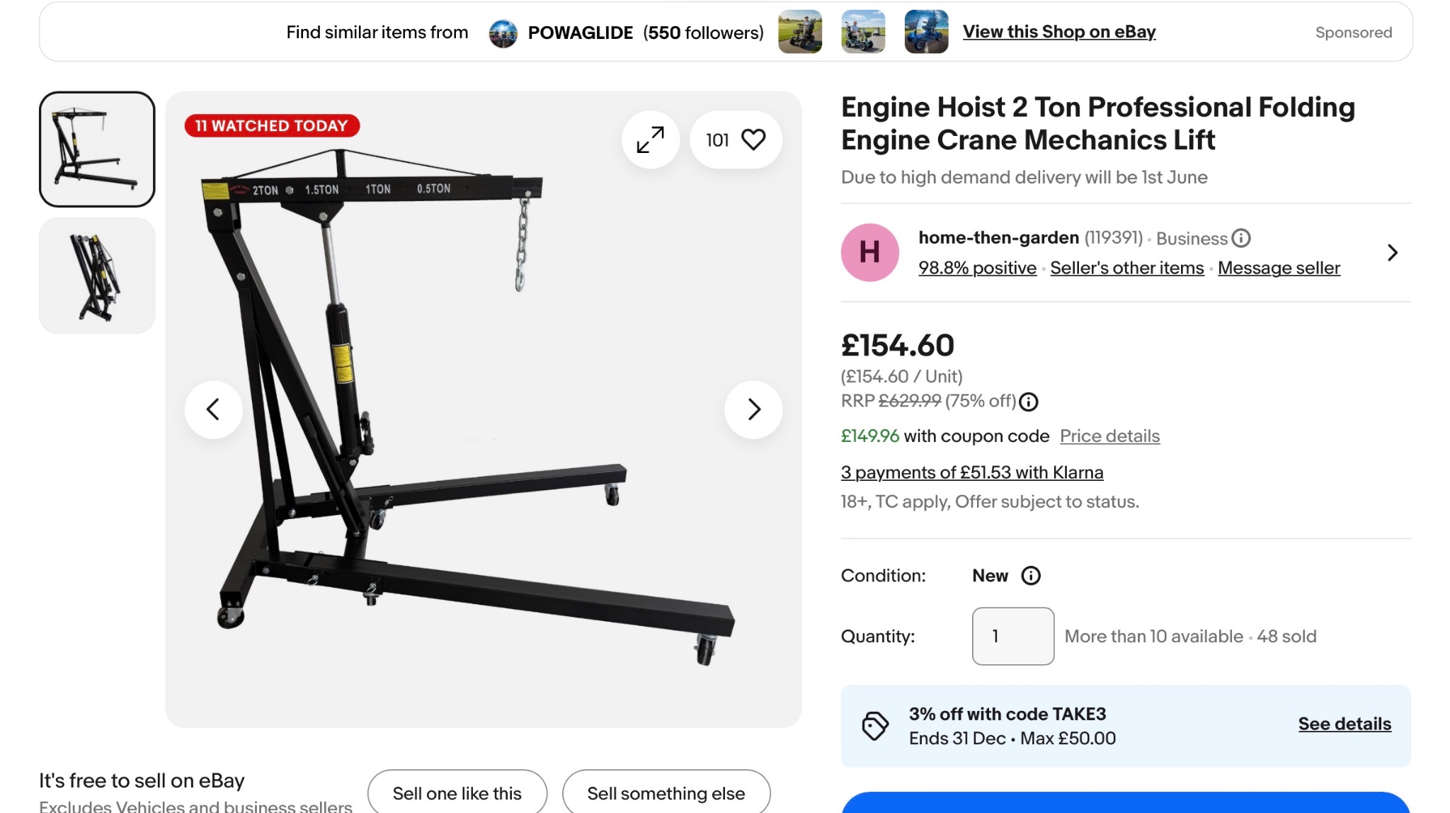

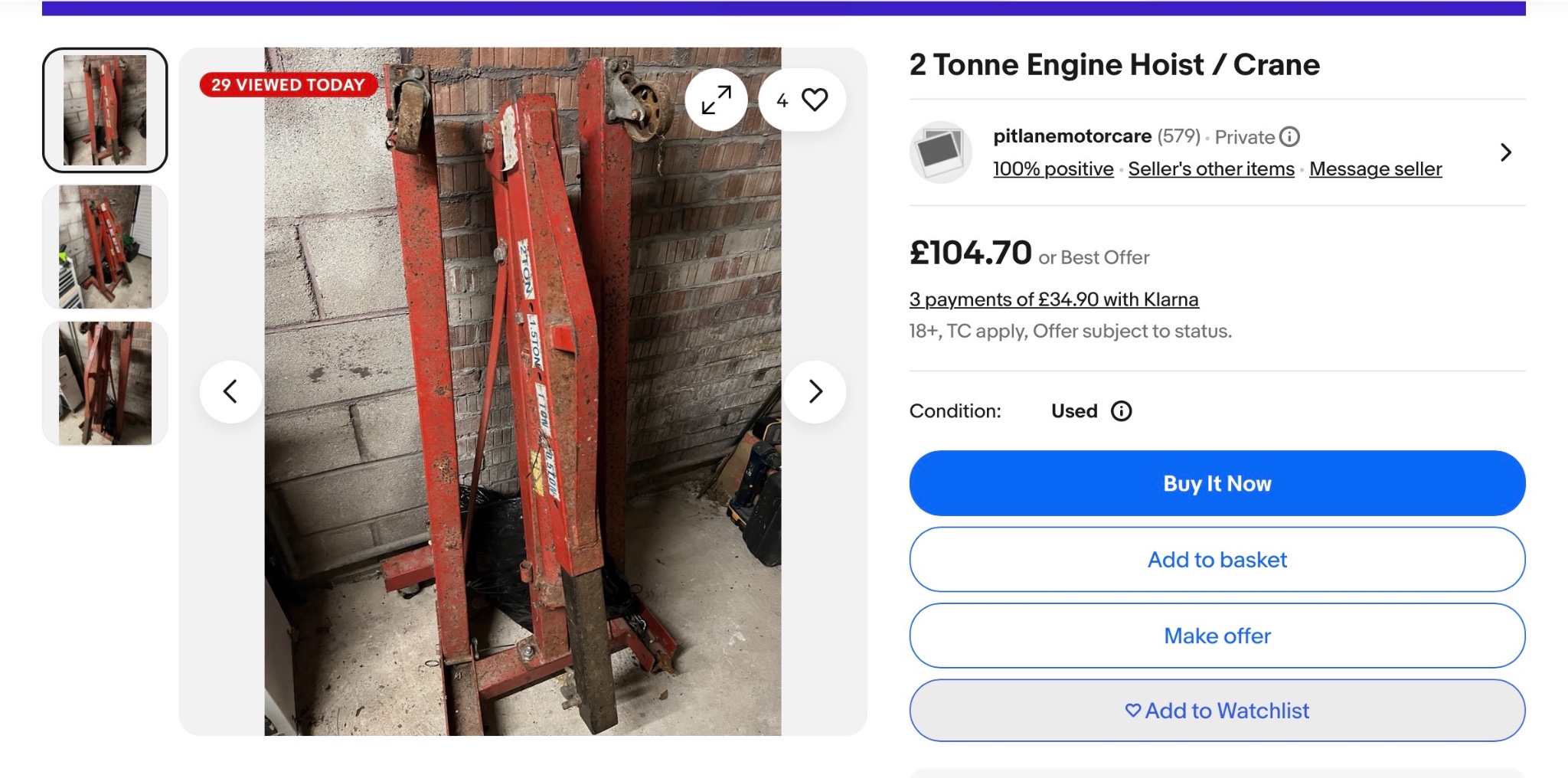

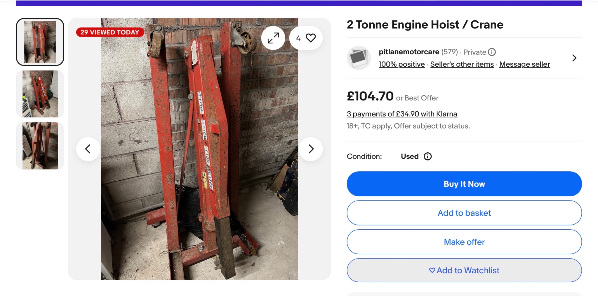

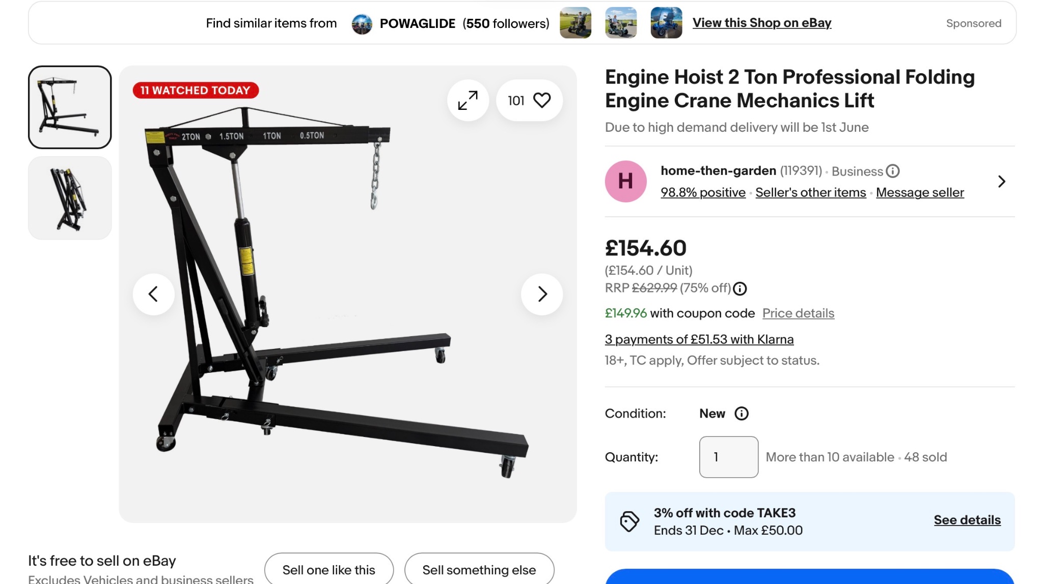

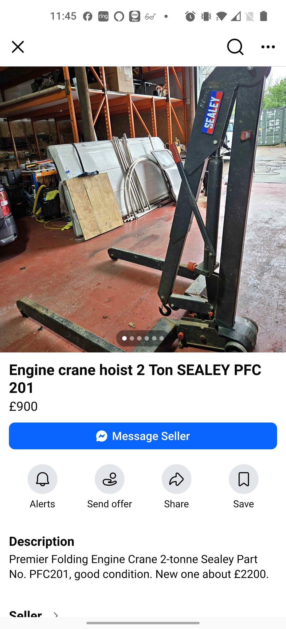

Are you planning to actually use it to fit engines? If so, the trouble with a static hoist is that you have to move the vehicle back and forth etc. As above, a moveable folding engine hoist is a much better option.
