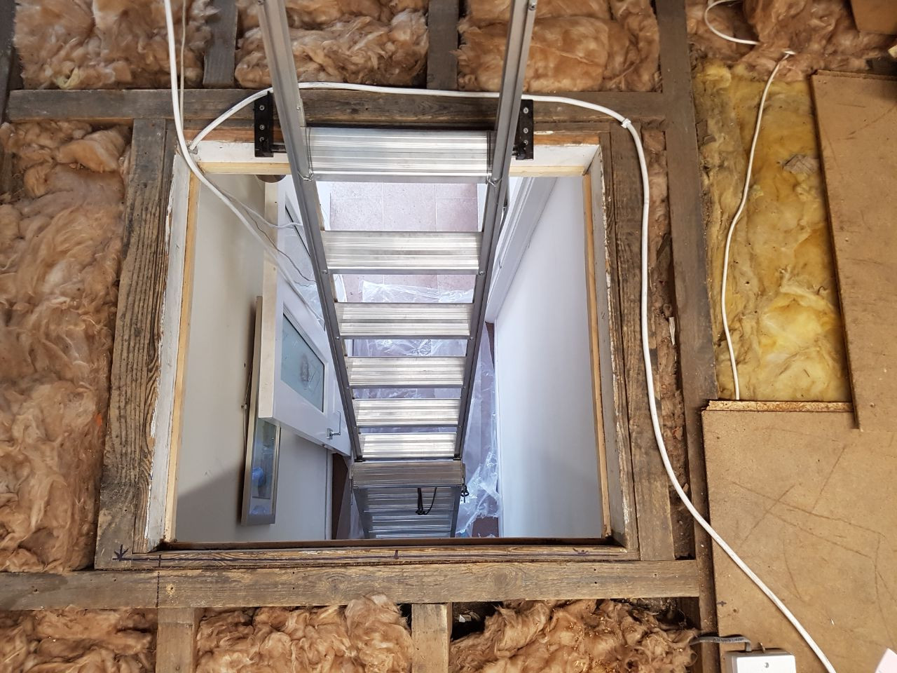

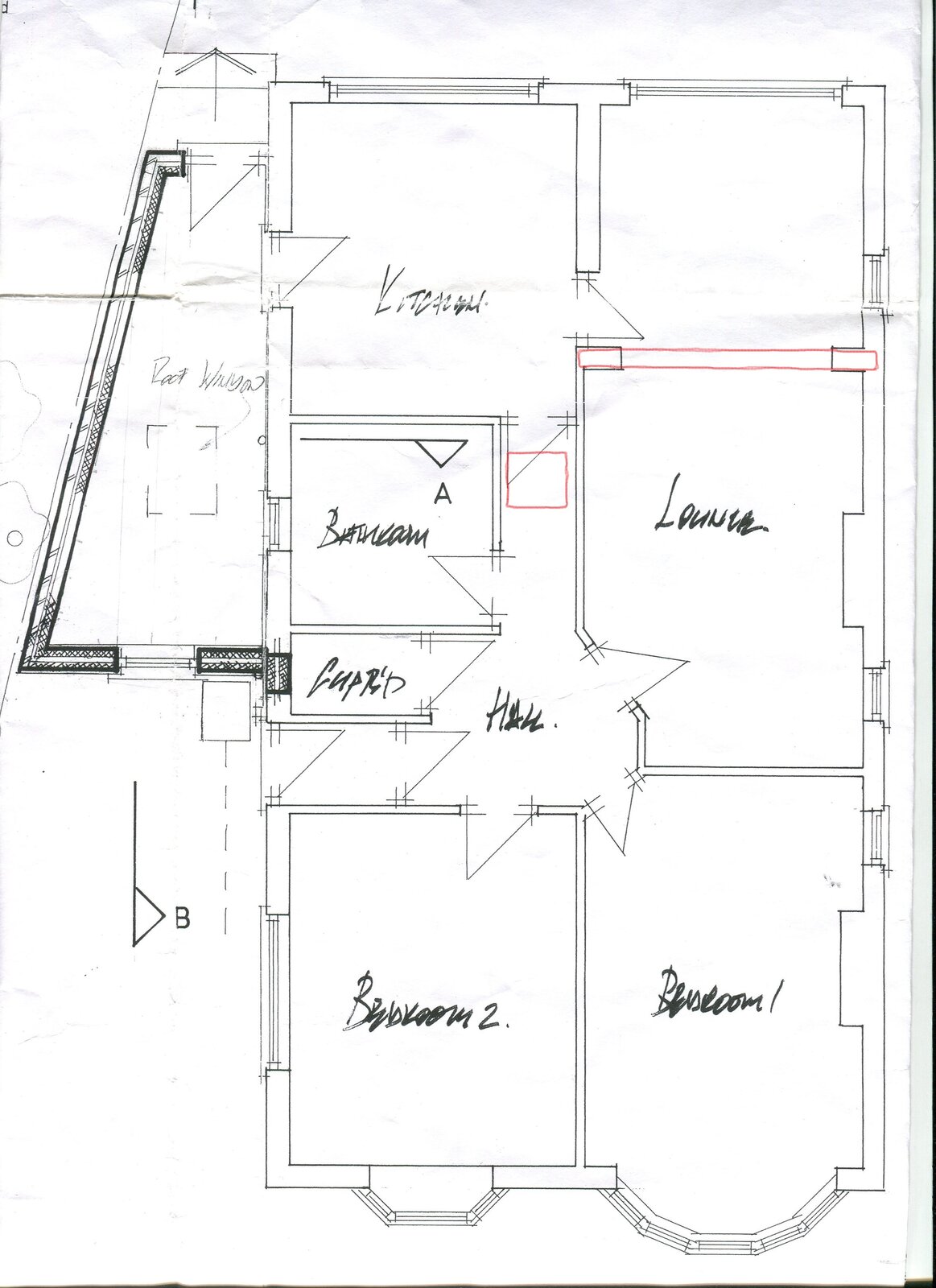

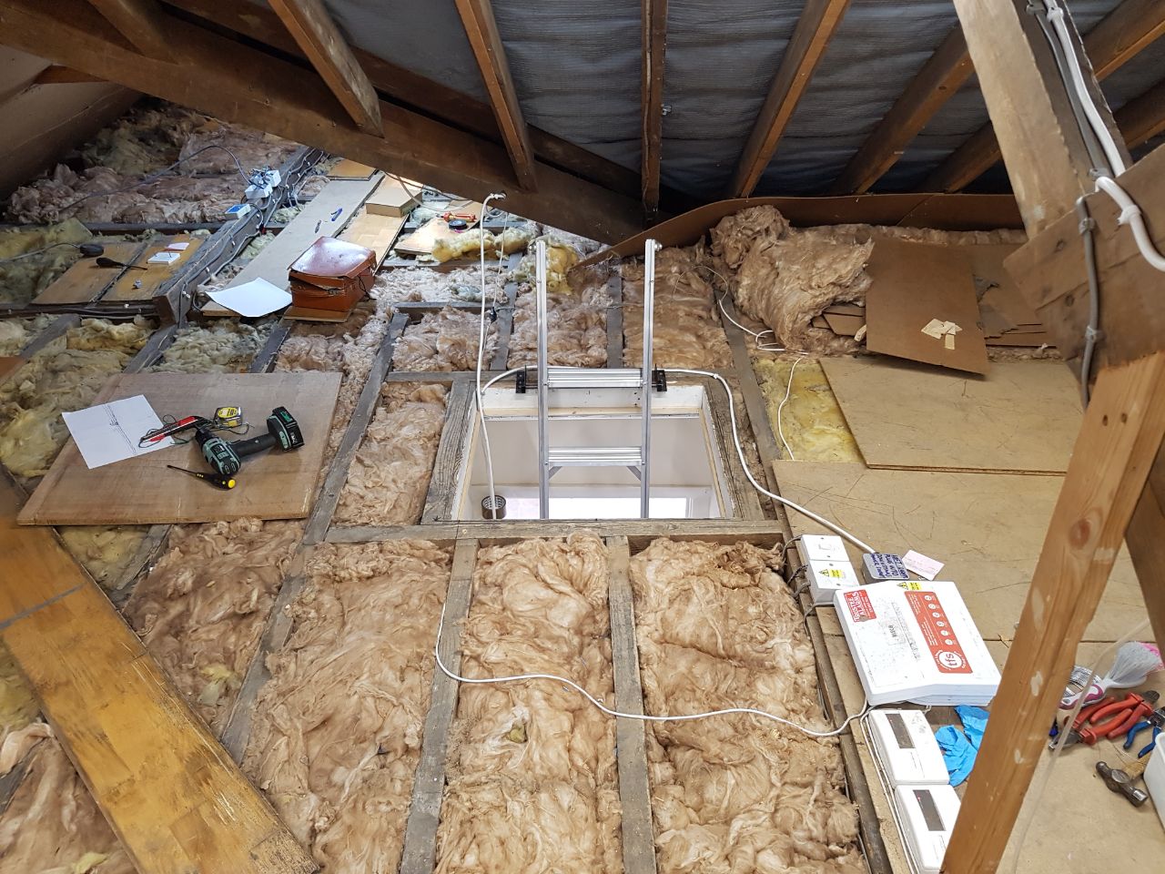

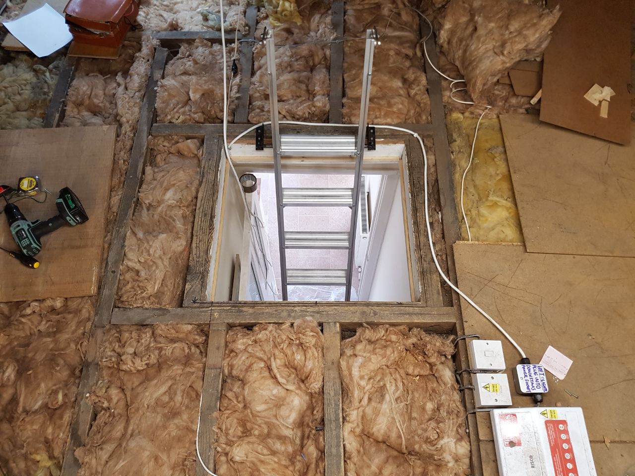

I've got a loft hatch in a hallway that needs to be made bigger. This is a bungalow whose main pitched roof is of Purlin type, with 4 x 2 joists running at ° to rafters.

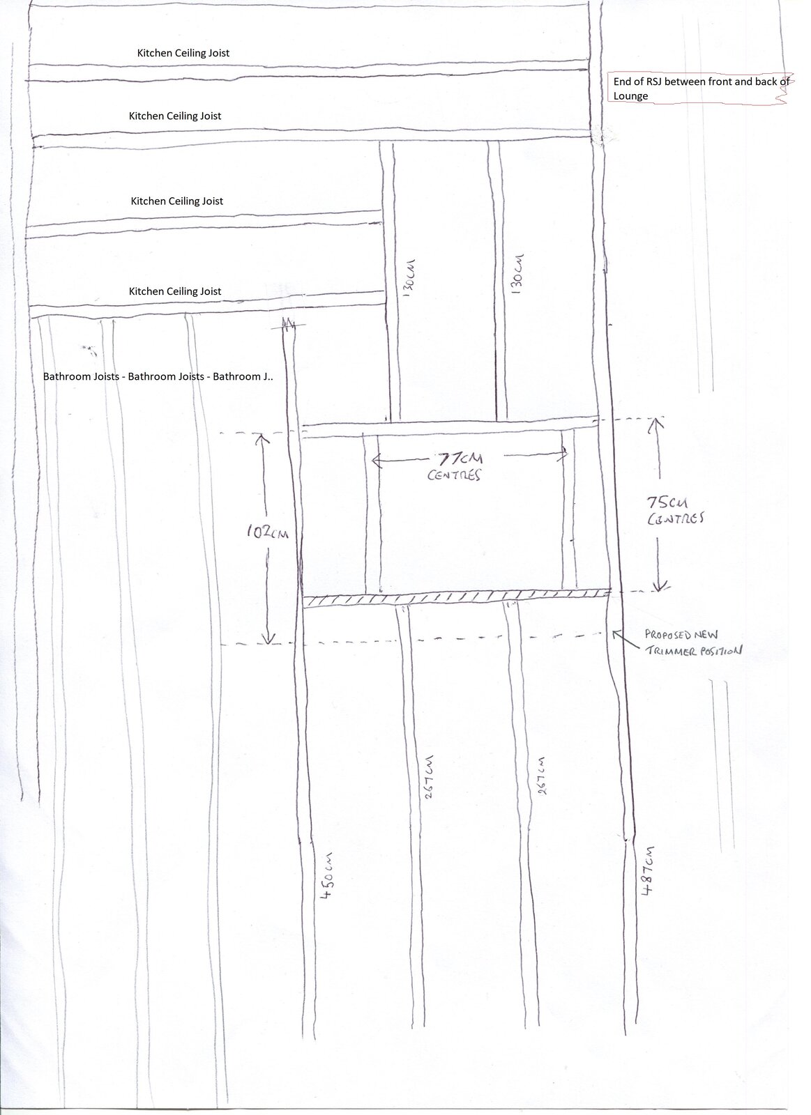

The plan is to change the position of one of the trimmers - hatch door hinge side - then make a bigger door and reinstate the existing design only 1/4 larger in one direction (more rectangular).
I know it may be a "how long is a piece of string" question without knowing where all the load bearing walls are etc, but just wondering if you think a small mod like this would only have a negligible effect... or not.

- All timbers in hatch drawing are 4 x 2
- I've included lengths of some the surrounding joists/timbers as it may help clarity

"Loft Hatch - RSJ" shows the location, in red, of the hatch in the building and an RSJ (therefore well supported from a loft load perspective)
"Loft Hatch Frame" shows existing loft hatch Joists/timbers (without hatch liners etc). The shaded trimmer is the one I intend to reposition so it will be moved to 102cm from the trimmer opposite.
Pics 1 to 3 are various photos of hatch itself. FYI, The ladder is temporarily mounted on the wrong side just for access.

Doing what you propose should be no problem with that existing arrangement. Don't dwell too much on compression and tension or whatever, none of that is relevant.
You're better off screwing brackets and hangers etc, not nailing.

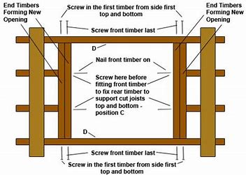

As woody said use hangers and screw it … you won’t have any issue making it bigger but I would double brace the headers
Hi Jake, thanks.
When you say double up the headers, I take it that's what I've called the trimmers (one of which is Horizontal in my sketch and shaded). Maybe terminology depends on the application. Apologies, this isn't my field.
If so, are you saying double brace, i.e. double up each "trimmer" 4 x 2, so have an additional 4 x 2 beside and fixed to the existing top "trimmer", then do the same for the bottom one? So, total 4 timbers, two at the top and two at the bottom?
Alternatively, is it the vertical timbers I've measured at 77cm centres in my sketch and double those up (although I think you mean the former)?
Hope.this.helps., Yes trimmers., Not sure why I call them.headers ...always have lol .

Ah, gotcha. Brilliant, thanks for digging up that graphic, I'm crystal now. Good one Jake.
