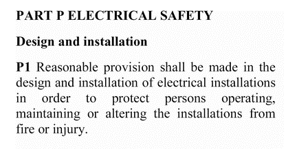

There is no such thing as a "Part P" qualification.
What LABC want is an electrician who is registered with one of the Competent Person Schemes and who is able to certify electrical works done by somebody else.
There are not many who will do that. I believe that some members (not many) of Stroma and NAPIT are registered as third party sign off people.
Have a look on their websites for a local one.

As for them requiring all of those non existent items, you may want to draw their attention to what Part P actually states:
That is all.
The EICR will confirm of the installation is safe to use or not.
The law also requires that you notify building control of certain types of work - which you have already done.
There is really nothing else you can or should do.
