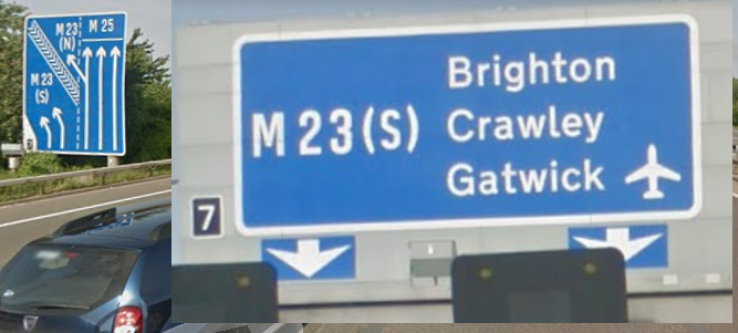

Mmmm Seem we haven't sorted it on our roads either...
The down pointing arrows indicate the lane(s) to be in; not the direction of travel to follow like the other sign.

When above a door, an 'up' arrow (i.e. pointing away from the door) is perhaps the one which (if noticed and thought about) might result in the most confusion. People do seem to generally understand that an 'up arrow' on a road sign means 'forward', but the irony (confusing) there is that, with road signs, people seem to understand that a 'down arrow' refers to travel in the opposite direction to which one is facing (i.e. 'backwards'), whereas the 'down arrow' above a door is being used to refer to moving 'forwards'.
Indeed - but, as I've just observed in another post, on a road signs a downward pointing arrow relating to direction of travel refers to travelling 'backwards' (away from the sign), not 'forwards' (towards the sign and through the door) as the downward pointing arrow above an escape door is being used (by a 5:3 majority of people here!) to indicate.
