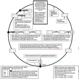

There is a limit to the length of cable used in a ring final. Starting from scratch easy enough, allowed 106 meter so if used less than a role OK, but to extend existing job one is to work out how much cable has already been used.
The diagram in the book shows what is allowed. However my meter measures in 0.1Ω increments, and really needs to be on 0.01Ω increments, but unless right on the edge then my meter will do. Better than having no meter.
