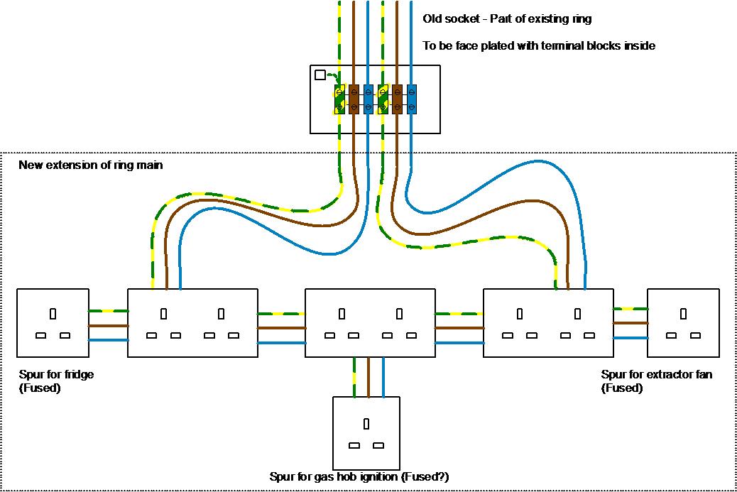

Hi Folks,
First post so be gentle.
I'm trying to plan out my new kitchen and think I am going to need some new electrics.
Just wanting to know if this is possible before I go any further into planning where stuff goes.
As the image shows, I would like to have the ring main extended by using an unused double socket. 32A terminal blocks inside the socket box wieth a fac plate on the front to cover it all off.
Why spur off the new wiring?
Put the whole lot on the ring final.
