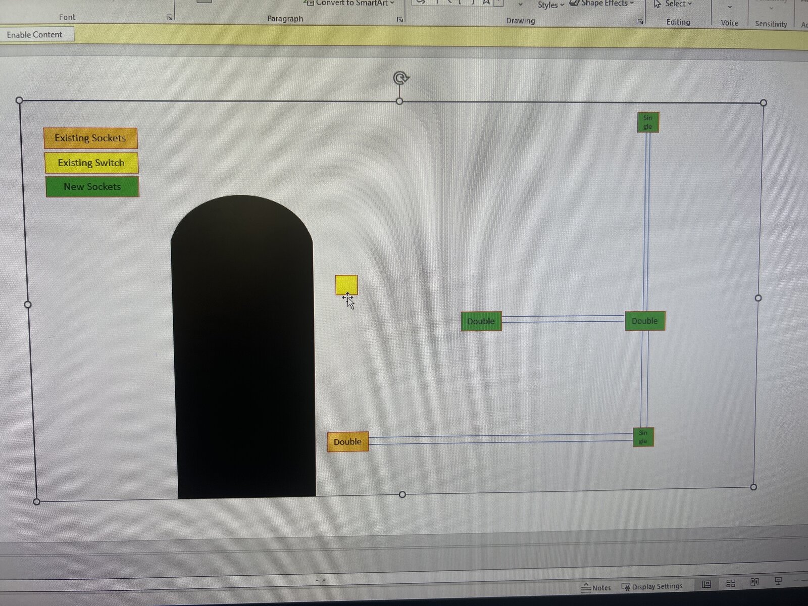

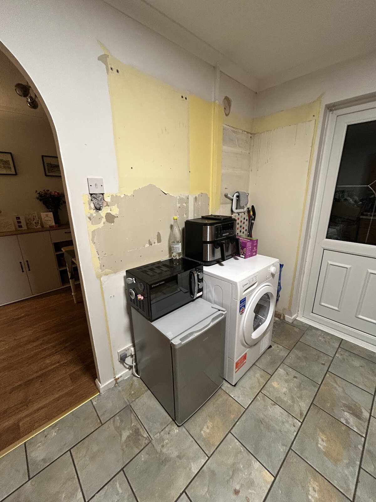

Stripped out my kitchen and looking to extend the ring main as the kitchen has next to no sockets to use.
I have one existing socket on this wall and I’m looking to extend the ring to add two single sockets and two double sockets. See photo attached. The circuit is 32amp.
Just want some confirmation that this would work and that I can extend the ring in two directions from a socket. Or is it better to extend the ring in one direction and just spur in the other?
Cheers

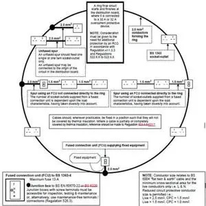

Do you understand what a ring final is?
the whole idea is it goes in a ring, and all sockets can be fed from either leg, so the load is shared.

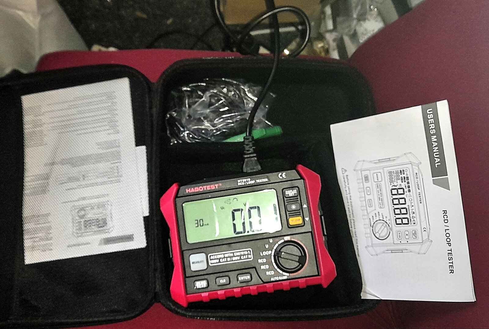

The problem I find with a ring final is the maximum permitted loop impedance is 1.38Ω and most of the cheap testers pass at 1.9Ω, so the first point is to rake out the installation certificate or electrical installation condition report, and see how close to the limit, is there room to expand.
There are two limits, one is to ensure, if there is a short circuit, it will trip in the required time, and second should there be a leak to earth again it will trip within the required time.
You can of course ignore the regulations, and the chance of you having a problem is likely slim, but you have asked, so not to tell you that you should test would be wrong, however I would think most people don't worry. The tester Loop-test-socket_tonemapped.jpg seen here, even the cheapest will likely cost around £75, and not much cheaper to hire for a week.

yes only one socket on this particular wall in the kitchen but there is more than one socket on the ring main I’m assuming. Yes it’s got a RCCB. See photo of fuse board. Kitchen comes under ground floor sockets.
I definitely want to extend the ring, but my question is can I extend the ring from a socket in two directions. I’m guessing it doesn’t matter as it is going to loop back regardless??
I’m more than confident installing all of this, just want to clarify details prior to getting started.
Cutting the original ring cable and adding your new sockets from there will be a better idea by using a junction box.
You could add a loop of new 2.5mm cable from the socket but the cable will need to supply the new sockets and then join back where it originates.

Why does have to insert 4 wires in each terminal at the back of the socket??
Why can't he join a new cable with an old cable in connector blocks or wagos
and
join remaining new cable and remaining old cable to the terminals on the back of the socket?
