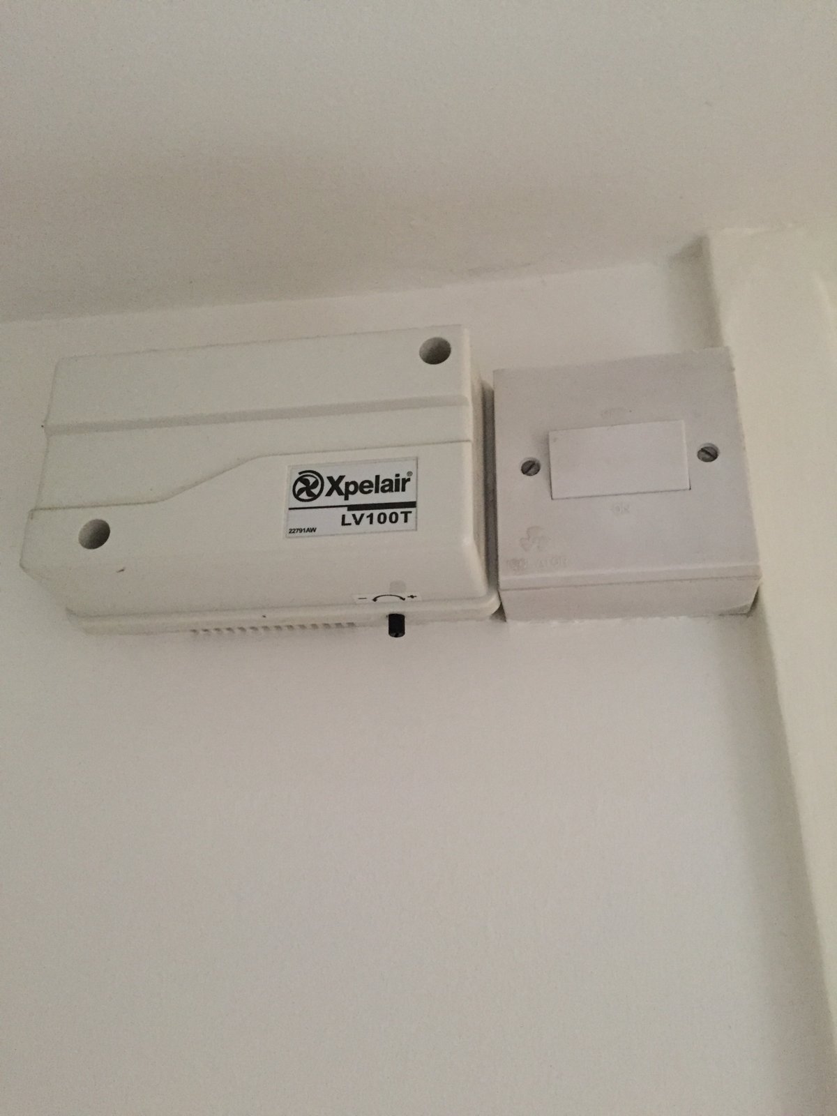

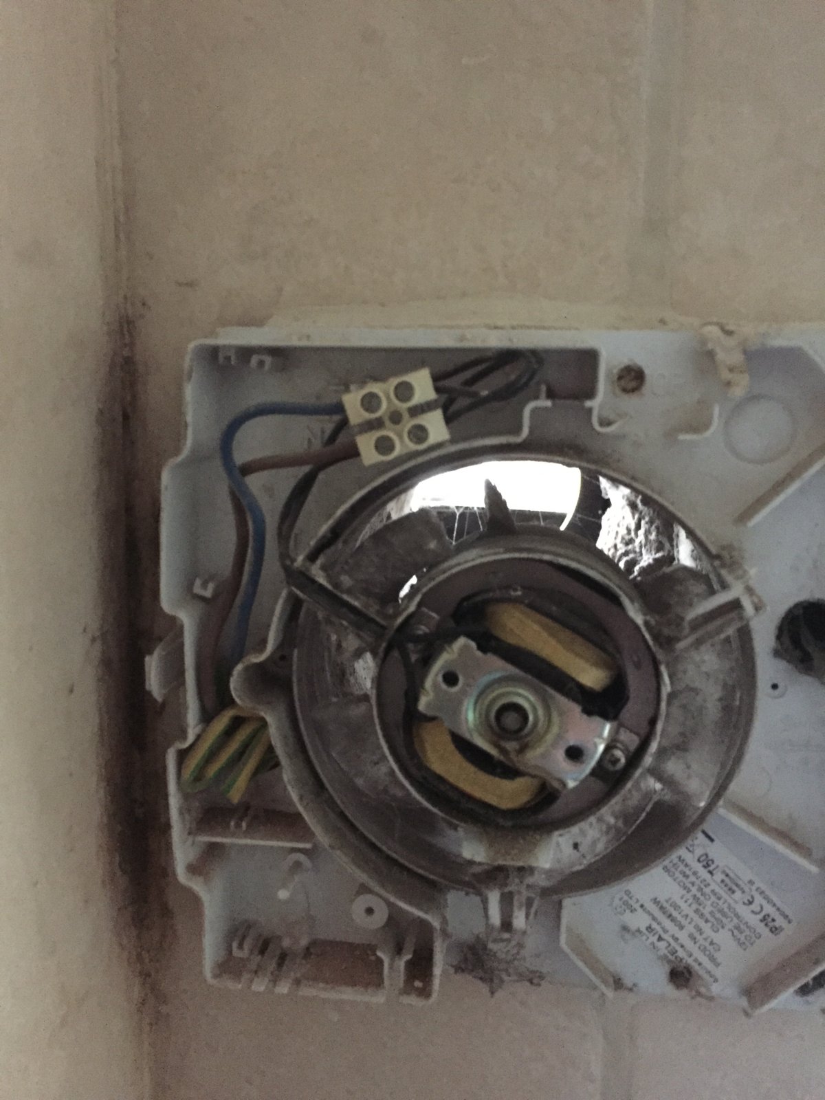

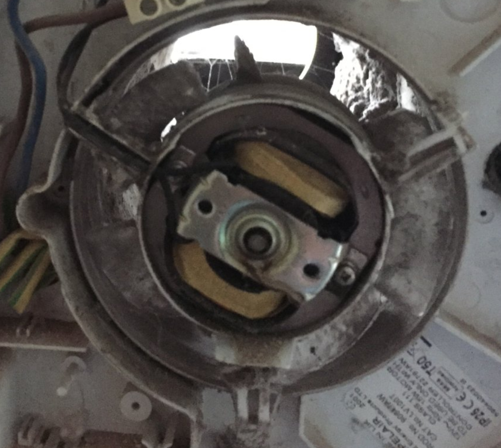

Replacing the old fan which dues not have an integrated timer and looked like the first picture .
The timer actually sits in the hallway and looks like the second picture.

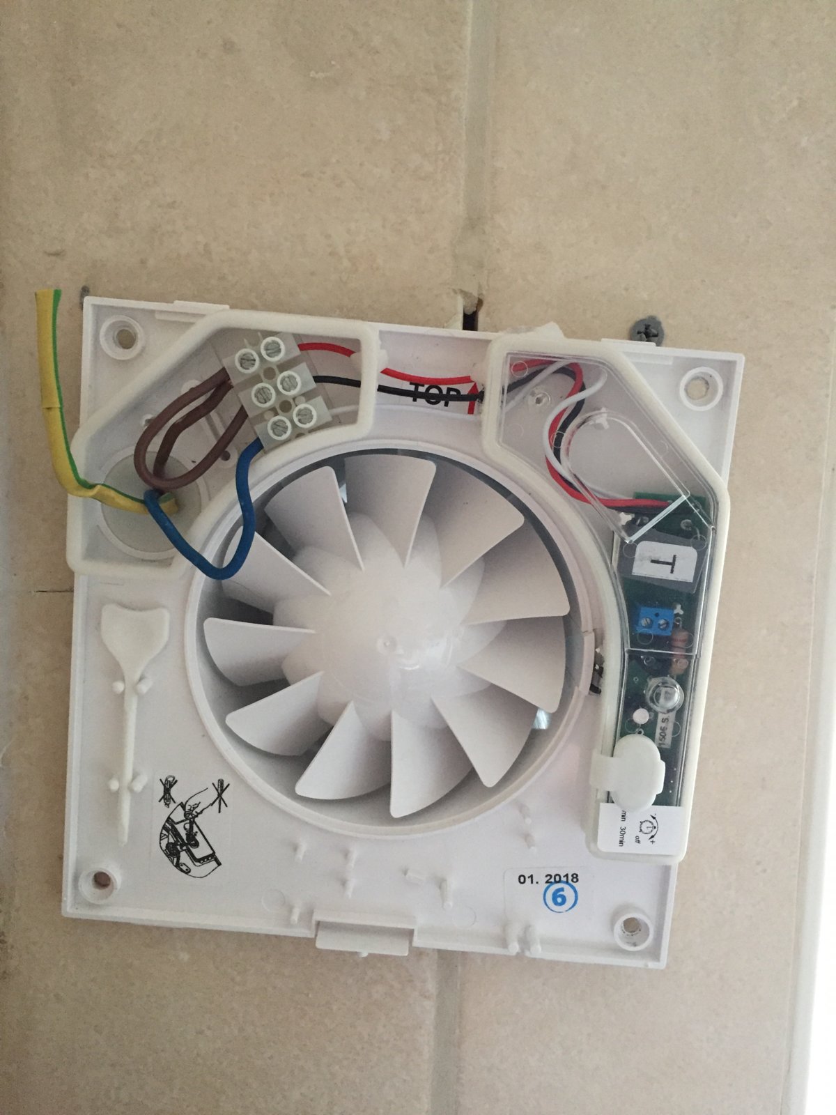

I tried to install the new extractor which has an integrated timer but I don't have a switch live wire (I think, could be permanent live?) and after looking online for some time I tried to loop the switch live with the permanent live (third picture with brown wire loop). Still not working.... Any idea how to go about this please?

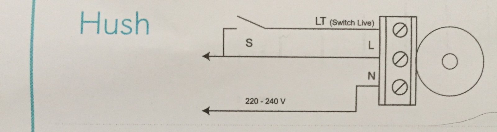

Also enclosed the instruction wiring.
If anyone has any clue please help! I have wasted so much time on this and really want to avoid rewiring...

If the old fan had a timed overrun feature then there has to be both switched live and permanent live going to the transformer in the hall.
I can't help thinking you're trying to power a 230V fan with 12V.
If you are, I don't think electrical work is for you.
Then you need to get another 12V fan, not a 230V one, otherwise you will have no choice but to change the wiring. Your old fan has 2 conductors running to it from the transformer, your new one needs 3 from the isolator.
I can't help thinking you're trying to power a 230V fan with 12V1
As BAS has hinted. Your old fan is a 12volt one. That white box next to the isolator switch is the 12v power supply and will include the timer function.
You have the wrong fan.
Return it and buy a new 12v fan and power supply. You don’t need to rewire anything.

surely it would be cheaper and easier to fit a simple 12v fan, and use the existing power/timer box, which has some cost to it. I'm assuming the old fan is just clogged with dirt and has noisy bearings. I'd wash it in hot water and oil the bearings after drying if it was mine. Of course all traces of water must be gone before it goes near electricity.
