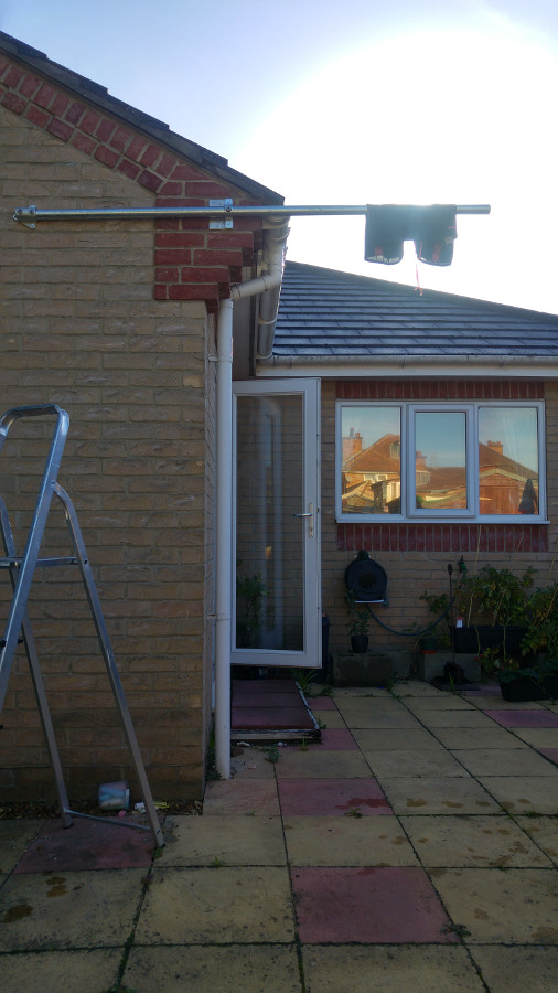

Hi,
Ended up with pull-up bar, which you can see on the picture. It is certainly multipurpose also serving function suggested by Brigadier.
As for pull-ups function.
It has flex in line with calcs by deflection calculator.
You can see on the picture the bar is not level though, raises 15mm per meter towards the loose end.
But becomes more or less level with my weight handing in the middle of the sticking-out area.
So far no sign of weakness.
If anyone interested to replicate:
- 2m 42.4mm OD interclamp galvanised mild steel tube (afterthought - black powder could have been better for thermal and drying)
- 1 interclamp bracket no 146
- 1 interclamp bracket no 198
- 2 plastic caps for the tube no 133
- couple of 6mm allumminium plates between wall and bracket (this is just to achieve clearance between tube and guttering)
- 4 of 10mm x 61 mm universal nylon plugs (Duratool)
- 4 of coach screws 8mm x 70mm
Cheers,
Maciej

If your still looking for ideas... get a local welder to pop a bit of thick flat steel strip inside (tight fit) and run a few welds as far as possible up the tube. Postioned vertical this additional "web" would reduce deflection to almost zero... thicker the better...
Right, so I was actually thinking to create a sort of "web".
Deflection calcs show that solid pipe would have significantly less flex (was it quarter ? cannot remember), so a tube with flat strip vertical would be not far off from it.
Does it need to be welded?
Can I stick the matching flat strip - in theory it should not move right, or if it was to rotate I could prop it with smaller pipes on the sides to keep position.
Sort of this would be inside the pipe.
o|o
Beauty of my installation is that I can take the pipe off or replace it with
Ideally yes it should be welded at each end but. ... if you can get a strip (nice and thick ) and a little bigger than the inernal diameter and carefully grind it down with rounded edge to suit the internal diameter then drive it home with a sledge hammer that would work I'm sure.
