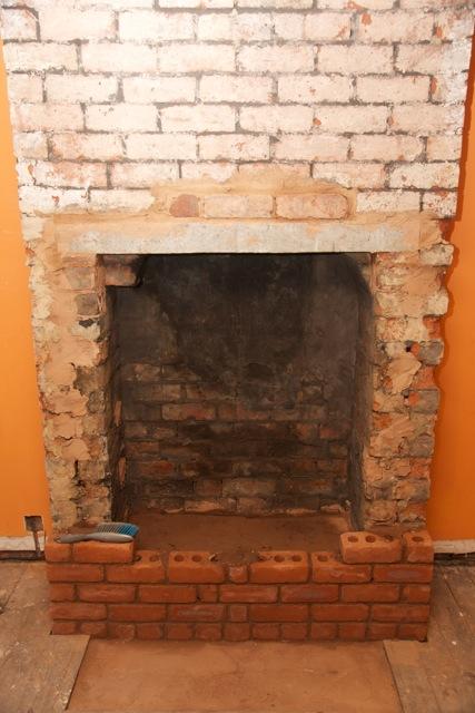

Hi, just wonder if someone can help..
I would like to instal inset wood burner in to chimney breast hole.
try to achieved something like this:

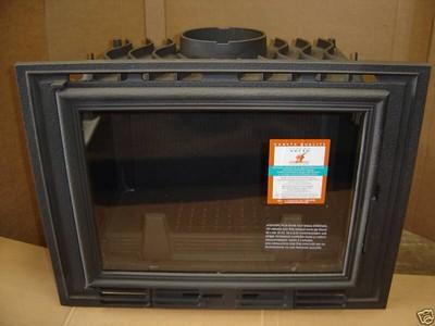

and this is the inset wood burner which I plan to fit:
From seller info:
Front of fire: 692mm wide, 520mm high, depth(from front of stove) 380mm.
The hole in the wall needs to be: 620mm wide, 500mm high and at least 350mm deep
This gives me 20mm difference between fire and the hole (vertical) , so looks like 10mm top and 10mm bottom frame ( if I'm right), just don't know how to connect flue pipe when this goes in to the hole with no space around, how to slide flue on top of burner, how to secure, how to seal it, can I do it from inside wood burner ? Can I finish front of the chimney without having inset just leave the hole and flue pipe with reg. plate and fit it later, or fit the inset burner first then build the bricks around it. ?
How this things get installed ?

just had the chimney swept and smoke test pass so ready to order stove, any ideas how to finish this, I asked the chimney sweeper but he sad he never installed a inset wood burner and he didn't know how to connect it... so probably I just will fit and connect the stove and will build bricks over/around it..

you need a class 1 liner for the flue for a wood burner because off the tarry deposits
have you looked up part "J" :D
http://www.planningportal.gov.uk/uploads/br/BR_PDF_ADJ_2010.pdf[/QUOTE]
I read part "J" before and now again and I couldn't find part which says that you can't use a chimney channel connected to vitreous enamelled steel pipe for closed (inset) wood burner (actually this is multifuel).. can you point me which page says that, I'm getting confused ? My chimney sweeper sad that this is ok and I don't need liner and it will pass building reg. ( liner can cost about £600 with fitting so this will be a huge difference) he also mentioned that high street shops trying to sell expensive flu liner and they say you will die and kill your family with carbon monoxide etc..
Does any one know if HETAS registered can ok'it diy installation and how much can this cost ? (otherwise is £156 for building reg. tab. C up to £2000 work)
Also - I already applied for building reg. when removed load bearing wall - had inspector to check first stage (he's gonna come once more when all work will be finished) can I add inset wood burner installation to this ?
I'm a chimney sweep - I would recommend that you get a HETAS registered chimney sweep to fit it - he will know whether it requires a lining or not. If you want to do it yourself, make sure the chimney sweep you've used already did a smoke integrity test.
A Hetas installer is not supposed to certify the work of another. However if he can see everything then he might but he will assume full responsibility.
One can connect direct to chimney (no liner) IF all Building regs are complied with e.g.
1. Proper SEALED smoke test is followed and chimney does not leak smoke
2. Chimney draw is achieved to stove manufacturer's demands following install (measured with a suitable instrument)
3. Chimney can be swept properly and soot cannot collect
A fat, uninsulated or non-smooth chimney may fail the draw test and cause smoke to enter the room via the stove.
This is not an exhaustive list. There are other regs (height, termination issues etc.).
But yes it is possible.
