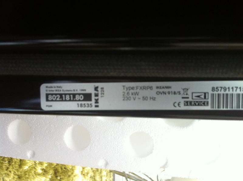

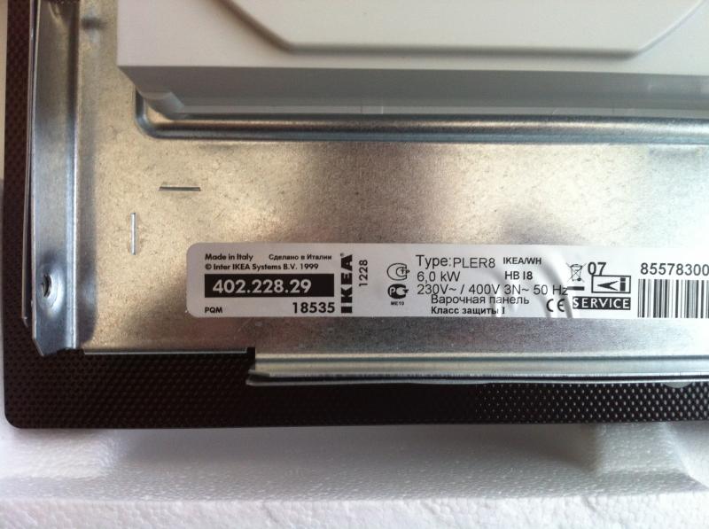

I now want to fit a induction hob rating 6kw and new oven rating at 2.6kw, both from ikea. The oven comes with cable but no plug.

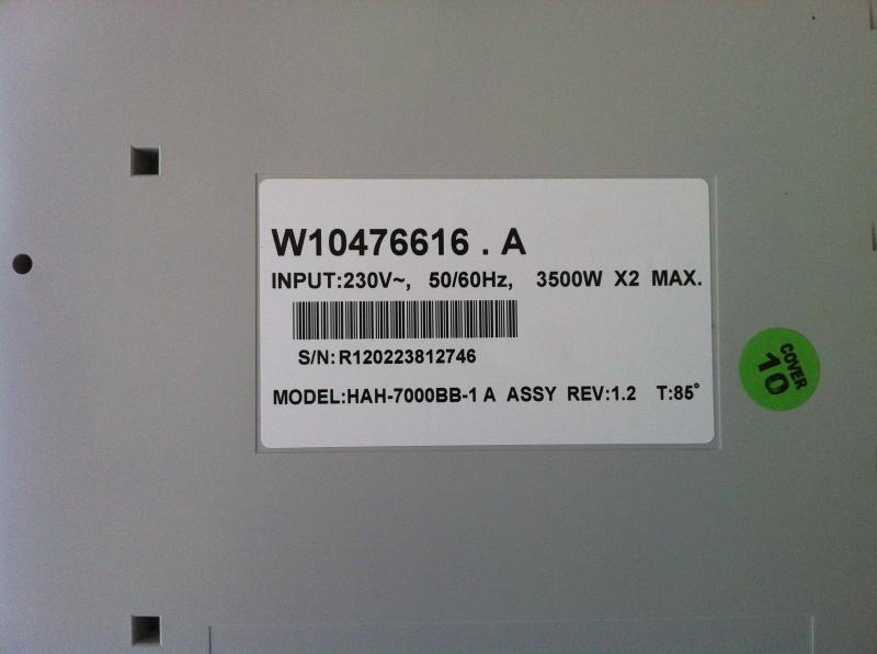

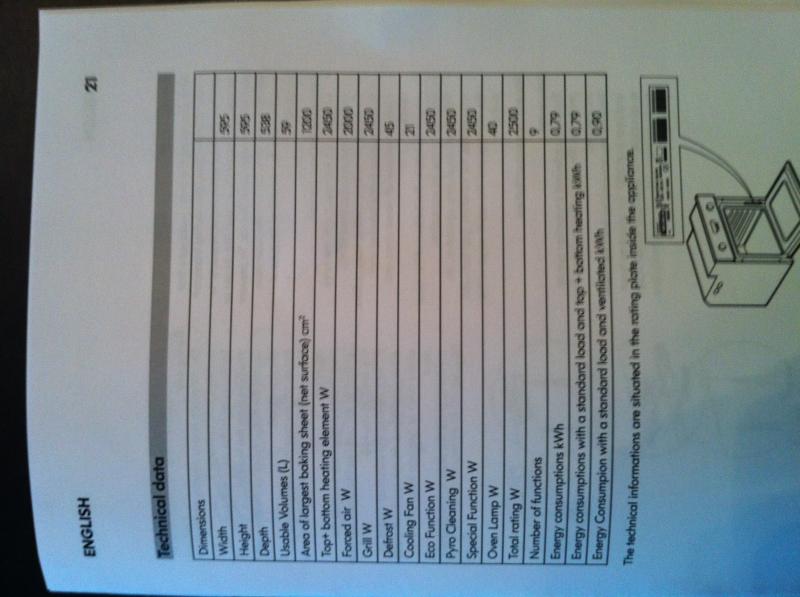

The labels are ambiguous, as one says 6kW, the other says 3.5kW x 2 (7kW) and the other (totalled up) comes to 8.2kW!
But, in any case, the worst-case scenario is 46.95A design curent.
So, including a socket outlet, 26.09A is the load with diversity taken into account.
