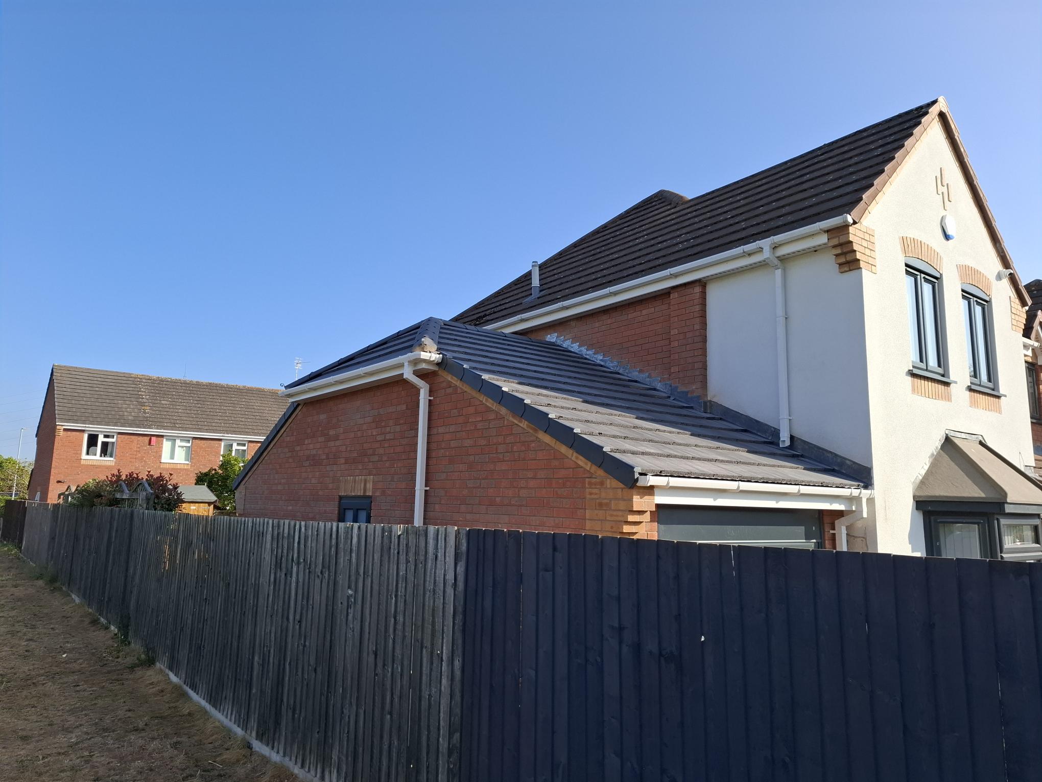

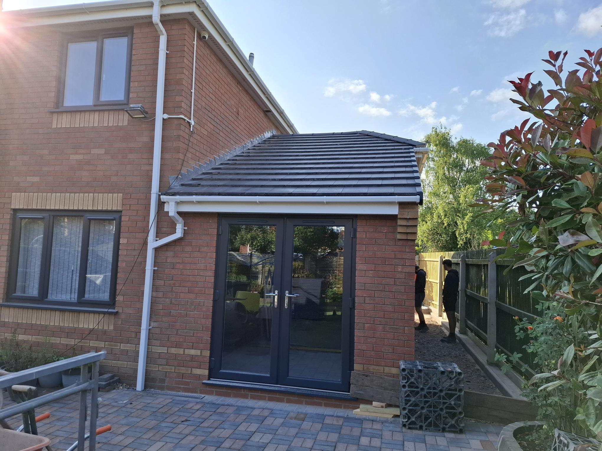

If only the ridge roll is used on the hip , and nothing else does it matter if no trays?
Thank you , really appreciate this.
No.
Hip trays are there to support the ridge tiles due to the longer diagonal incremental spans between the roof tiles. They are not used on the horizontal.
Even with dry ridge, we always compo the ends and junctions....
Good practice though more important for larger format tiles.
The lack of trays will not affect the hips performance.
I have seen hip junctions capped like yours but a lot neater..how it is secured would be my question.
