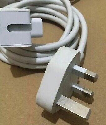

Hey guys,
I've got a plug socket behind a piece of (almost) immovable furniture, and I'd like to use plug but keep the furniture flush to the wall.
I've found these Evoline plugs online, but it seems like they're only 2 pin Euro.
Any ideas if there's a UK 3 pin equivalent?
Andy

Although convoluted, expensive and not the most practical - the slimmest plugs I have come across are GENUINE Apple Mac (non-rewirable) power leads; available on eBay for around £5:
The GENUINE cables are three core - copies are usually two core.
In addition, you would require a flex connector to cut and join your cables.
Hence the impracticality of this solution! :)

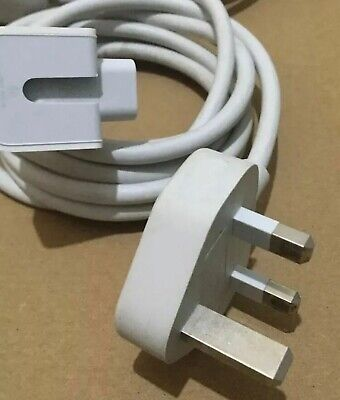

Nice one, I think this could work if nothing else is suggested . Thanks :)
